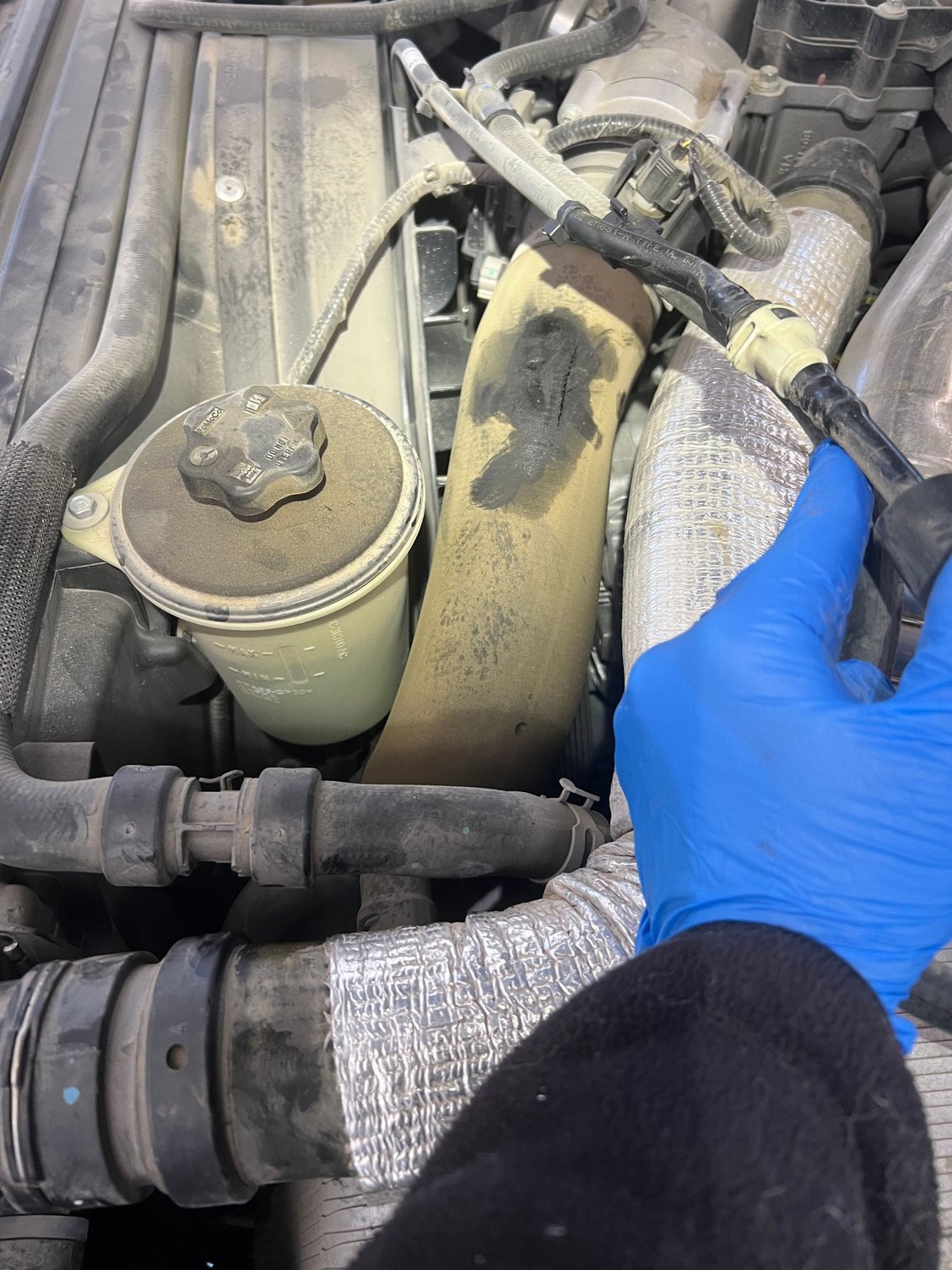

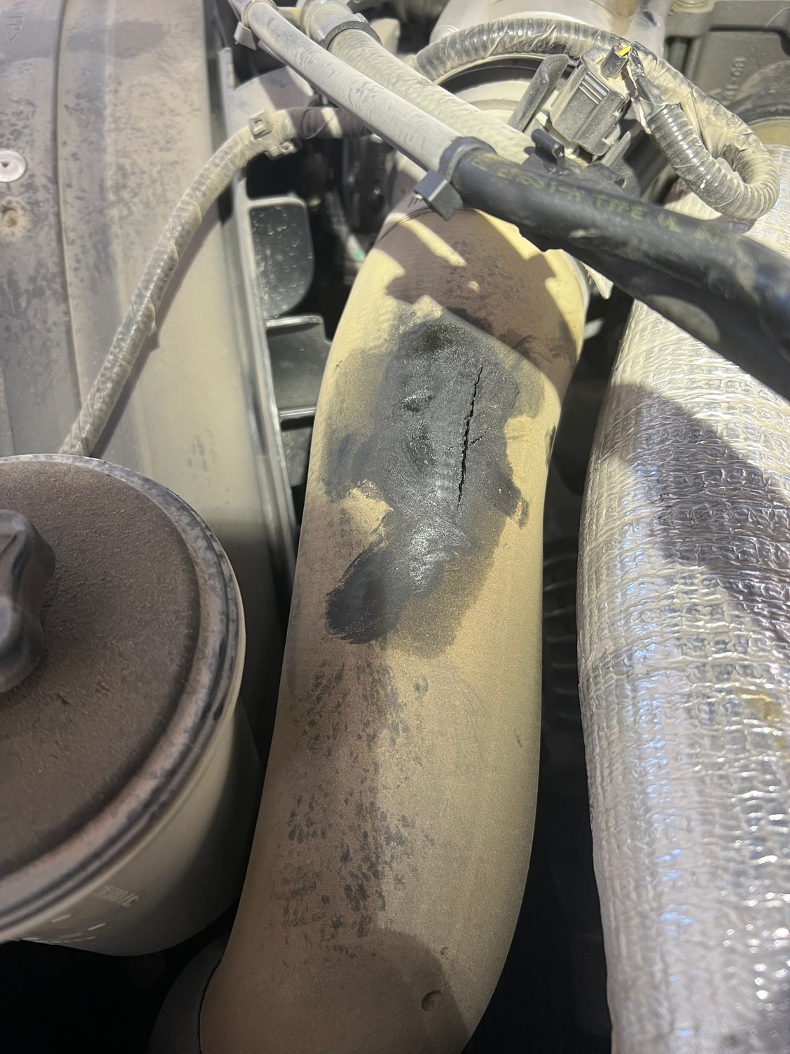

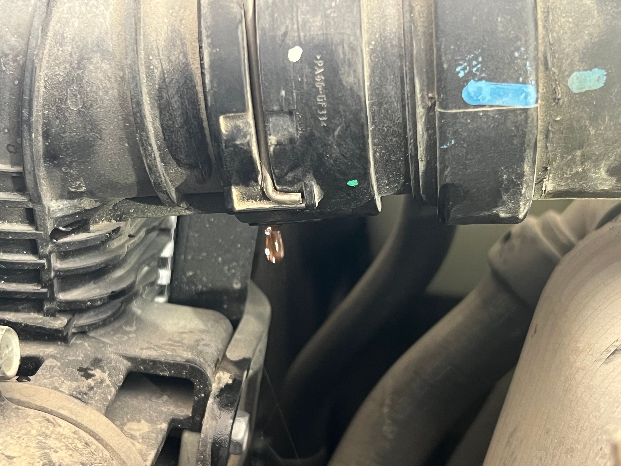

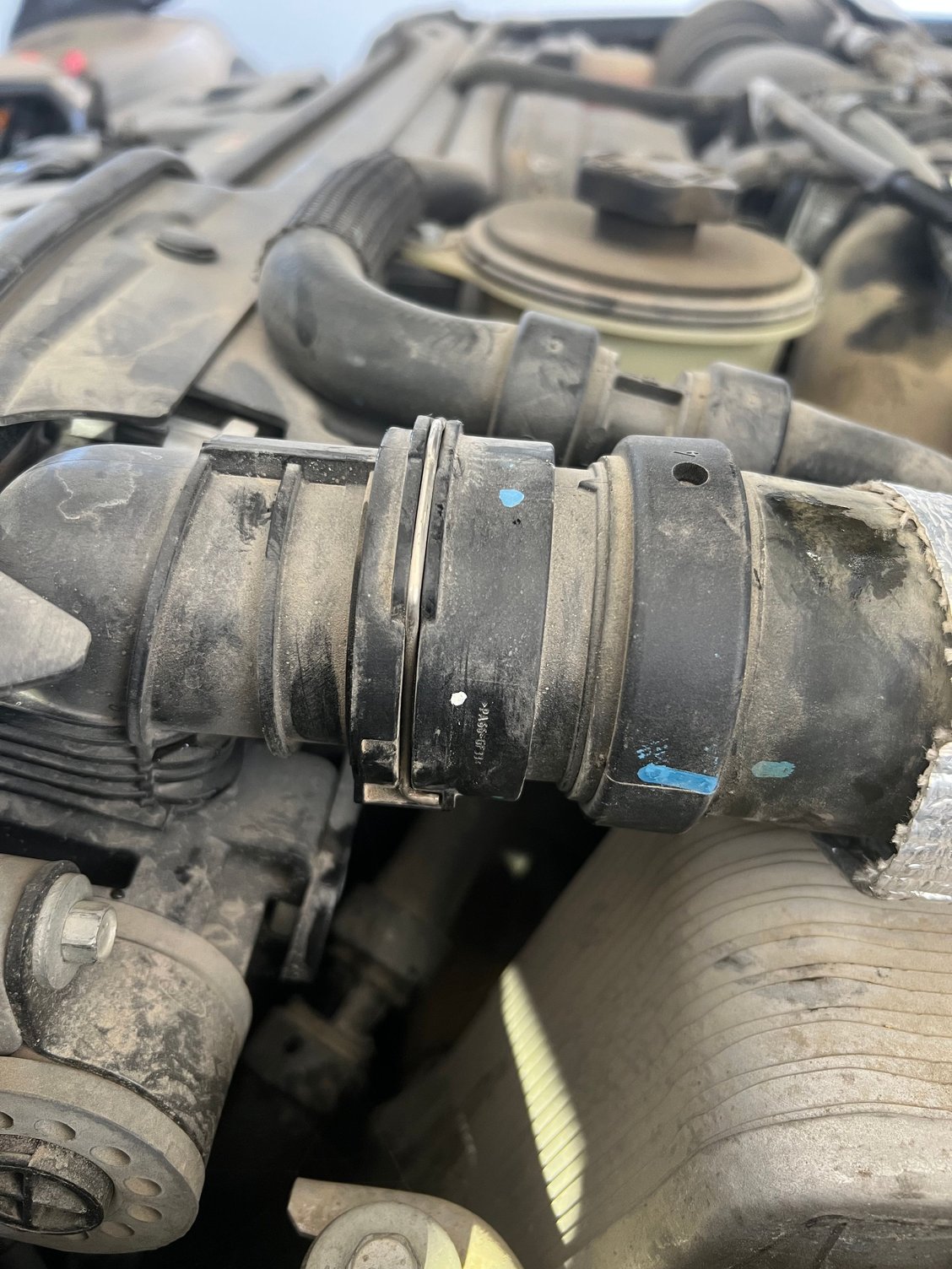

Guys I need your help, I have a ford f250 super duty diesel 2017 with 85000 miles, yesterday I noticed something was leaking, I found one hose crack (see picture) and another hose ( I call it hose because I don’t know the correct name for this part) leaking at the connection. I disconnected it, I cleaned it and I Put it back in place but it’s still leaking. Can you let you know the name of those parts pls? Is coolant what is leaking? do you know if replacing these two hoses will resolve the problem or there is something else that will damage the new part making this problem reoccurring again. Any advice will be appreciate it.

The hose with the split in it is your cold side intercooler pipe, also called CAC pipe. Lots of aftermarket options that will probably outlast the OE part. The other appears to be your upper radiator hose leaking at the connection. I believe there might be an o ring (BC3Z-8590-C) that is replaceable in there.
I would say that both issue are age related.
