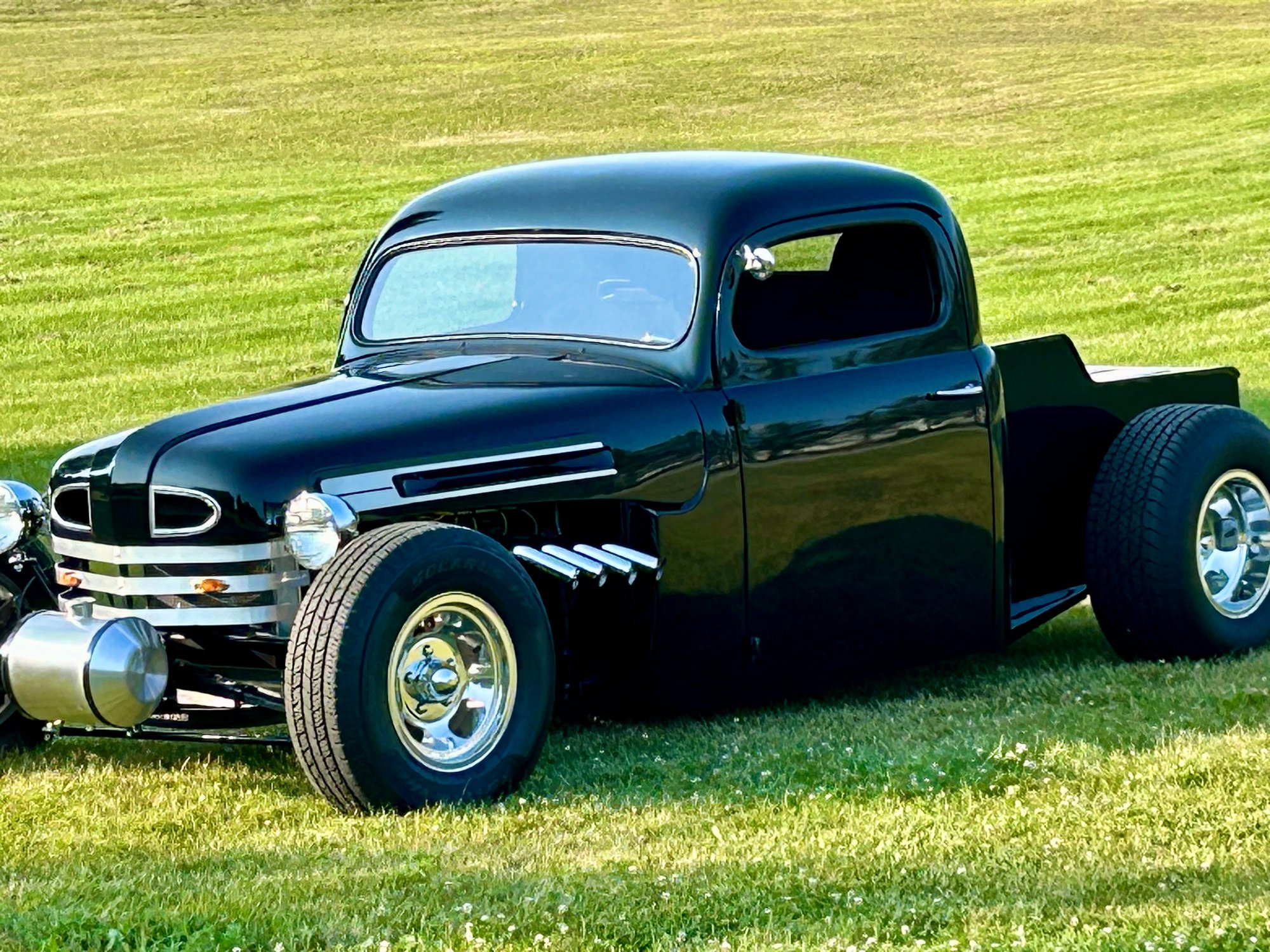

We are looking to remove the cab on our new to us F1 Hot Rod. Anyone know approx weight?
We have engine and tranny out and it is a custom frame so looks easy to unbolt. I have lines and stuff I would like to run and work on linkages.

Tom is quite correct about the stripped weight of the cab. Anything attached - like the steering column - would obviously change the lift weight but also the balance. Your picture shows some shiny paint that wouldn't take well to mishandling.

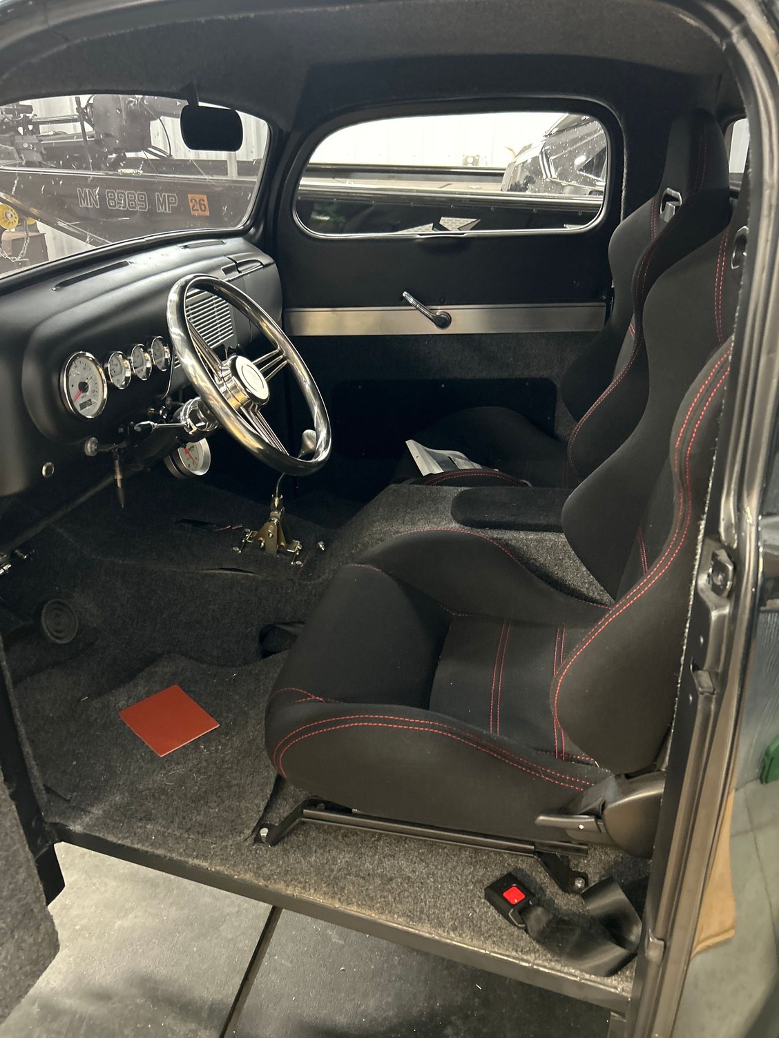

The paint is very nice so would have to be careful inside is simple and a bit chopped as you saw. No glass in doors or mechanisms could bucket seats
