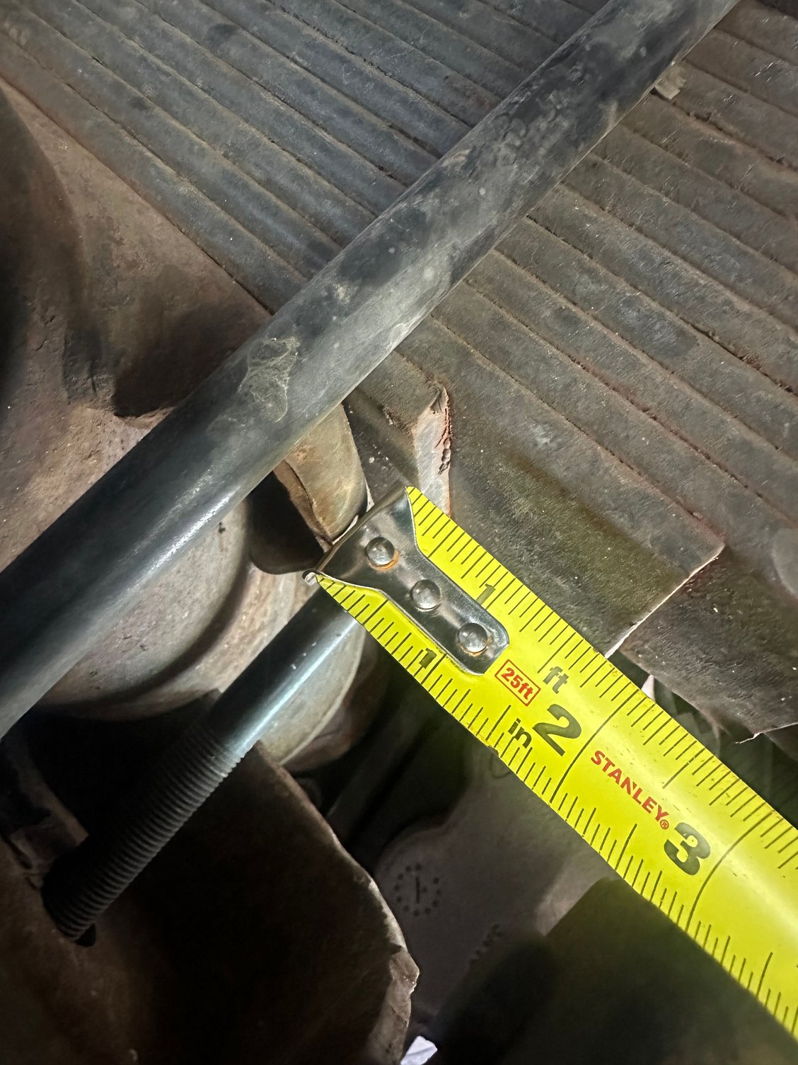

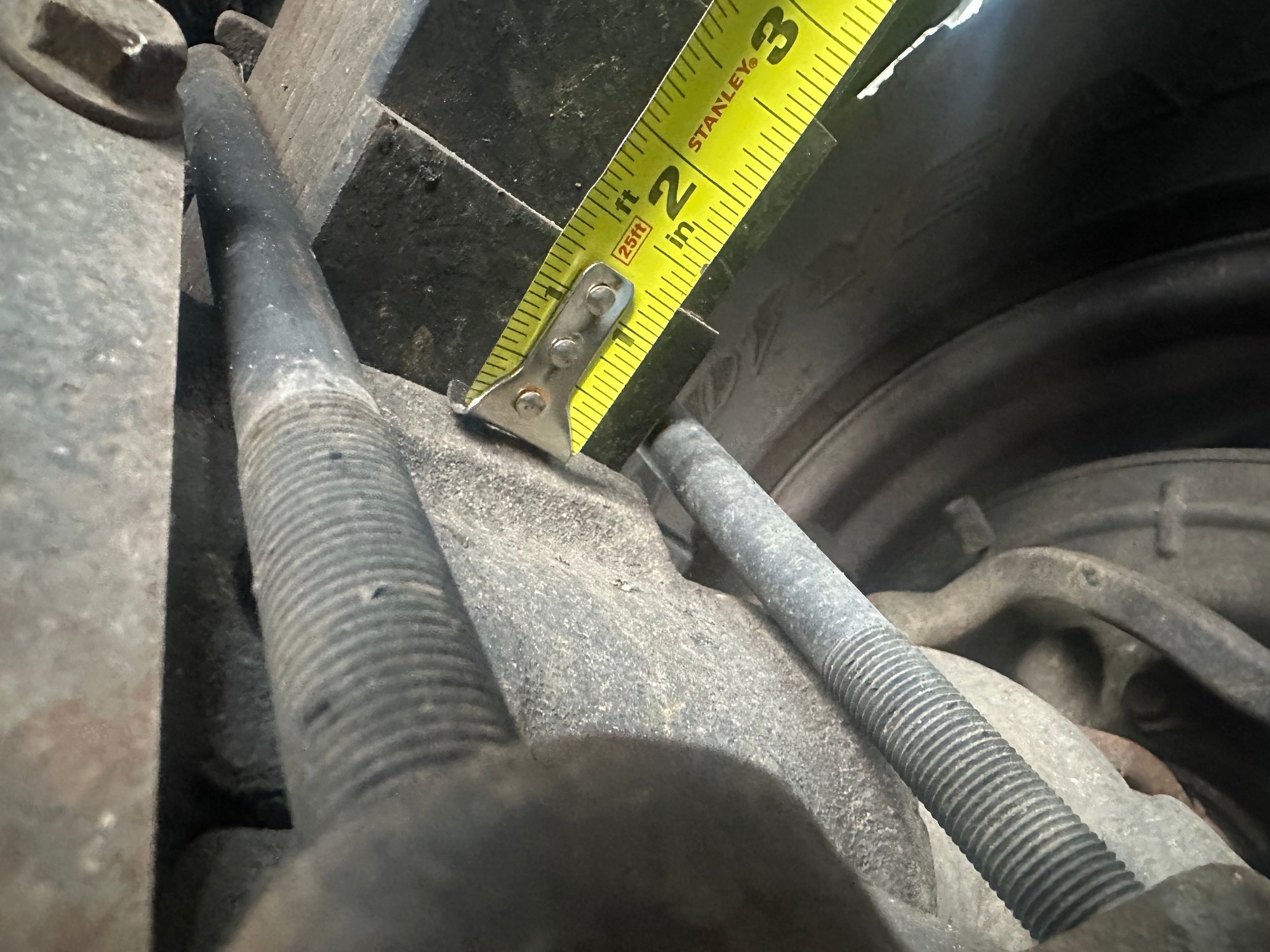

My truck hits the tire to the body on the passenger side and sometimes on the leaf spring. It’s really frustrating considering on a bad one it will gouge the tread. Tire wear is normal and the truck has been getting ~60k per set of tires.
last year replaced
Pittman arm
tire rods
drag links
hub bearing assemblies
front leaf spring hanger /shackle
leaf springs
Brakes
about 6 months ago added a 2 inch lift shackle kit as the springs were too soft
and adjustable trac bar
Everything went together easily without force.
front frame bumper mounting brackets appeared in alignment
Driver side from the front
Passenger side from the front
Lower locating pin visible in the hole.
Passenger side from the front ~ 1 3/4 difference

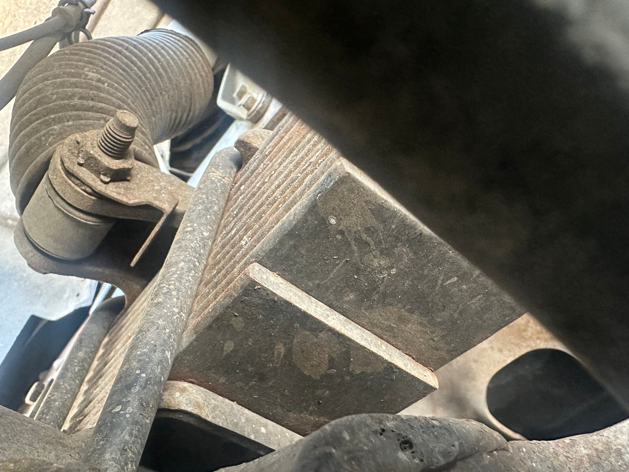

Passenger side from rear looking forward
Driver side from rear looking forward

I don.t know these springs, but it looks like either the center pin has busted, and the axle has shifted. Or, if these springs aren't symmetric front to rear, one is spun around the wrong way.
