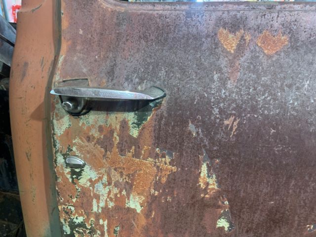

I am in the early stages of a '53 ford project and I am trying to wrap my head around exactly what I have to work with. The truck is definitely a 1953 F100 verified by the 8BA flathead engine and the frame serial number. My current confusion is about the driver's door handle. My passenger door has the expected shielded external lock.
Passenger Lock
Passenger Lock

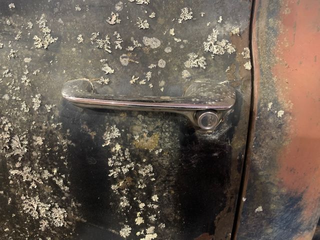

The driver's side has no external lock but the handle has one integrated into the release button.
Drivers Side Lock
Driver's Side Lock
Does anyone have any idea what year of truck the driver's handle would have come from so I can try to get a key?
The truck was last plated in '81. I rescued it from a junk yard in 2001 and have only recently started working on it. I expect I will have many questions as I progress with my project.

Only the custom cab optioned trucks came with a lock on the driver's door...the door handle pictured on your truck
is off a Chevy.

Given that the truck has a hood off of a '55 and a behind-the-seat fuel tank, anything is possible. I will have to open up the door and see if the key lock is even connected to the latch assembly. This truck was somebody's pride and joy at one time but given it was about 28 years old when last driven, it was likely being limped along anyway possible near the end of its first life.
Thanks for the answer.
