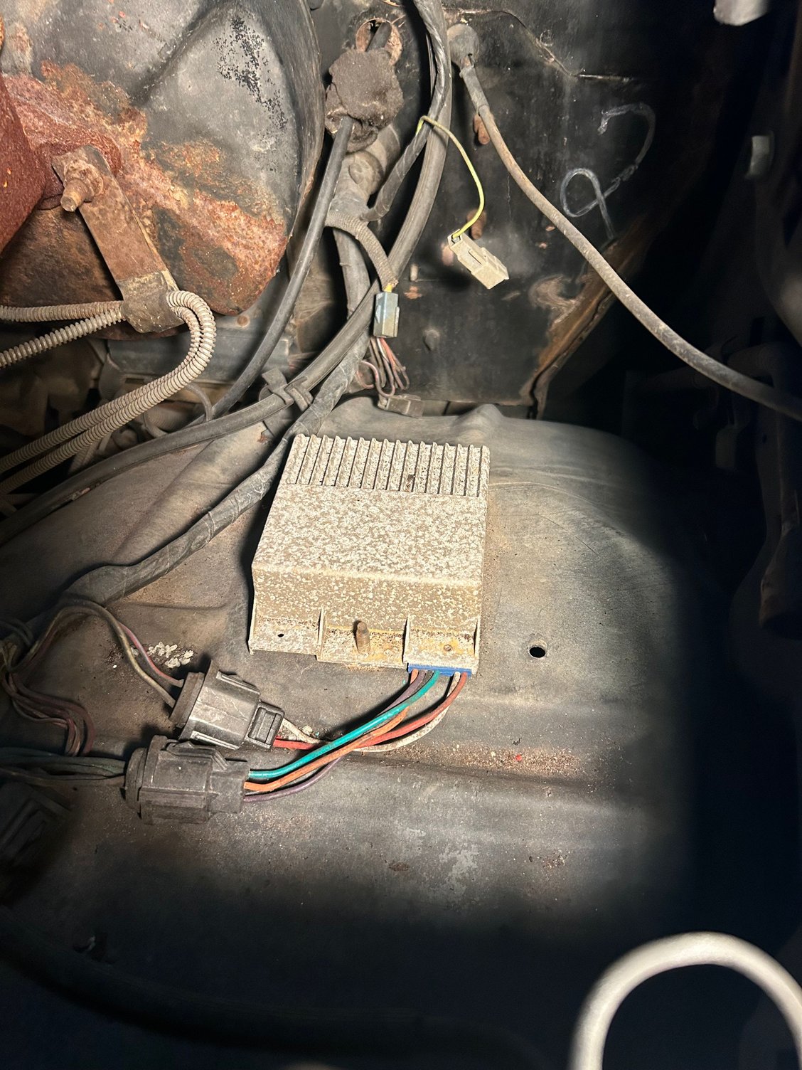

I noticed it had a silver box on the wheel well of the driver side but I did not take note of the color. I will check on that when I get home. From the reading I’ve done I would like to convert it to the duraspark II system if it isn’t already.

If you can post up a picture of the box and the dist. so we can see both we can tell you what you got.
Also Dave did not point out if the dist. has a vacuum hose going to it or not can help tell what you got.
We also need to know if the truck has to go thru smog by someone looking over the engine bay area like in Cali.

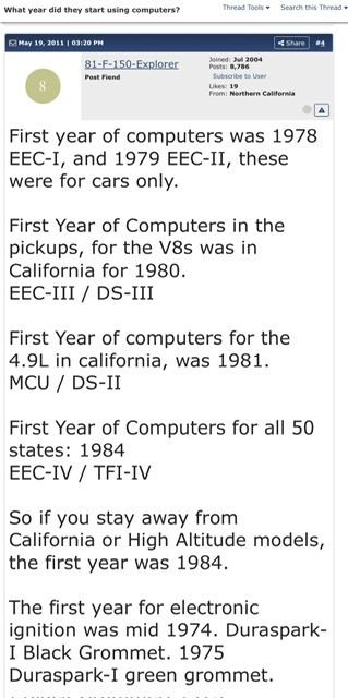

I did a search for “first year of EEC-IV” and got this result from 2011
and here is another partial answer
and here is a partial answer

From what I can tell Im a happy man with the DSII system, at least from what y’all have responded with. Silver box with blue plastic at the wires and a vacuum advance on the distributor. I live in a state with no emissions testing as well.

That is a good factory system. And easy to get parts for. If you ever happen to be in the junkyard, lift the hood on any Ford Lincoln, Mercury car or truck from the late 70's to the mid 80's. Any engine, 4, 6 or 8 cyl, they are all the same. If you see one of these modules that says "Motorcraft", pick it up. Those are the best to get. Just make sure it has the blue plastic where the wires come out. You can test it when you get it home, if it works, then throw it under the seat in case one day the one you are using goes out.
