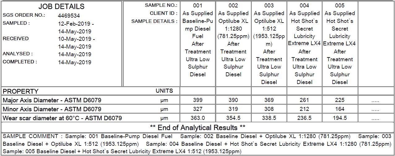

Originally Posted by acdii
And the test bears out exactly as HSS claims. Their wear claim is 453, what was the lab results again? 450? How much additive is used with EDT? 1 ounce per 25 gallons. How much is Optilube? 10 ounces for 40 gallons? With 10 times the product they had BETTER have more lubricity!!! Double, up or triple up EDT you will get results similar to XPD and Archoil, and still pay less per dose.
I would like to know the answer to that as well. I've naturally been dosing my EDT heavy, as the required amount always seemed too light to me.
I have some Archoil on the way to try anyways. I'm gonna dose my next batch of diesel heavy with EDT to use it up.
https://www.hotshotsecret.com/what-i...oes-it-matter/
And why didn't they test Hot Shot's LX4 extreme lubricity, like they did with Optilube's XL? Looks like the LX4 scores better than Optilibe XL.
https://www.hotshotsecret.com/lx4-lubricity-extreme/
