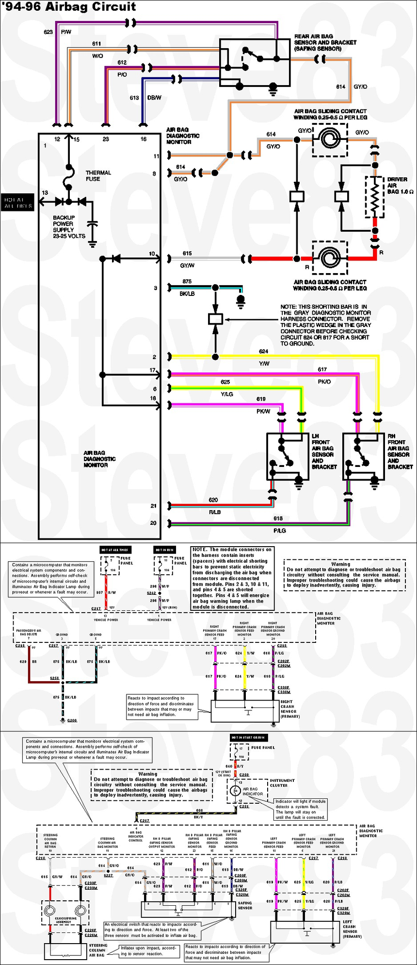

Now I'm trying to wrap my head around checking the wiring harness. I saw a couple posts in relation to their being open circuits in No. 617 and No. 624, but I have no idea where those are located, I'm far from an expert here in following the elusive trail of open circuits so I was wondering if anyone had an airbag system circuit diagram I could follow?
Or perhaps something else to troubleshoot?

heres a visual aid
