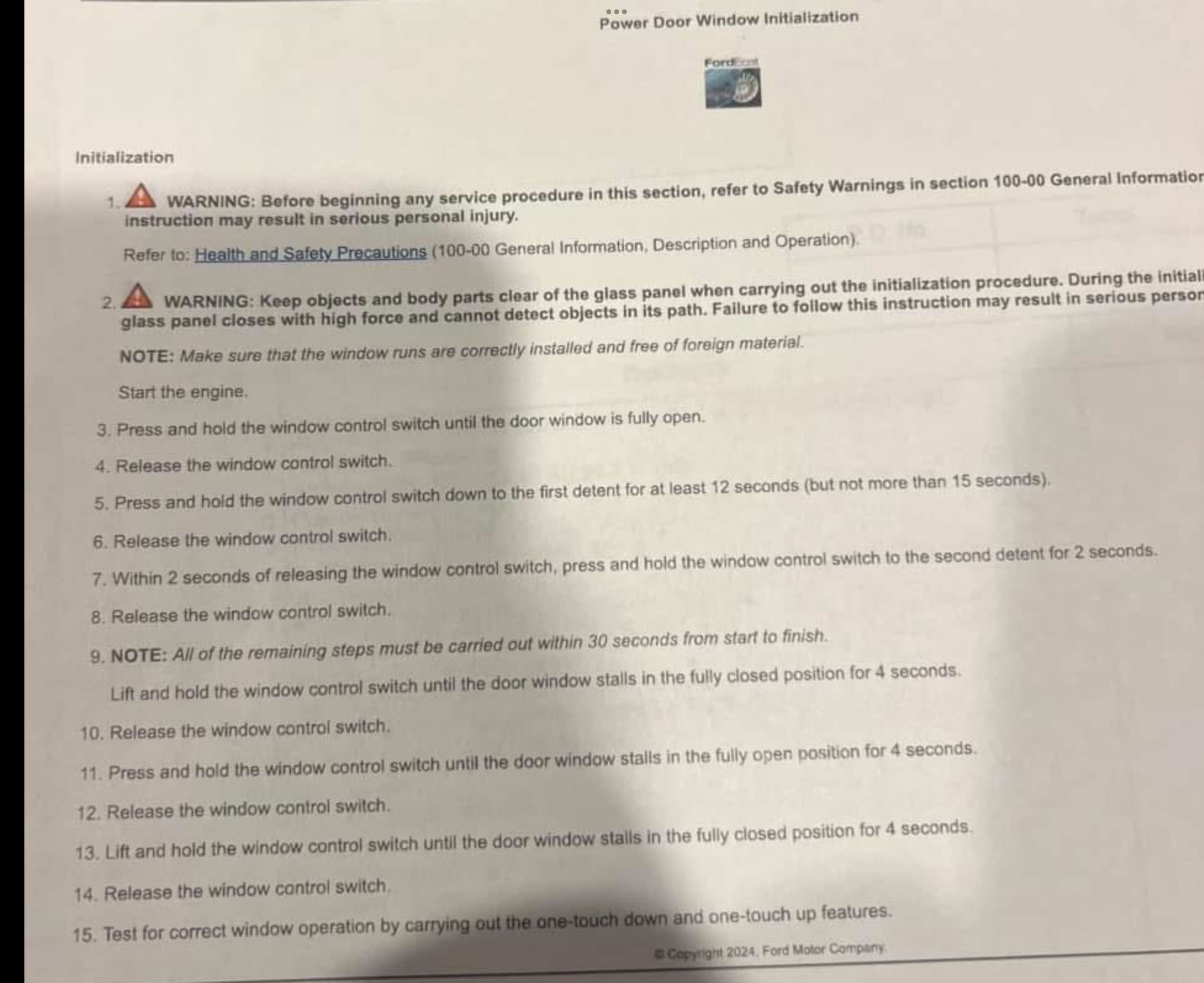

Here is the “official” ford procedure someone sent me. I’ll try it later…

I can confirm the above instructions work. It is very specific and tricky, took a couple of times but worked. The first 2 things are what opens up the re-learning of the window. When you do it you window will immediately open all the way down. In my case the window would open and you still had a sliver of window visible. As you release the button from the initial set up it immediately dropped an inch or so. Then you have to run through the last items quickly, which are basically the generic instructions you see posted on YouTube/online but didn’t work for me. The key was the initial 2 steps..holding it down on first detent for 12 seconds, then holding down on the second detent for 2 seconds, that’s when my window dropped fully. I used a stop watch.

On steps 9 forward, do you use the first or second detect on the switch? I can’t seem to get mine dialed. May need a trip to dealer, unfortunately.

iI believe I did the last steps all on the secod(full press/lift) detent. I practiced it and wrote it on a piece of paper in an easy to follow short hand. My window is still fine. I believe I was the cause of the issue in the first place by holding the button too long on auto..or something. They dont operate exactly as the previous models do, or feel like they do.
