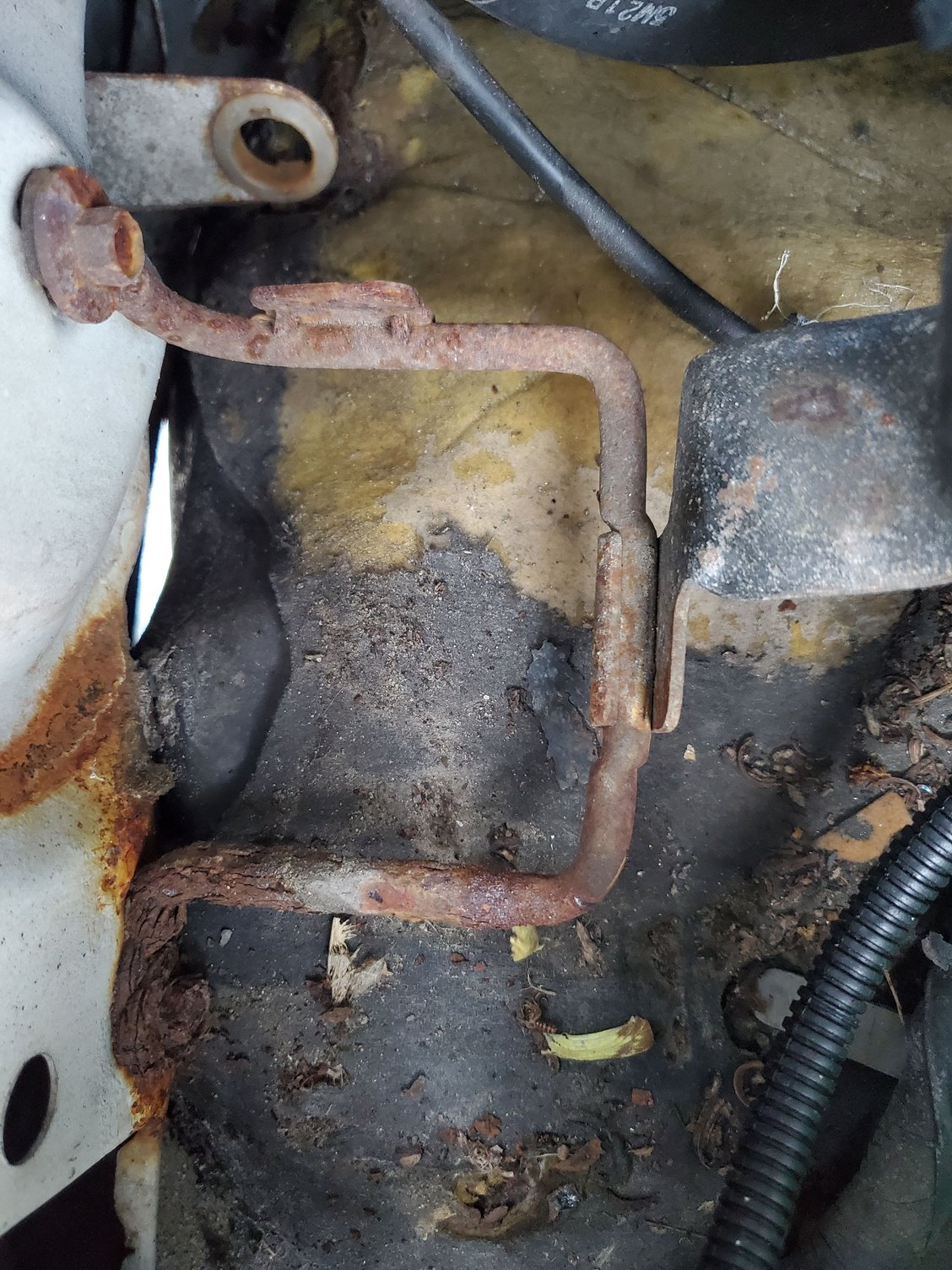

I started by removing the factory jack and lug wrench that obviously never was removed. This is the area I planned to install the new pump.
Believe it or not these bolts did come out. One needed a 6 point and some wd40

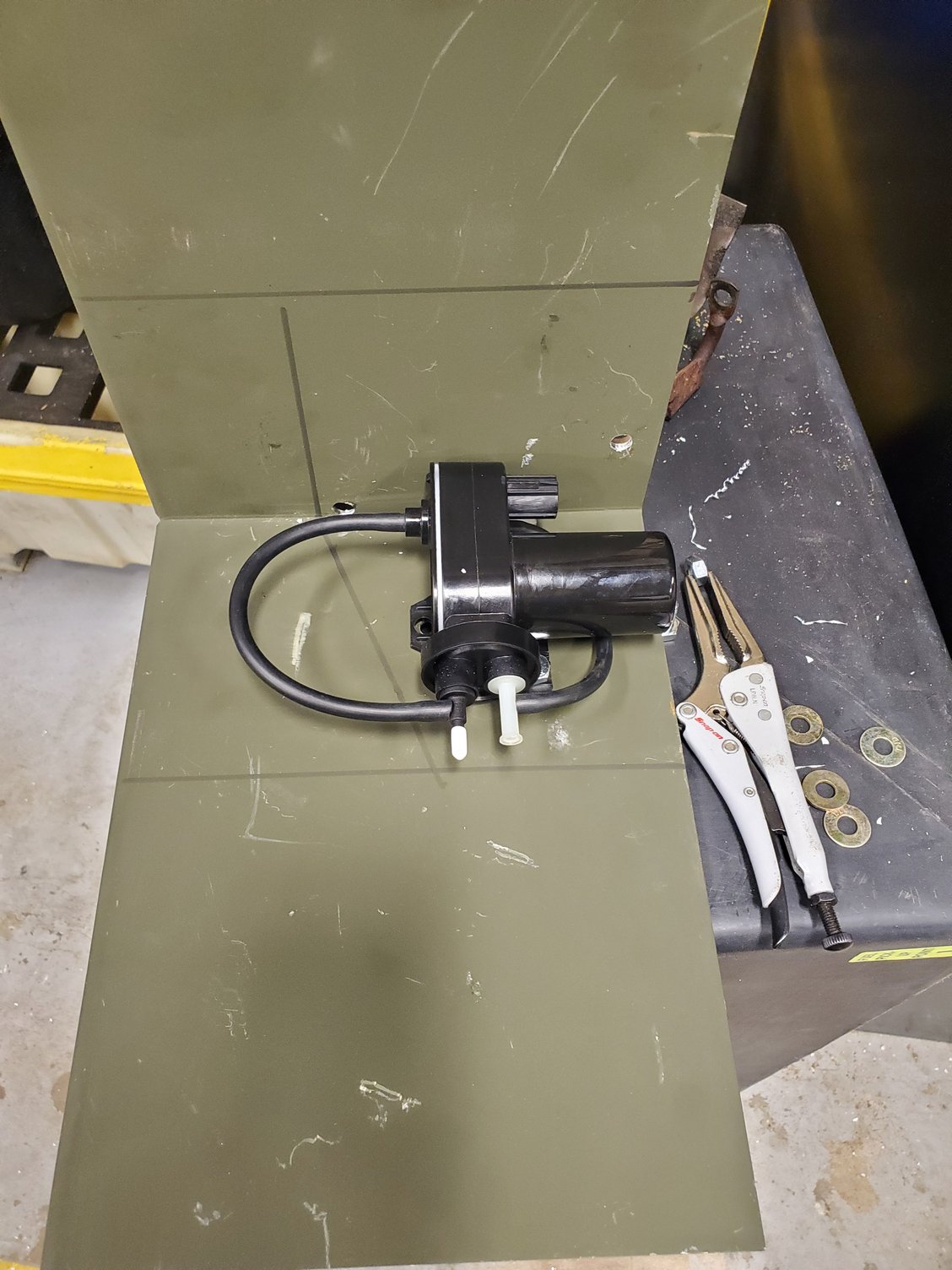

There are a few companies that make a bracket but it was ridiculously expensive to ship so I decided to make my own brqcket for free.
Started out with some scrap aluminum.
Once I got the rough measurements, i trimmed it down to fit around the various protrusions.

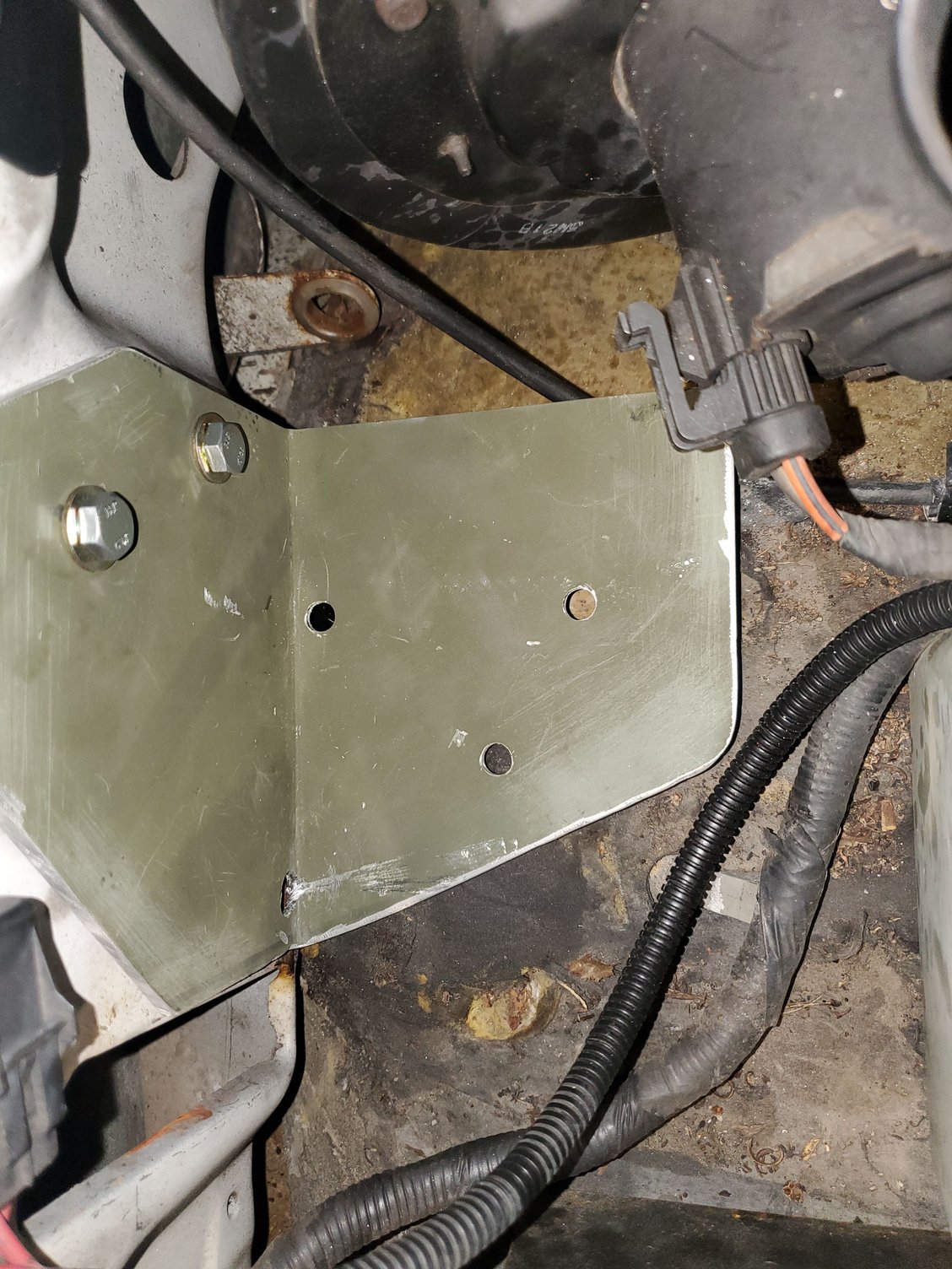

I smoothed the edges and painted it to blend in a bit. Only used 2 bolts instead of 3 to mount it to the factory inserts on the fender well, the last was down too far for my bracket to work. This pump doesn't weight anything so should be fine.

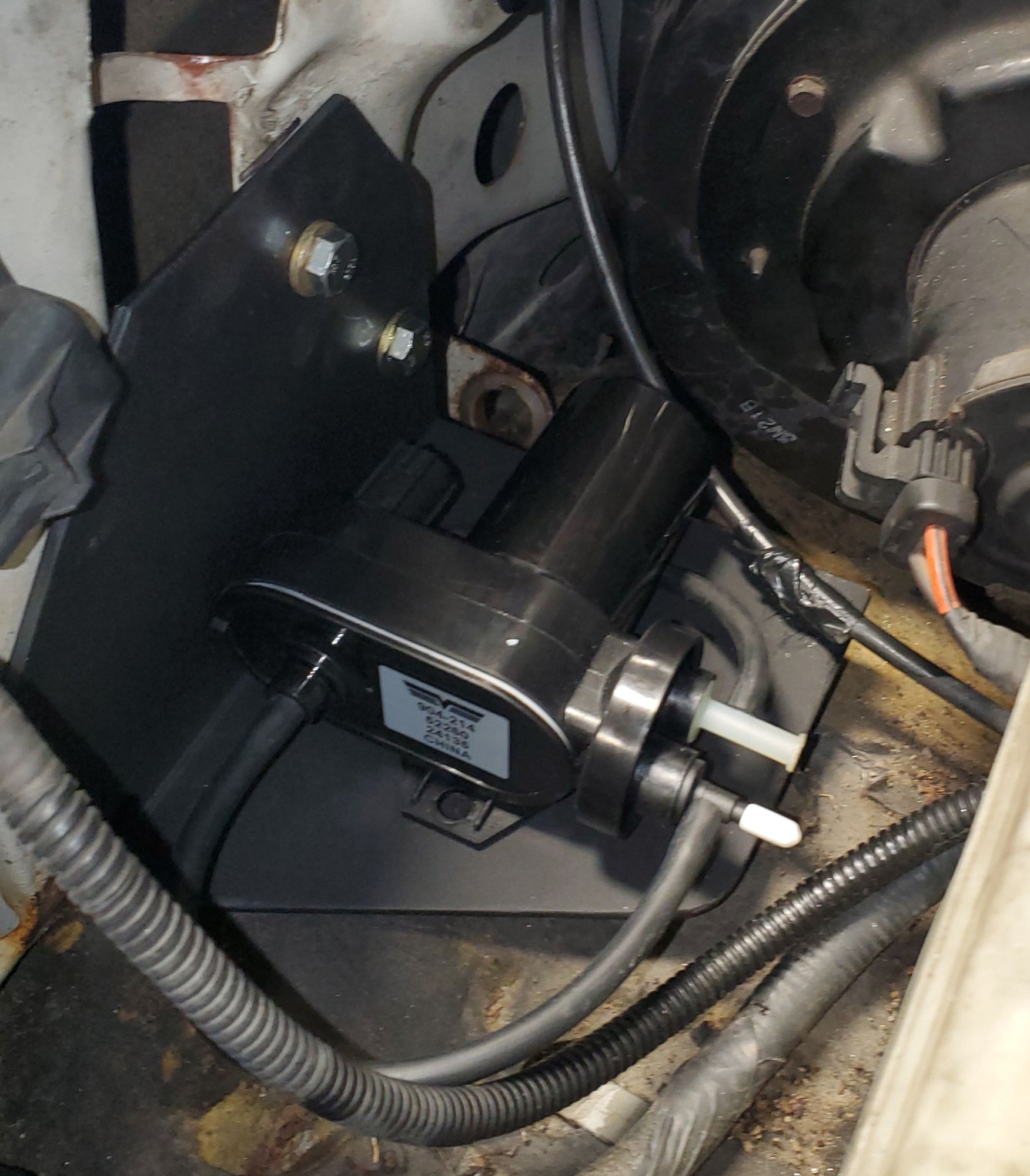

Here it is all painted and pump mounted.

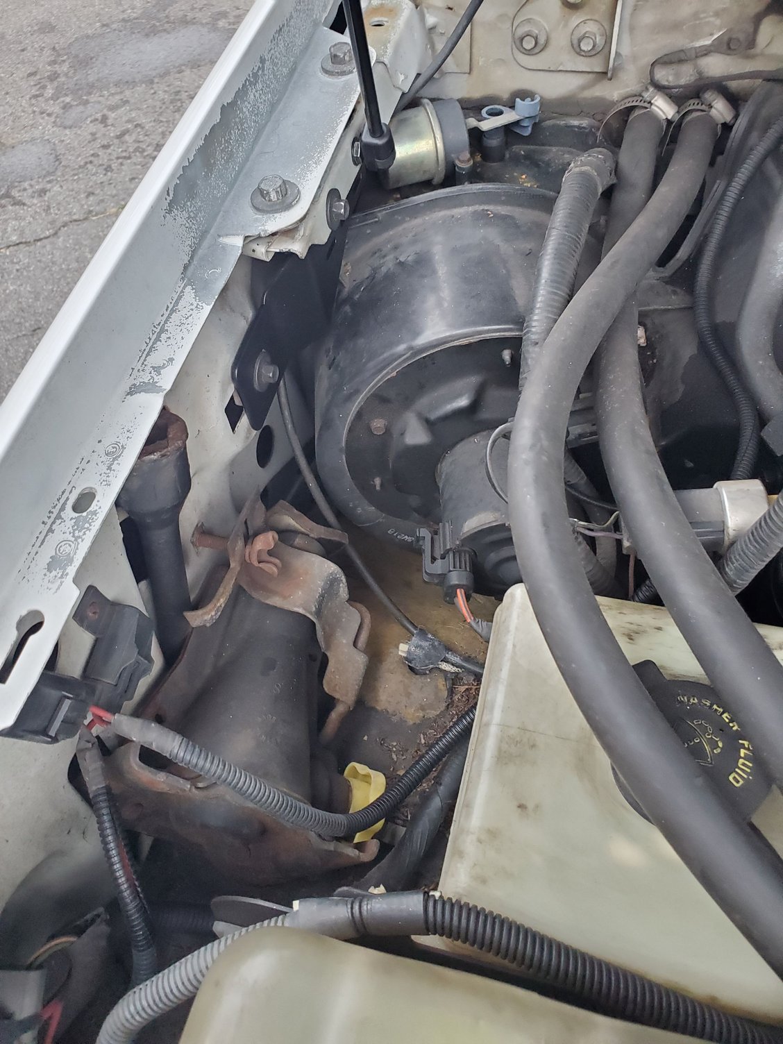

Still need to wire the pigtail up. Only two wires and ones a ground. That'll be later this week.
What do yall think so far? Trash or might be a worthwhile modification?
