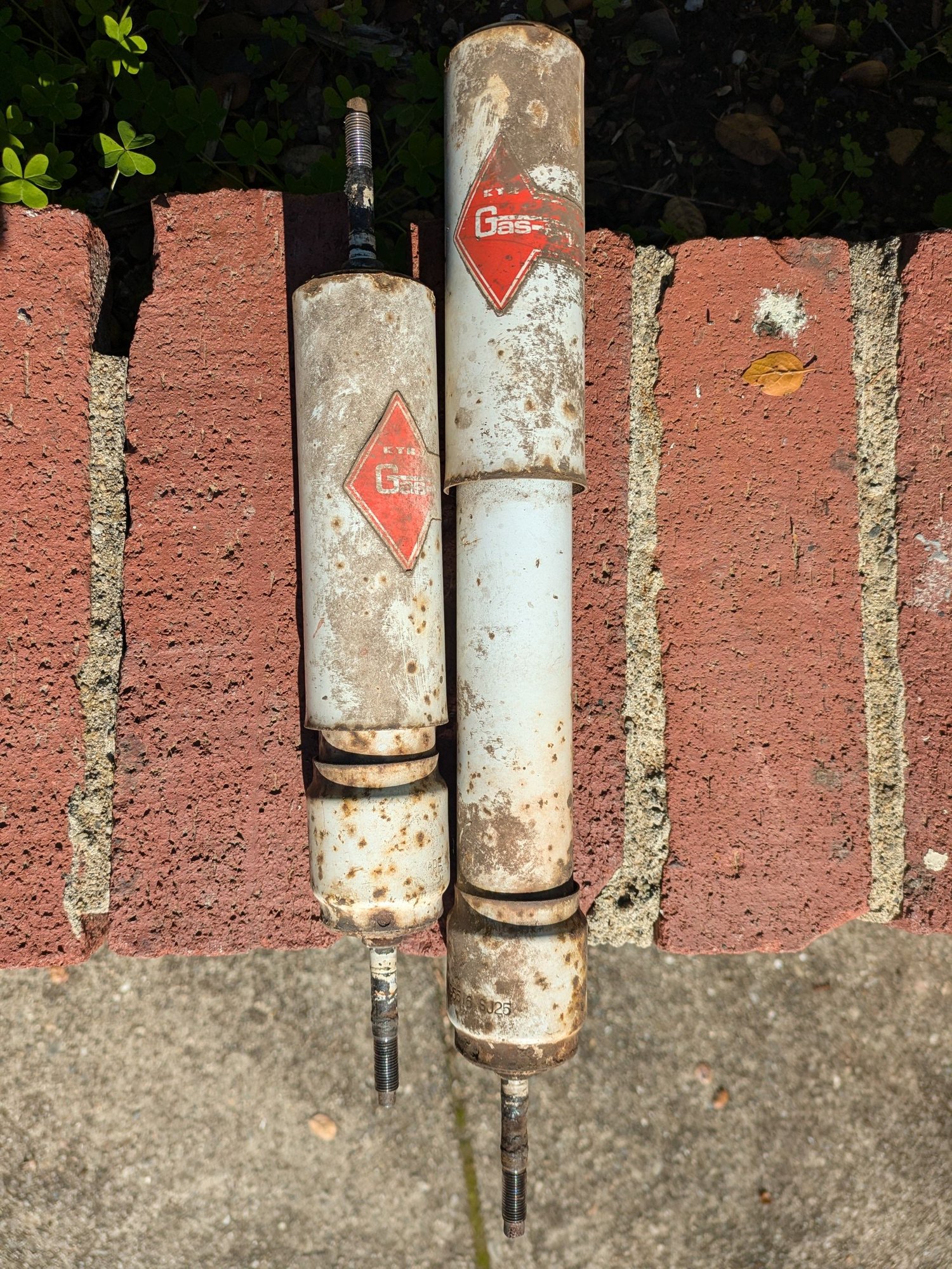

The KYBs on the '56 are probably about 30 years old. The pictures bear witness to that I'll admit.
I think I'll pull them off to see how they are, but am wondering what shock are you guys using these days?

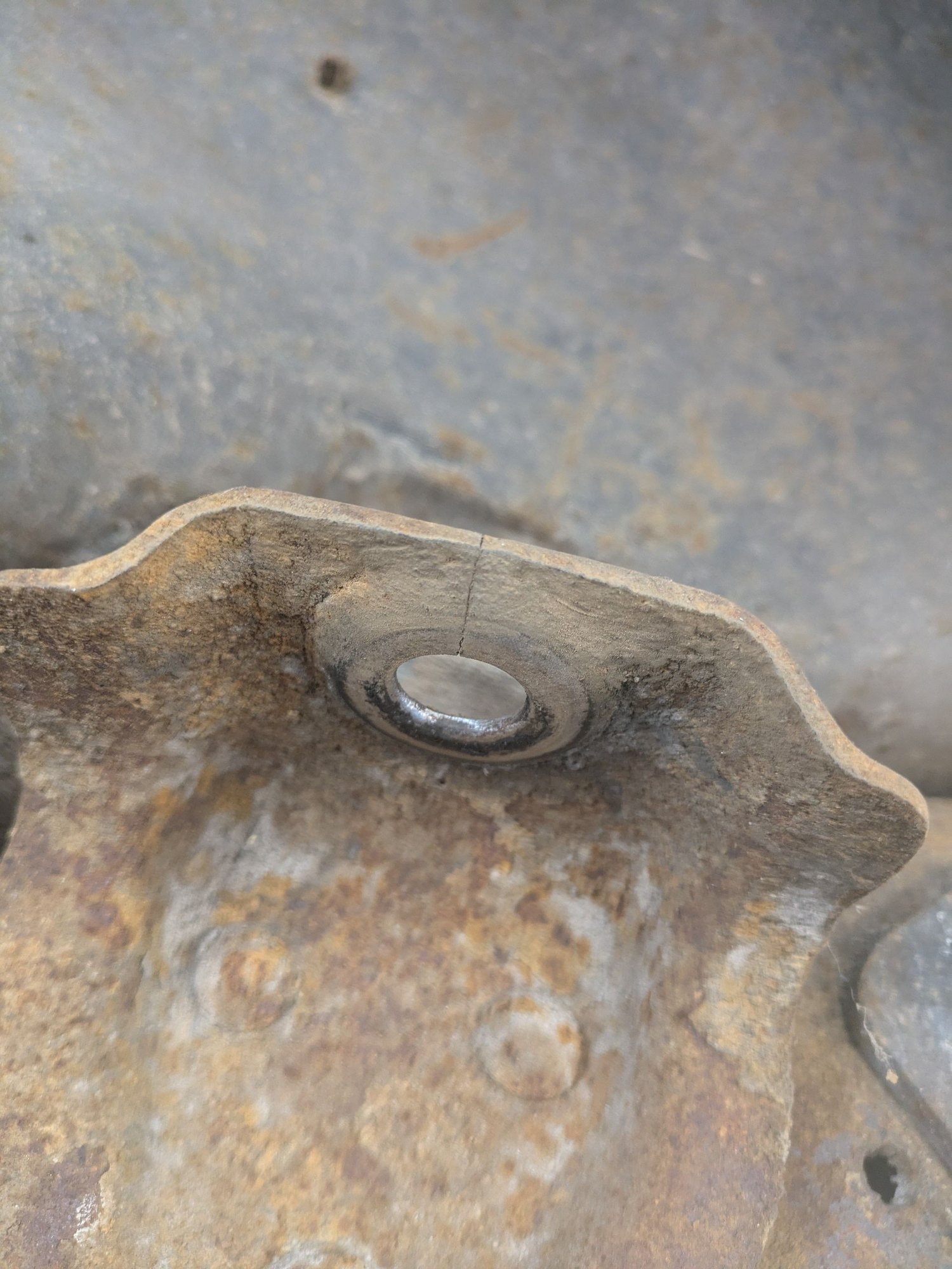

Here are the front two KYBs. At least 25 to 30 years old. Compressed length is 14.5 inches, extended length is 20.5 inches. No gas left in either one, but they are quite stiff. I'm still shopping for good replacements. Leaning to the Bilsteins. The part number stamped on the shock body does not match anything KYB makes currently.
The question I have at the moment is regarding the upper mount. Both have a seam/split in them. As uniform as the splits are, I'm thinking this may be they way Ford manufactured them. What do you guys think?

Here is a NOS mount with Ford Sticker: No Crack:
Another Ford NOS with Ford Sticker, again, no Crack:
https://www.ebay.com/itm/276578267680

Yeah.... So, weld it or replace? Drill out the rivets and bolt it? Guess I'd need two...It's that or I'd better start practicing with the MIG.

Ford Fasteners can replace the rivets:
20387-S8 ZINC Plated Hex Head 5/16-24x1 Bolt
33798-S8 ZINC Plated 5/16-24 Hex Nut
34806-S7 Cadmiun Plated 5/16 Split Lock washer

LMC does list them as available.....

I think I recall that the LMC offering is different from stock and thus possibly impacts fitment of other components. Unfortunately, the listing on the LMC website doesn't have pictures, just a wire frame.
If sticking with stock, you want the B6C-18035-A / B9TT-18035-A
