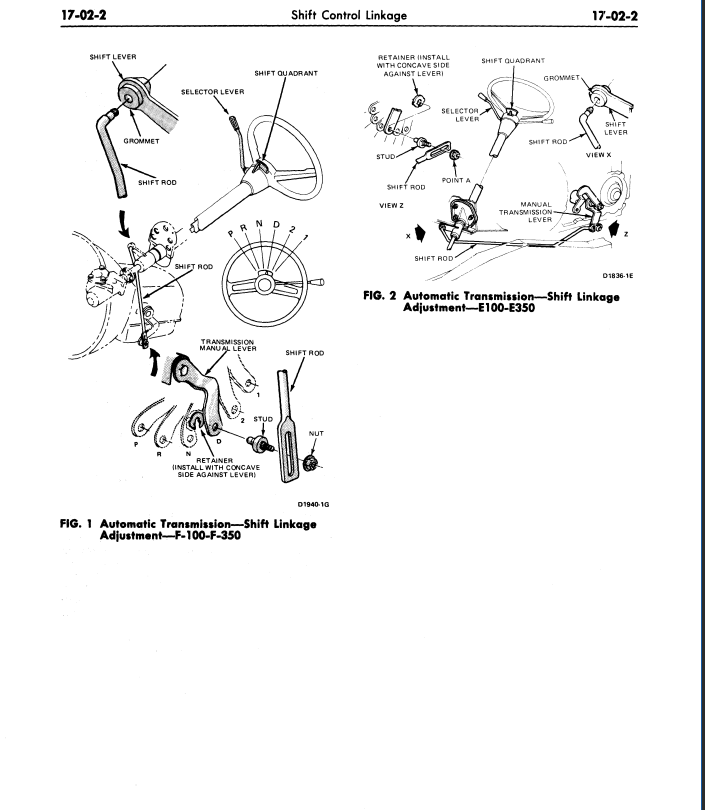

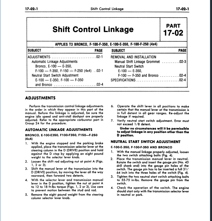

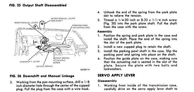

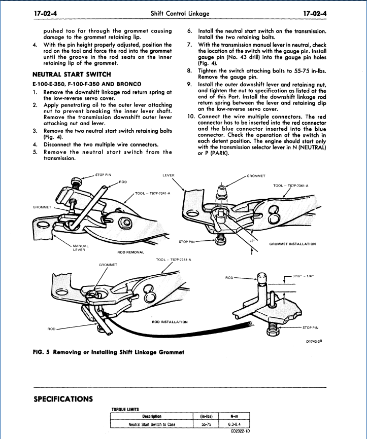

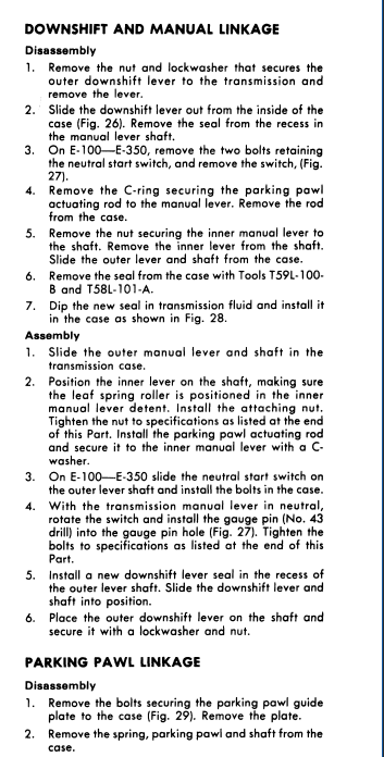

I think I would check all the shift linkage and make it is adjusted correctly. I grabbed some screen shots out of the '79 Ford Service manual. If it is not the linkage. It might be something inside related to the valve body and/or the kit you installed.
