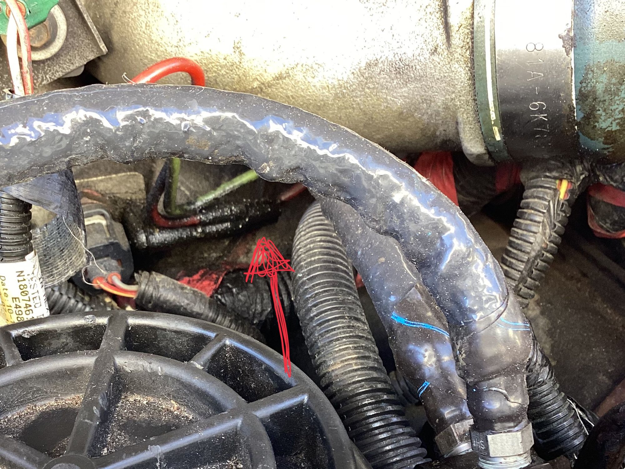

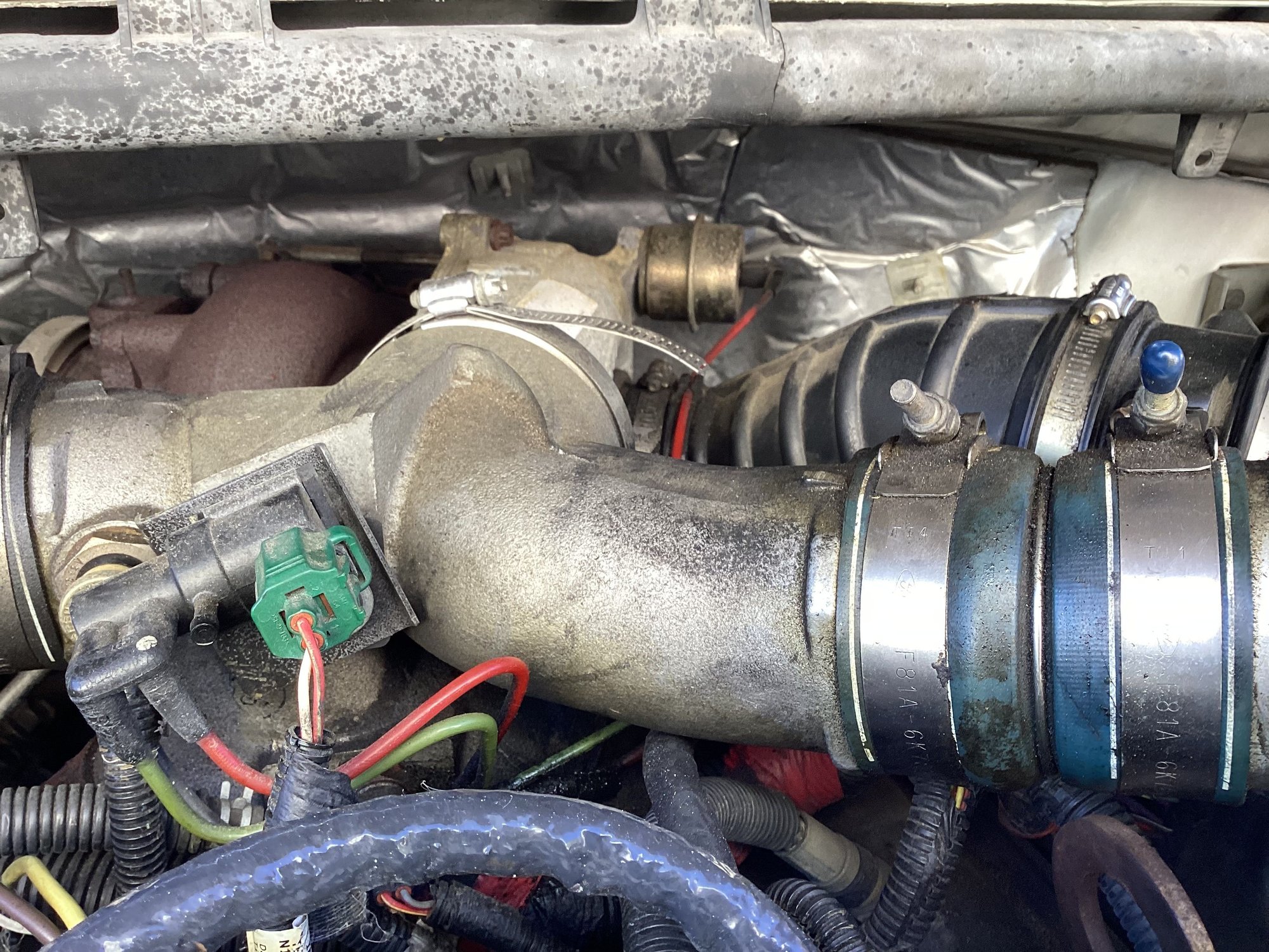

My truck is a 2000 7.3 auto with 205,000. I have had it for 10 years but just recently did some mods, the 6637 air intake, a RR FRx, and a switch to 5w40 syn. On the highway ride today, the truck pulled fine but was noticeably louder when I stepped into it. Seems almost like there is an air leak somewhere and air is getting into the fuel. I also installed a new lift pump with slightly higher volume than the OEM..
The only thing I can think of is that I might have installed the spring wrong in the FRx. Might be bent? I would like to be able to check fuel pressure at all times and am interested in anyone's thoughts or opinions on what I should try next. One option is to put it ALL back to stock in the realization that Ford engineers knew best. These mods have made zero difference.
Installed a new fuel filter yesterday and noticed these gooped up lines. Could wastegate be failed?

So first off the waste gate is fine. It's inside the passenger side of the turbo. Those hoses are the waste gate solenoid hoses going to the waste gate actuator. If they are leaking it's a win/loose scenario. Good that they aren't supplying enough pressure to open the waste gate, bad that they are leaking boost to atmosphere

Another common reason for poor power is boost leaks. You say you tightened the clamps. It’s possible to crush the plenums or cut a boot when tightening. Boost leak testing will help determine.
Furthermore, bellowed uppipes are also recommended as stock units are almost certainly leaking at this point. But since you haven’t touched that side of things recently, they’re not suspect as a “new issue”.
