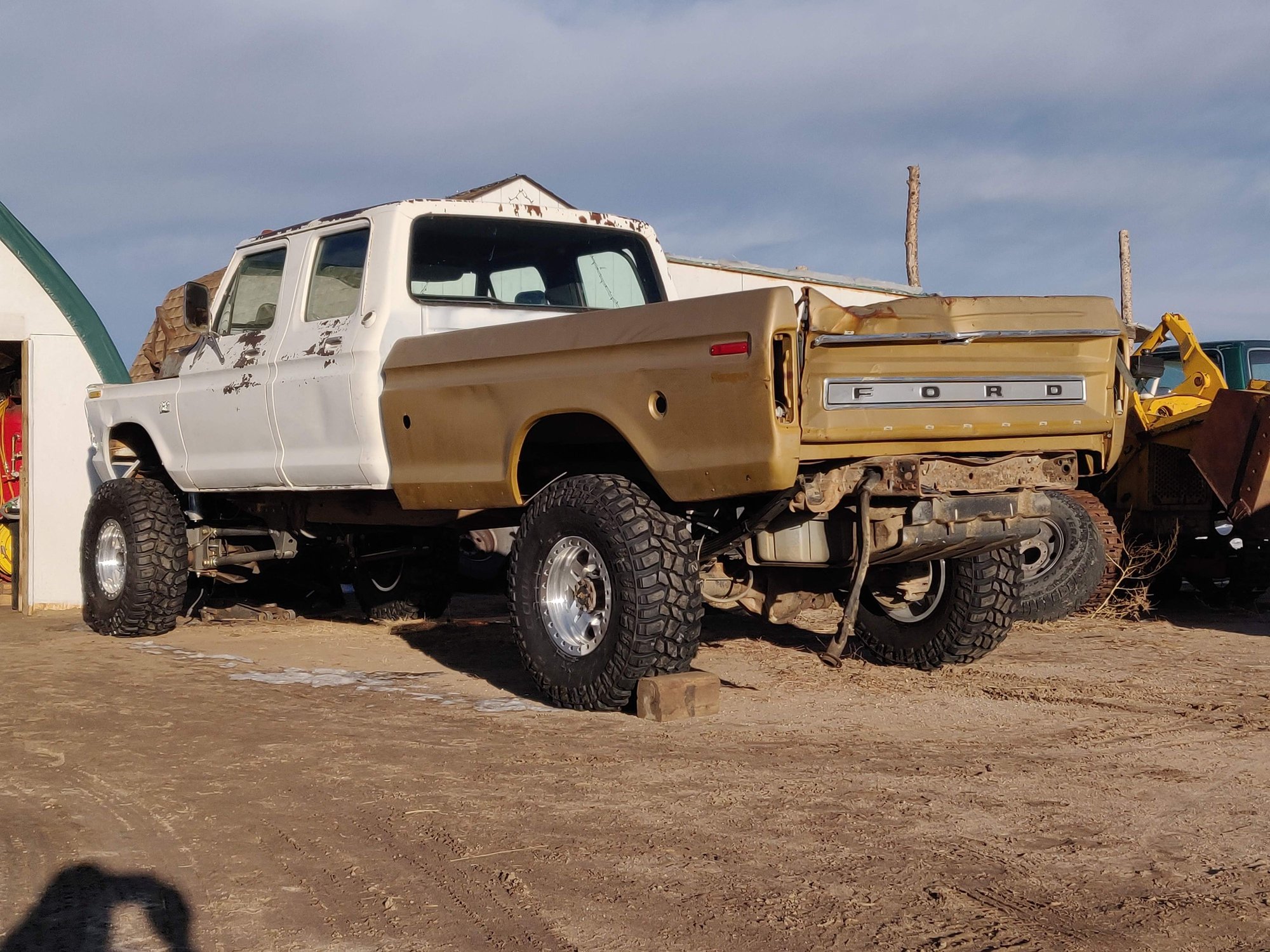

Thanks for asking about this...I will need it one day when I get to my 76 F350 Crewcab Project. It has a 7.3, ZF6 converted to 4WD. I already have the electronic T-case and had to do something to it already. I was going to make my own kit but now I don't have to

It's got a long way to go. It's been sitting like this for several years. I really need to get to working on it. It's out at a buddies 30 minutes away. If I had everything I needed at home, it would probably at least be on the road.
Right now, I'm at a point where i need to cut out the firewall and weld in the superduty firewall/ tranny doghouse and make custom cab mounts. I at least need to cut out the firewall so I can get it slid forward into position so i can figure out the cab mounts.
Then, I can work on moving the rear axle forward, but I'll probably do what I can to get it running before I worry about the bed and rear axle.

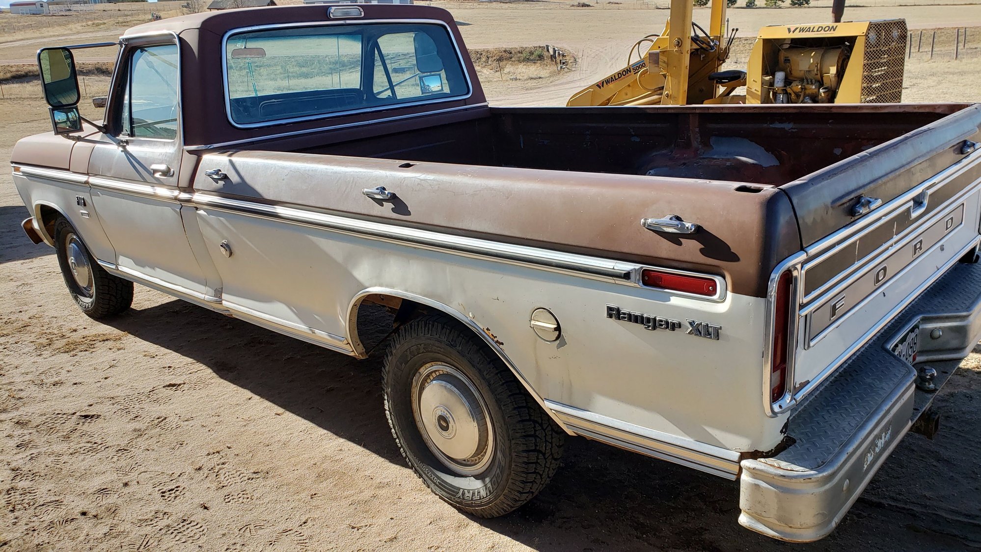

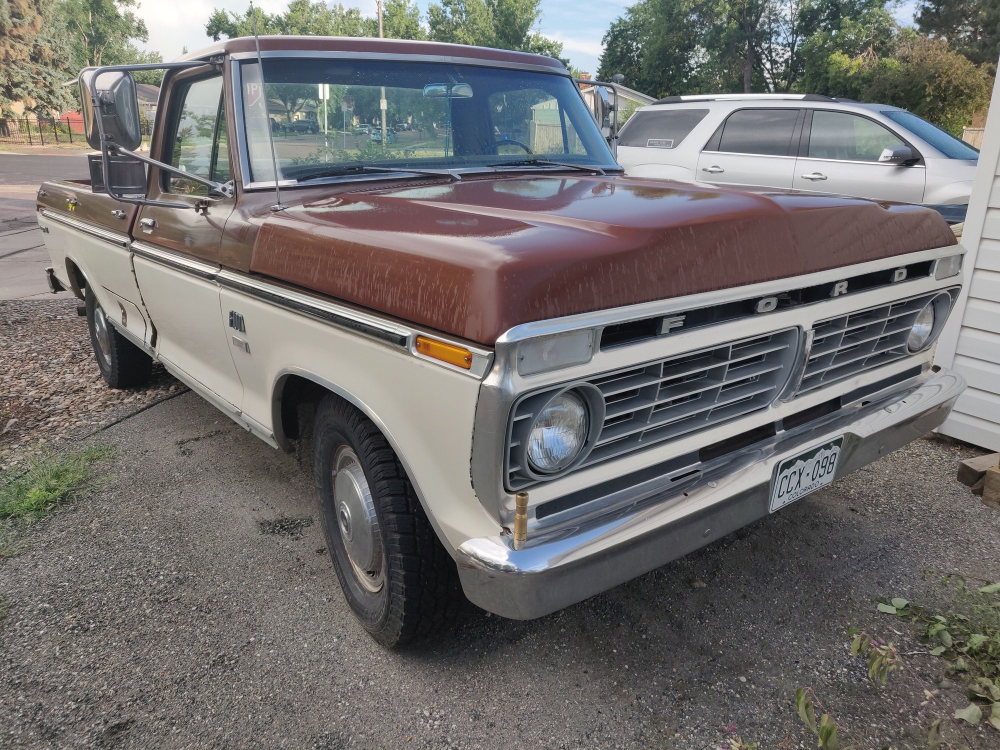

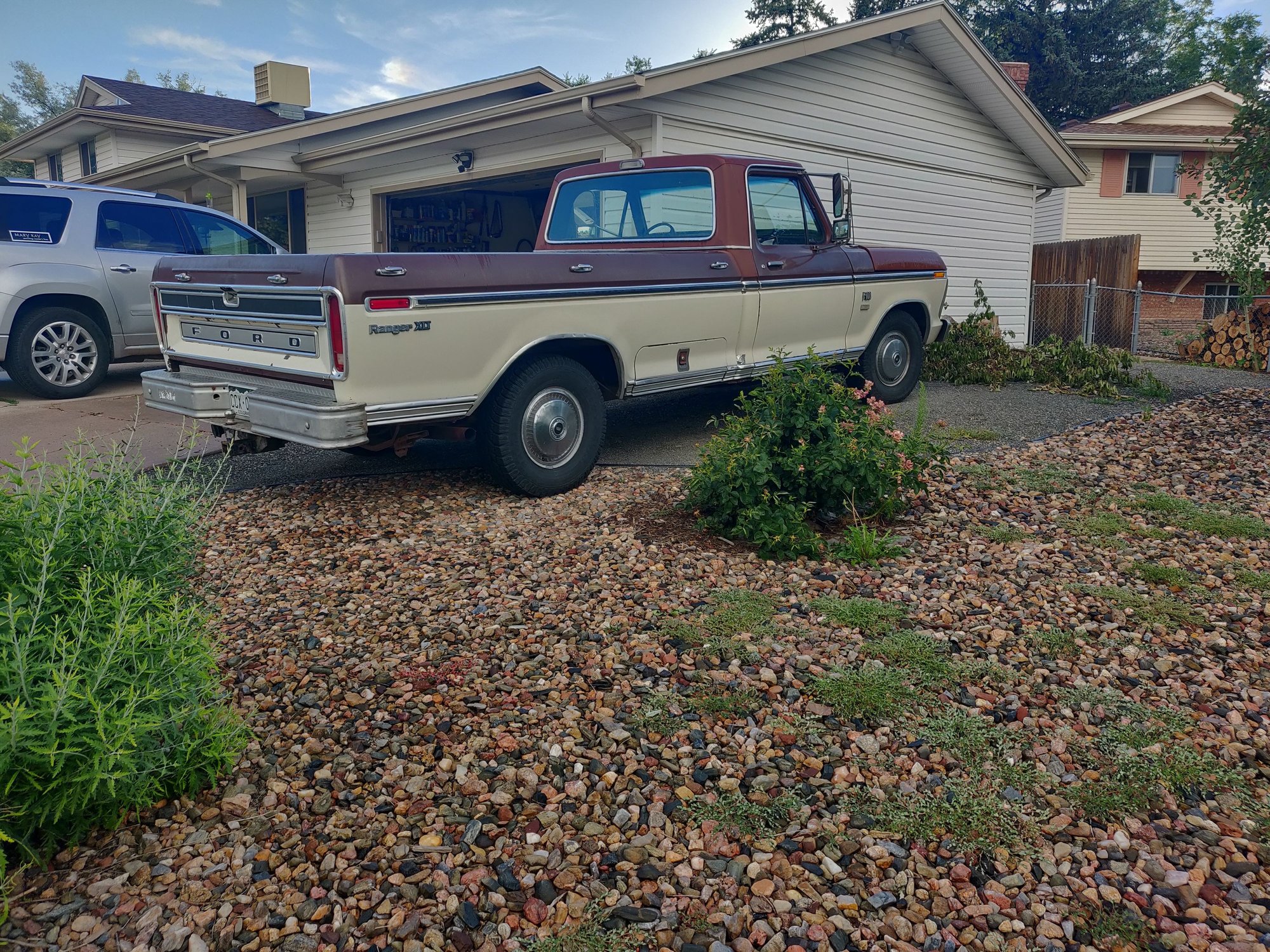

couldn't agree with you more... I also have an old 73 camper special but doesn't have the super long wheelbase...Don't hit me, but i only bought it for parts for the 76. Going to use the front clip, doors and tailgate. Has a 460 in it..but that's going to my buddy for his 78/79 bronco. I was going to use the bed but I think the gold one currently on the frame is a better candidate.
The only other truck I like just as much is probably mid to late 60's with the teardrop wheel wells on the bed. But I could have a truck from ea generation not counting the 80's (didn't like any trucks that decade) and be pretty happy.
I grew up on a 74 F250 XLT Ranger 2wd 4spd when they had the true granny gears

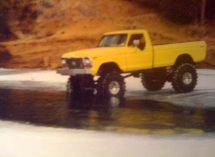

Here is my old 79 F150 I converted into a 350 but kept the 150 frame. This build has it's own story for another day
