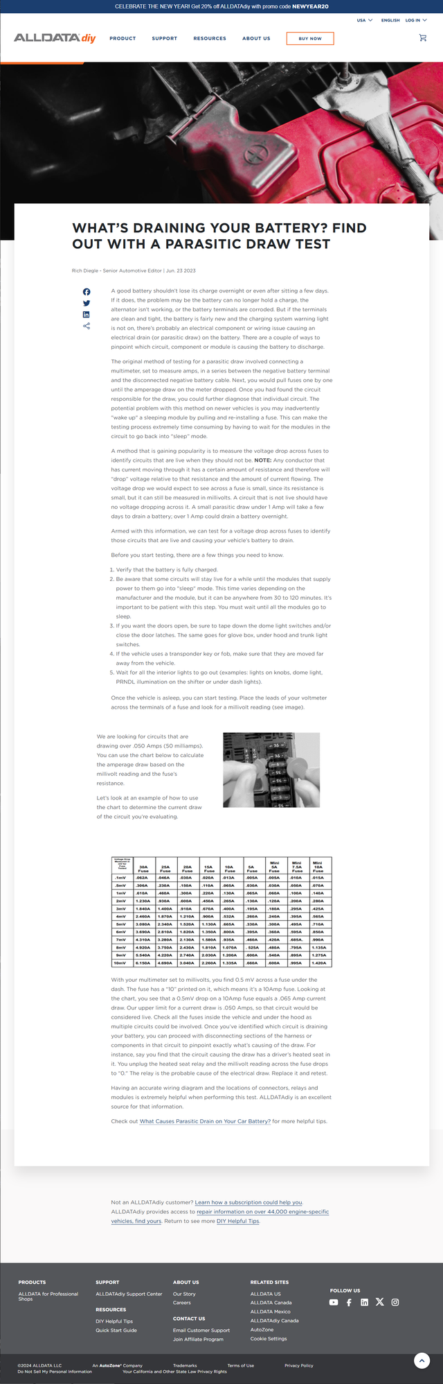

Do this: https://www.alldata.com/diy-us/en/di...50%20milliamps).

Motorhomes can be tough, since they have so much aftermarket stuff.
Do you have a cluster of wires going to the factory battery terminals? If so, and you probably do, you may get to the point where you will need to disconnect each from the positive and test them independently with the above referenced method with the multimeter.
