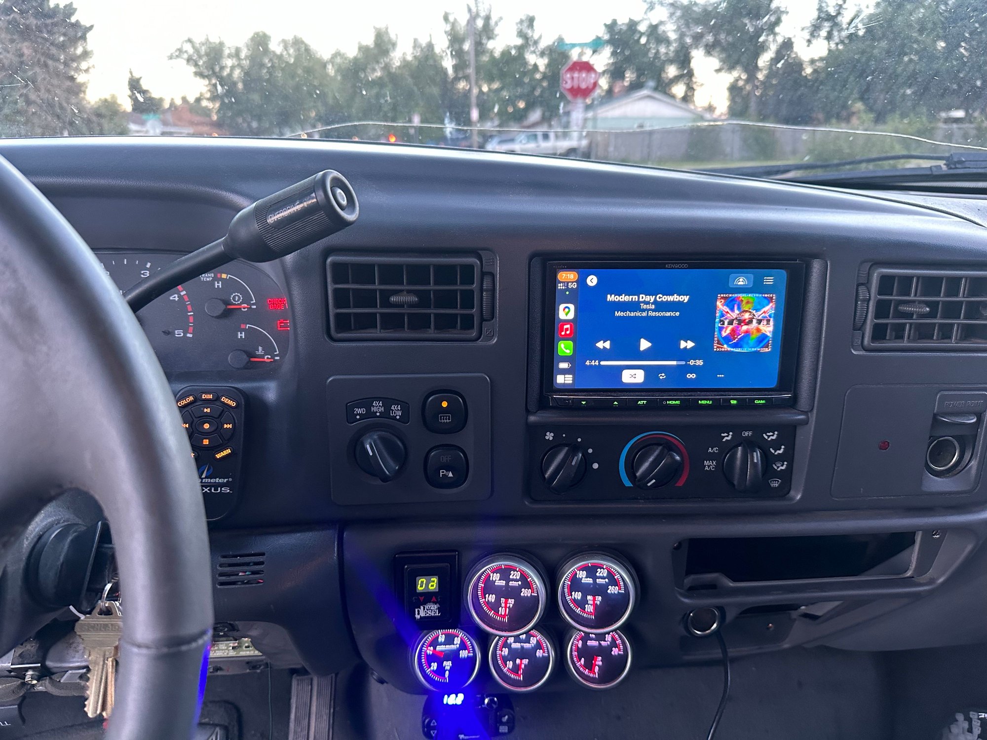

I have the F650 lower dash with my gauges installed there. I once tried the pod above the mirror but not my cup of tea...same goes for the pillar pods. The mirror pods are cheap, warped and have a horrible fit. can also be seen from the outside...no thanks.
Sorry for the bad pic. This pic was actually for when I finally got my Excursion defrost switch to work my heated mirrors.

So having the gauges mounted there down low isn't an issue in monitoring them and/or a distraction...maybe it's just in my mind. Was the F650 lower dash fairly easy to install...and how did you mount the gauges in there as it looks like they are angled for ease of viewing...

I love my gauges down there but some may not. They may like them in their face. I have OCD about obstructions in my view and things on/ above my dash.
I also have one benefit that most do not...My gauges flash red if they go above my set warning settings. I also have peak recall and can datalog my gauges (although I've never used datalogging)
I know my truck very well, so I don't need to continually monitor anything anymore. If I'm doing testing or something, sure. I can still easily read my gauges driving down the road without any danger to myself or others, I randomly look at them, otherwise I might take a look at a light or something.
I would say quick glances down would be no different than looking at your pillar, above your rearview or at your instrument cluster.
As far as the install...it's very easy. They do have to be color match painted. I can't recall the name of the special paint that has the Ford colors though. The hardest part for me was figuring out exactly where i wanted ea gauge, marking them and cutting out the holes. Also of note, I believe my 650 panel was the one that has holes for air brakes. gauge placement has to cover those precut holes. It was not a simple mount gauges and your done. I had to do some creative engineering to get the gauges flush as the overhang/shelf kept them from flush. So I had to carefully sand spots with a dremel. It was just a tiny bit but also some added work
I do not recall but I think I either purchased a kit or they came with the gauges to shim them at an angle. It does help the viewing angle a good deal. Lastly, the F650 panel used to be more affordable, not sure what they go for now. It is a direct swap for the panel itself though.
