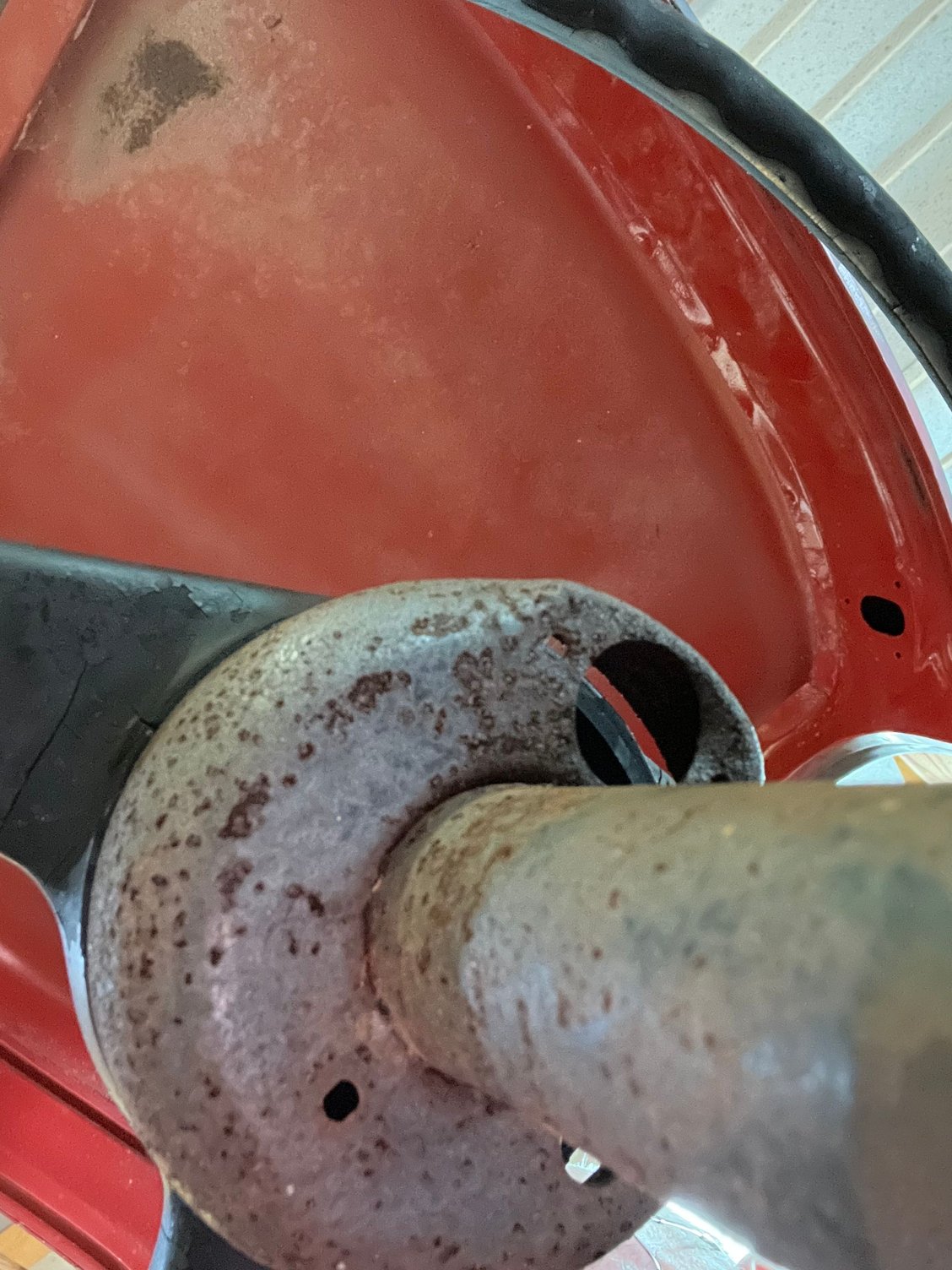

I simply cannot get the wheel of the '53 off the column to repair the cracks. The horn button was off for 30 years and I'm sure it's rusted on the spline. I've soaked it in WD-40, tried (and broke) several types of gear pullers, no joy. I tried hammering the backside using a punch thru the holes in the metal "cup" attached to the column on the underside of the wheel. I was going to use a bearing splitter like I saw in one thread, but the metal cup is in the way. Is it just spot welded on? How would I remove it to give clearance for the splitter?

Just me, but I would ditch the WD40 on this job and go with PB Blaster. At least for me it works much, much better. Liberally spray that, let it sit overnight. You may want to chase the threads of the holes in the steering wheel to clean them out good. Put on another steering wheel puller and tighten it down good, smack the puller bolt head with a hammer, tighten down the bolt head again, smack with hammer, etc. This may be a job that takes a day or two as you are repeating the cycle of spraying. tightening , smacking with hammer, then letting it sit for a few hours and repeat the cycle again. Leaving the puller tightened again.
As far as the bell under the steering wheel. I don't know if it's removable. It's part of the steering column.
Just another tip. Leave the steering wheel nut on the end of the shaft when doing all of this to protect the shafts' end.

Thanks, I do have some PB Blaster and will use it. I'll have to find another puller, I literally broke 2 of the ones I used. Biggest issue is that the two threaded holes in the steering wheel are so close together it's hard to find an H type puller that aligns.

One thing I should mention- when I pulled my wheel off 1st time I belled out the tube- you don't want to do that! It's hard to get it straightened out. Put the nut back on loose so it is flat with the tube and use a washer so the cone of the puller pushes on the washer and nut. Then after it pops loose take off washer and nut and wheel should come off. I don't remember it being on super hard, my normal universal wheel puller worked- but as I said, I did mess up end of hollow tube. Let us know how it goes!
