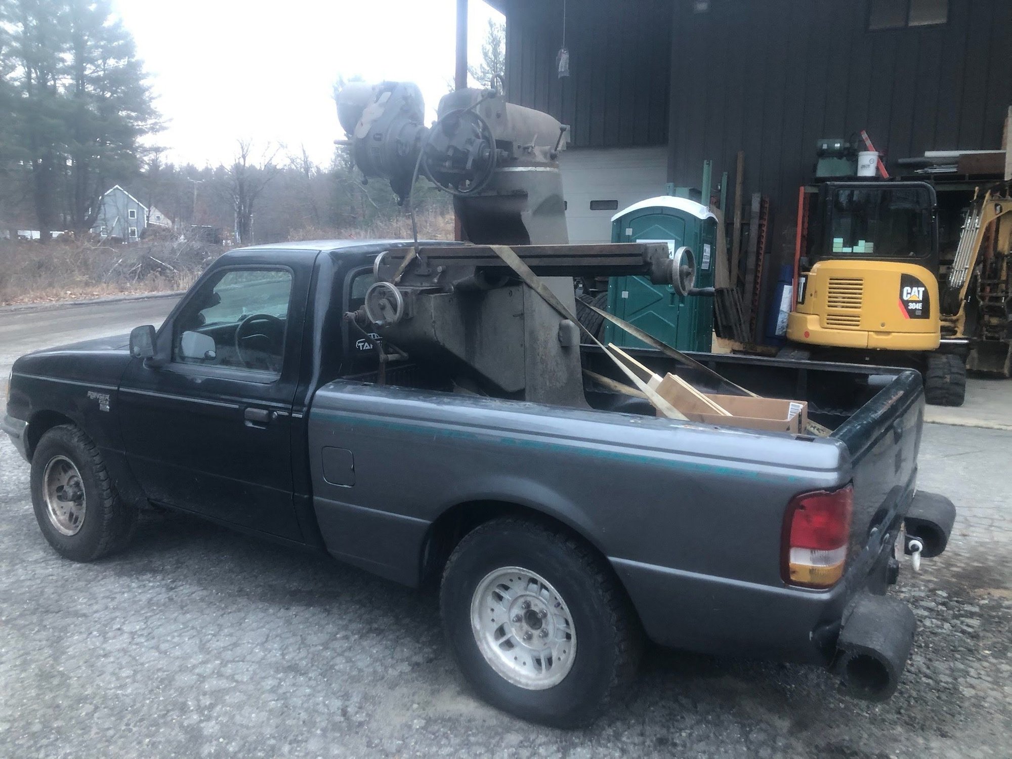

Yesterday's load. ~50mi of local and highway driving though no big grade descents. Rotors are fine. This is the 3rd time I've moved one of these like this.
Originally Posted by xlt4wd90
No "farmer shenanigans", whatever that is. Again, my extended length AWD van probably outweighs your shorty by about 500
pounds.
Which brings it up to the same tare weight as the pictured Ranger.

The Ranger weighs 400lb more per the local cat scale. 3900 for the Ranger. 34xx for the Aerostar. I can dig up weight tickets for both. Same driver, similar compliment of tools onboard.
