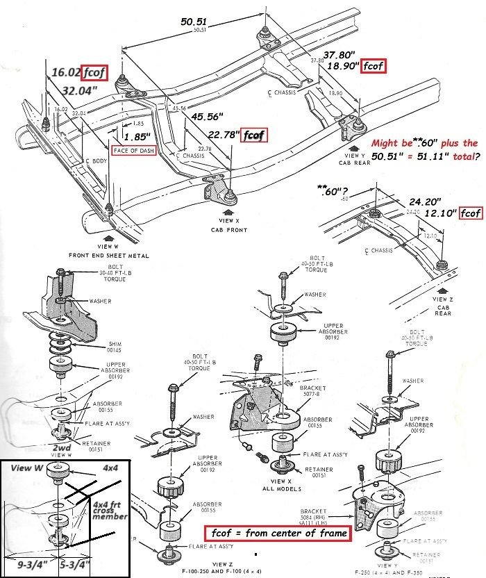

I have a '77 F-150, the rear cab mounts on mine are inside the frame rails @ 24.20" apart. I do not recall there being holes in my cab for the rear cab mounts out side the frame @ 37.80" apart.

Likes: 5,796

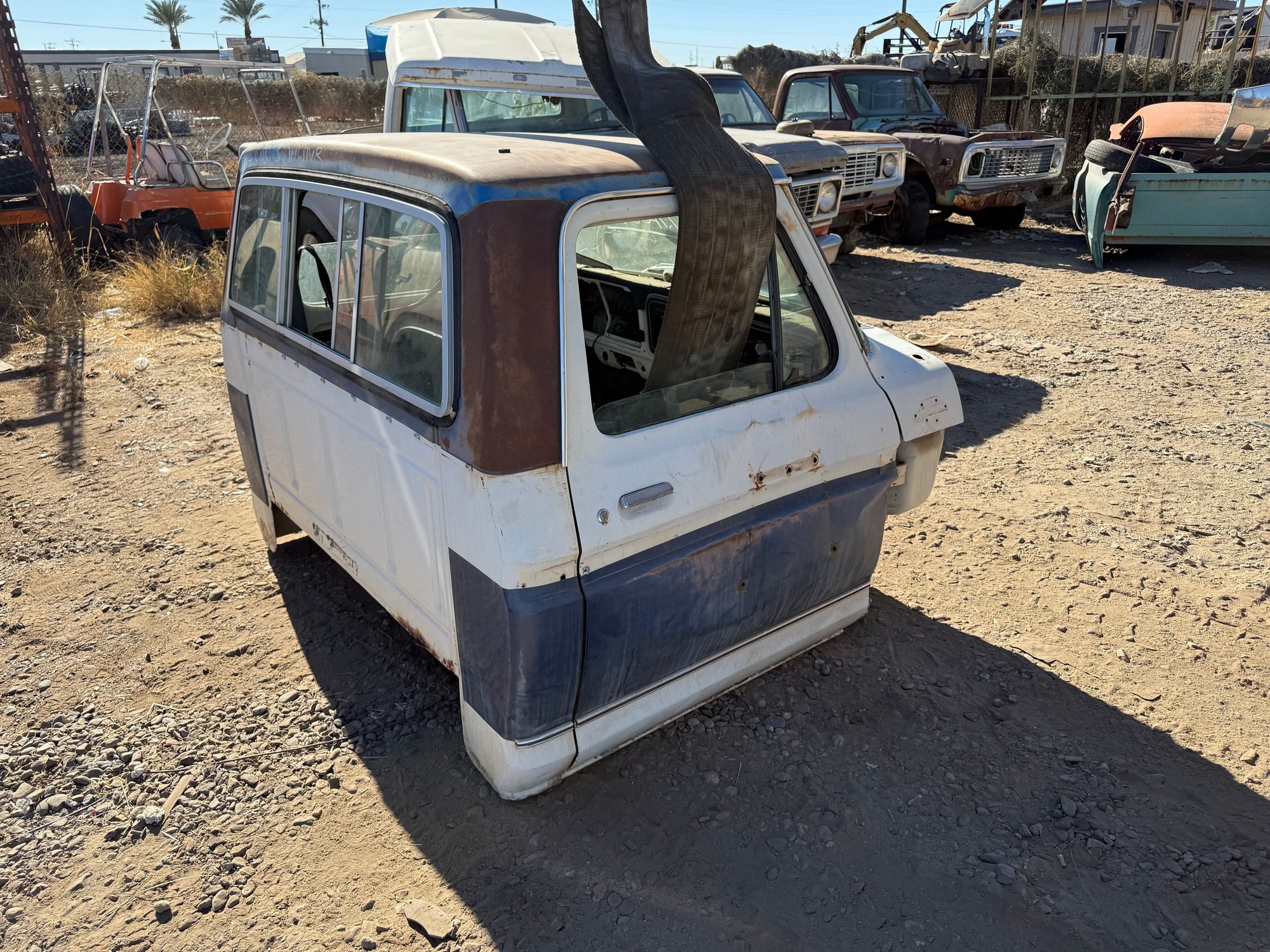

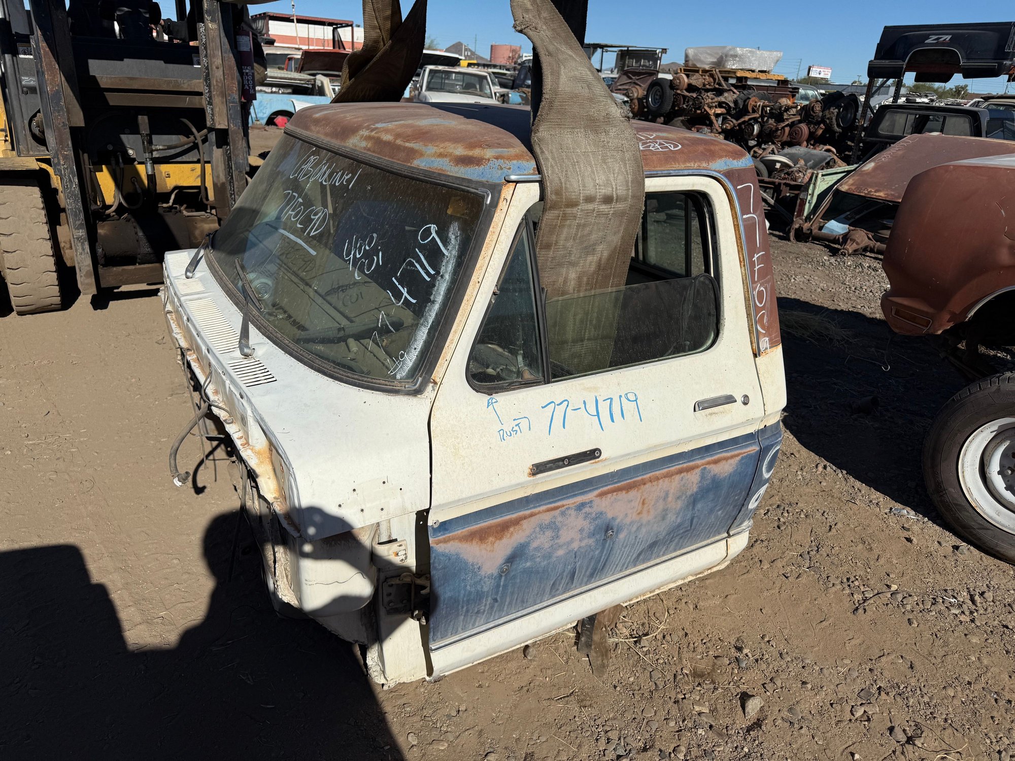

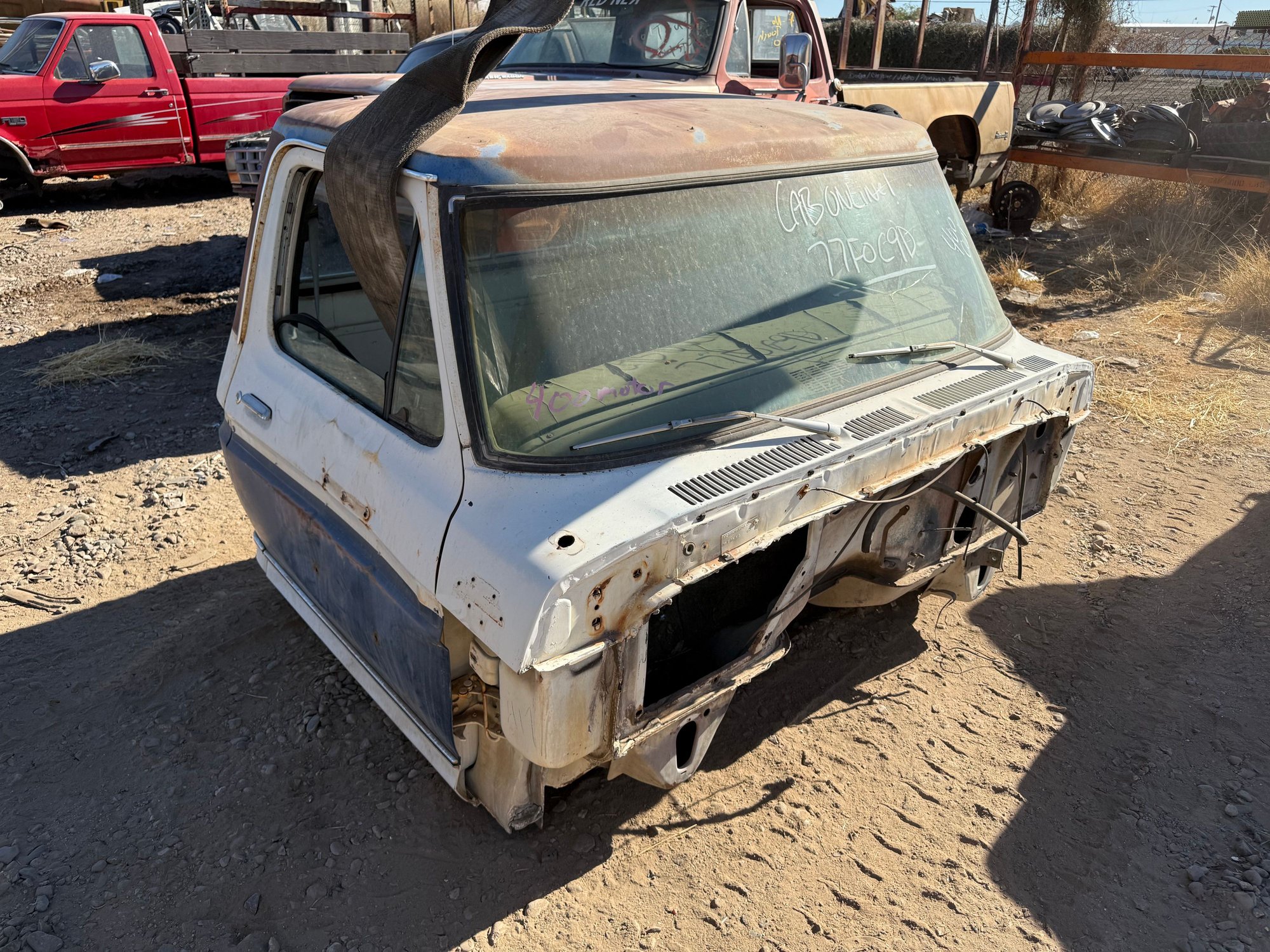

Thanks! Picked up a nice ‘77 cab today. Also got a short bed, tailgate, inner fenders and core support - all at Desert Vally Auto Parts. Great team there.
