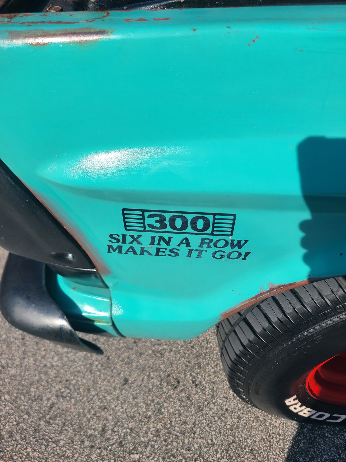

Originally Posted by atitagain4
I have a couple engines over 400hp in different classic vehicles so I wanted to try the famous 300. If I don’t like it, I have a 70’s 302 roller engine with stock bore in the garage I can do a simple 275-300hp build for cheap.
Saw this at a recent car show.
I like that!! I have a Cummins and always say, 6 in a row ready to tow lol.
