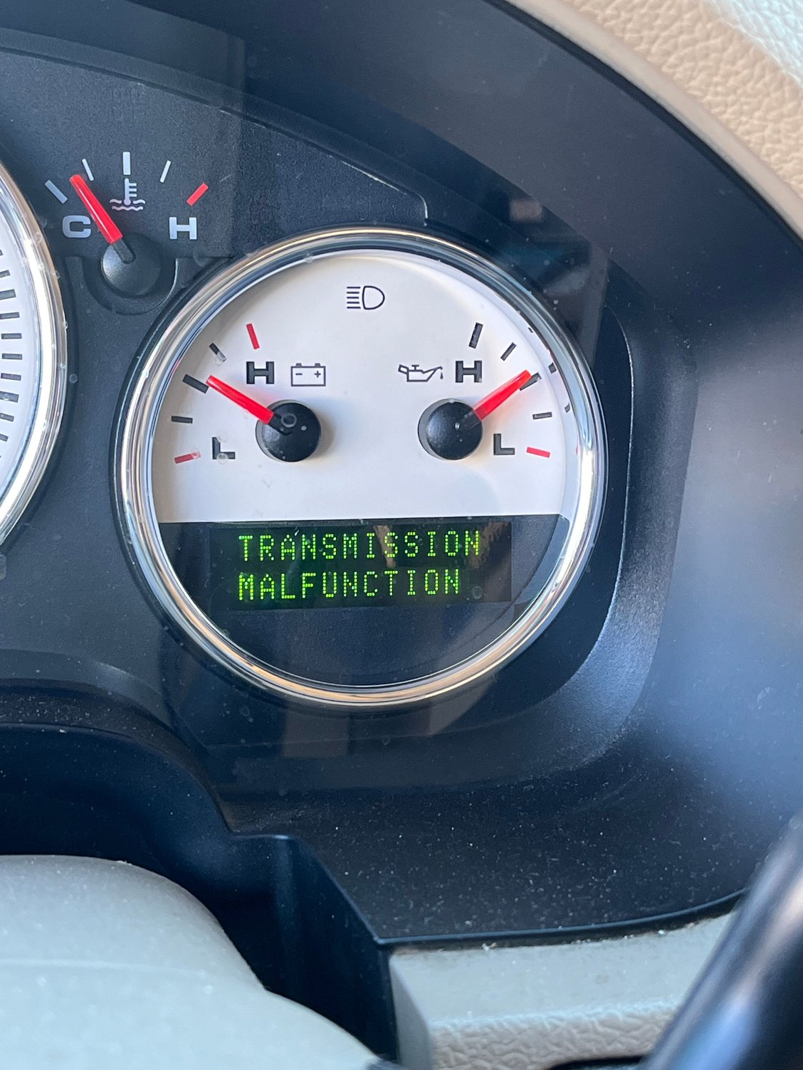

Update: transmission malfunction, and flashing overdrive light. Just dropped it off at the transmission shop.
