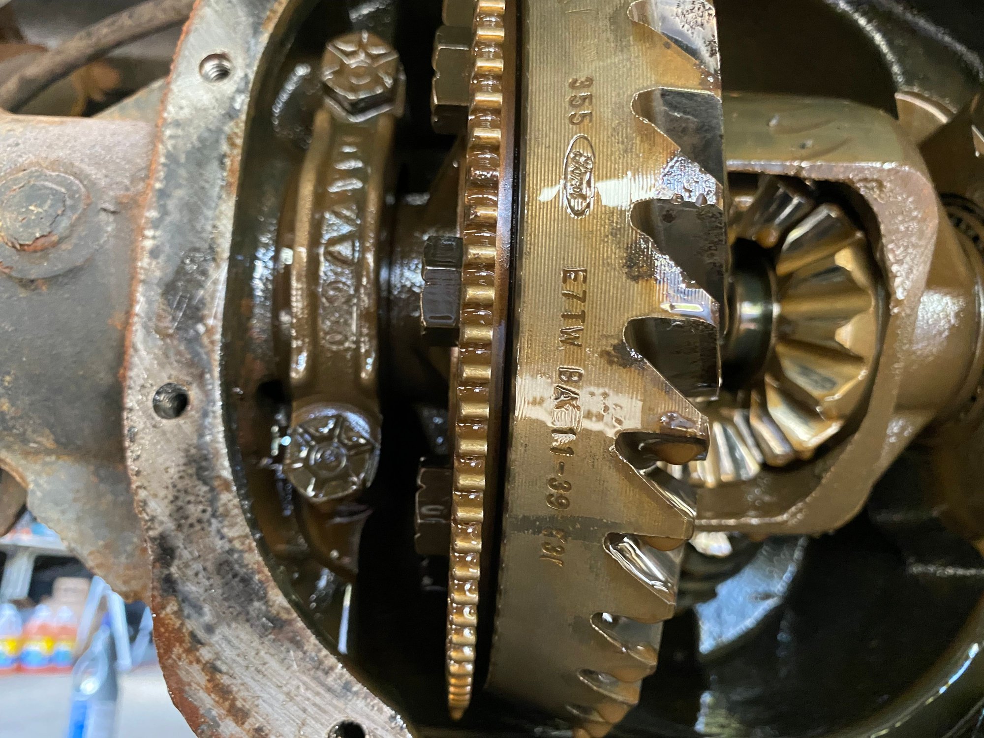

So I had the transmission replaced by a reputable guy, I don’t think it’s exactly a transmission problem. Trans fluid is fine, but the rear end could use replacing sometime (the unit not fluid) soon, as the previous owner let the rear end run dry due which has caused some damage to the gears.
but when I seem to do 5%-10% input throttle from the gas pedal, the truck feels like it gets pulled backwards, about every other second, (almost like the rear end isn’t catching?) but if I give it more throttle it’s fine.
It’ll just do it, if I’m driving at the same throttle input, it’ll just happen between that 5%-10% input area.
It’s a bit violent, and I don’t want to destroy anything accidentally
someone I talked to in person said it may be snake biting, not sure what the term really means.
The gears look fine to me too.
What was the transmission doing that it required replacement of hard parts? Was there slipping or something inside broke? That fact that it does strange things based on throttle position seems like a bad TPS input to the PCM. Does it feel like the transmission is going into neutral and slamming back into gear?
