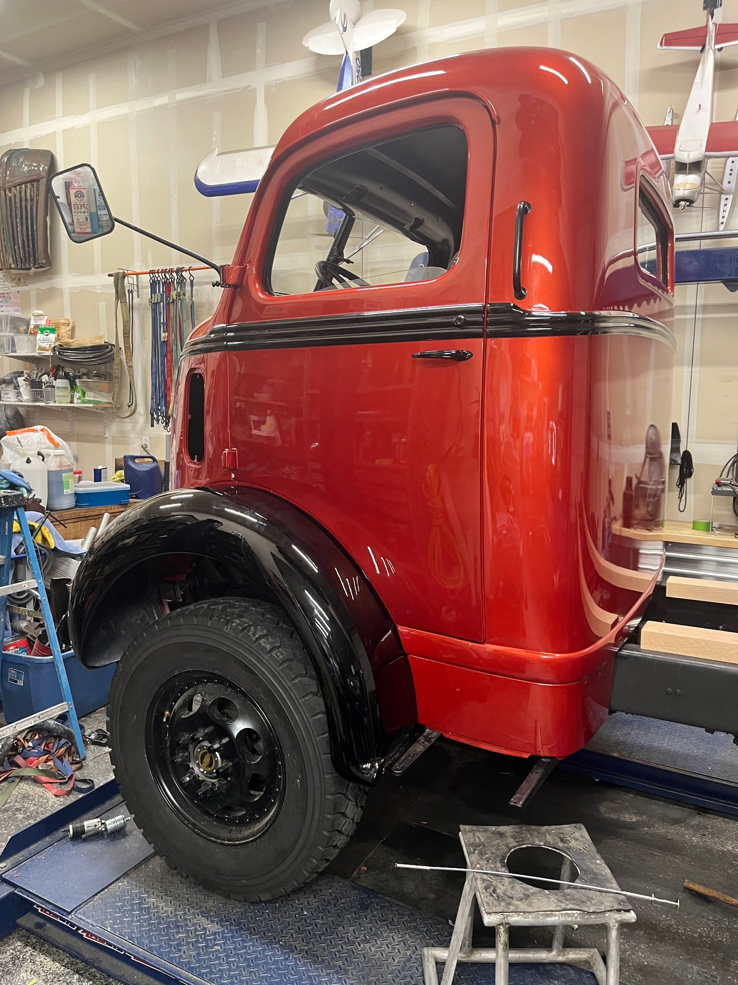

Beautiful job on that truck! Love the 4wd and the period way you have accomplished it. The mounting of the transfer case is supurb, thanks for not slamming it down on 22s with low, low profile tires. Full side view pics please!

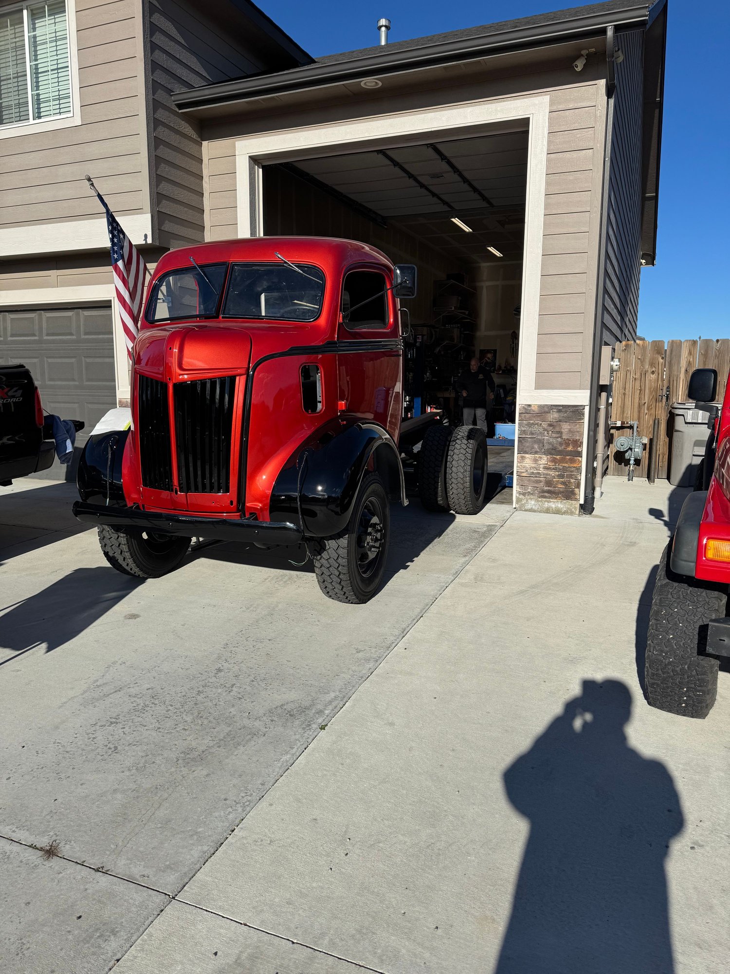

Thanks for the kind words. It’s been a long project, consequently I’ve had a lot of time to plan and figure out what my end game needed to be. The truck was too original to make a street machine. Ultimately I haven’t had a truck that sits this tall in a long time and there’s some appeal to that for me. These days I appreciate things that are more factory than not.
i don’t have a side view picture with the truck in it’s current color but hopefully this will suffice.

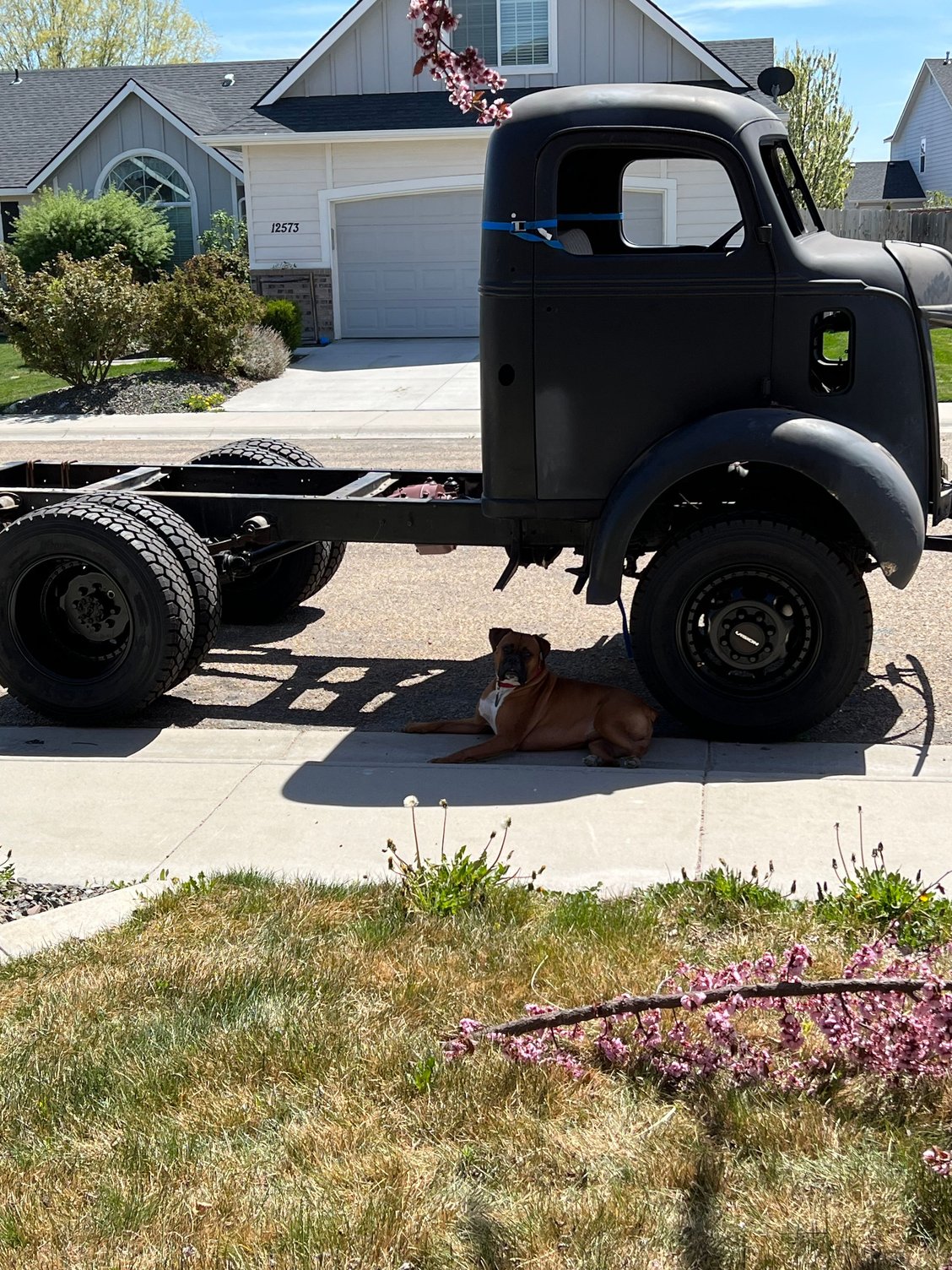

Looks like your dog approves
Nooch always finds the best shaded spot.

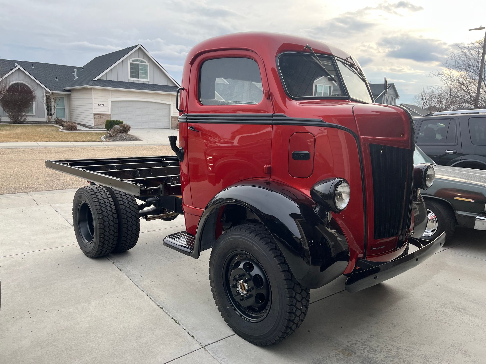

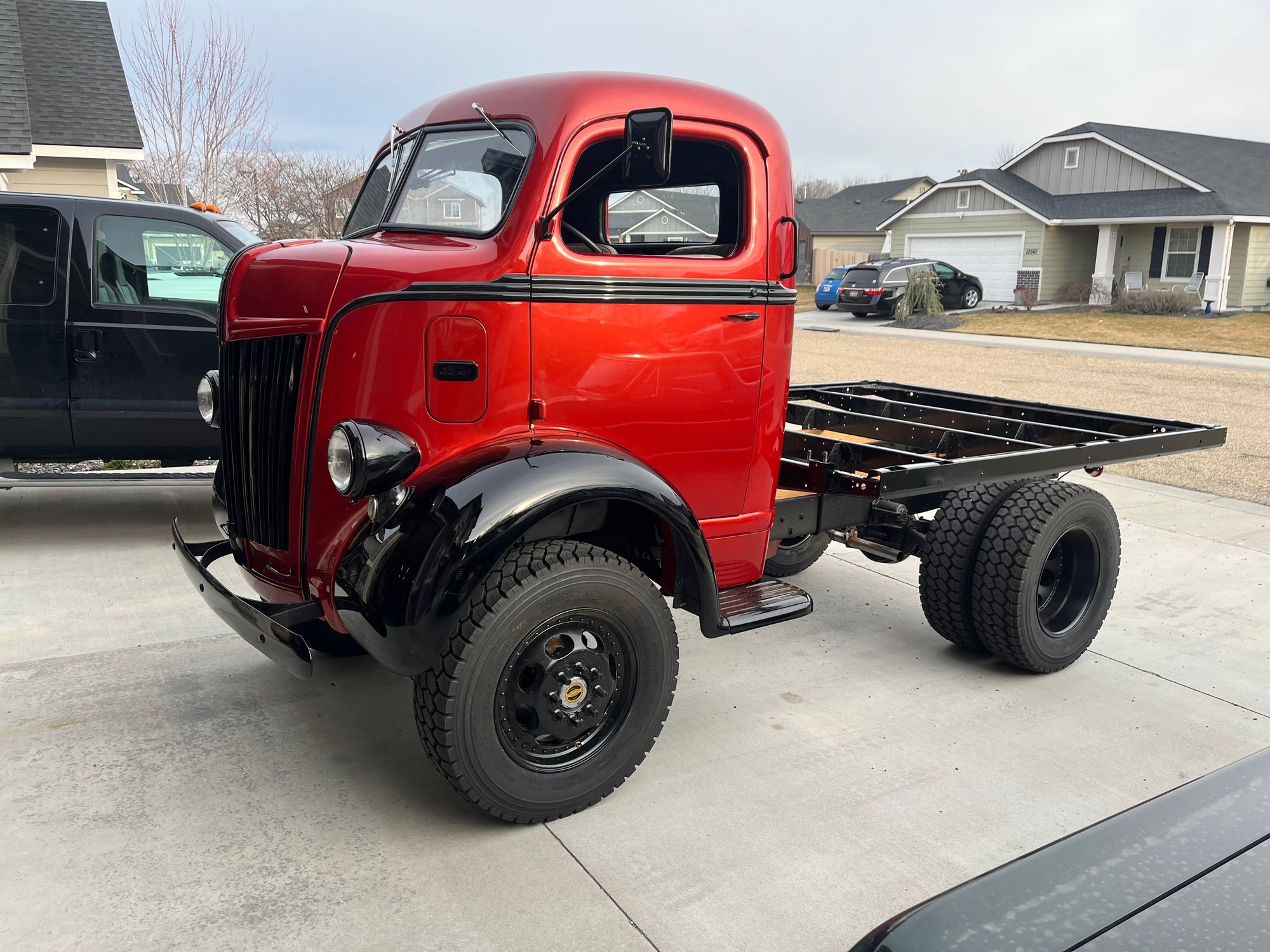

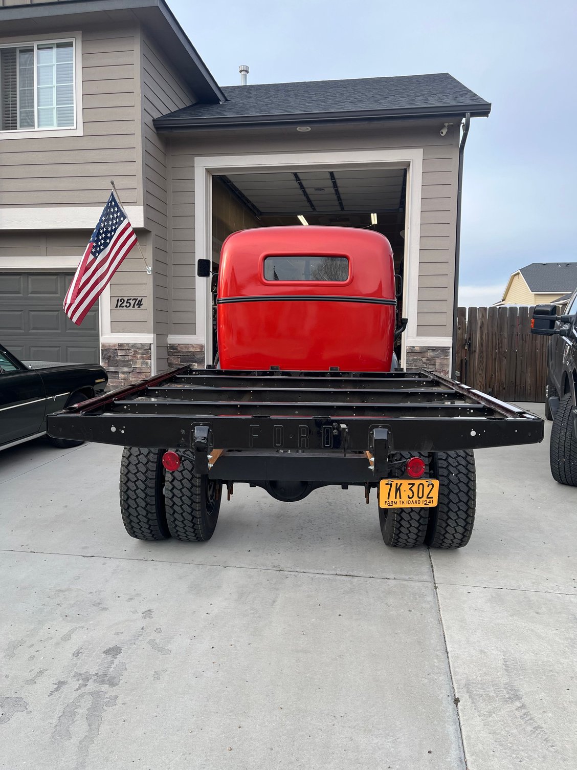

Some recent pictures.

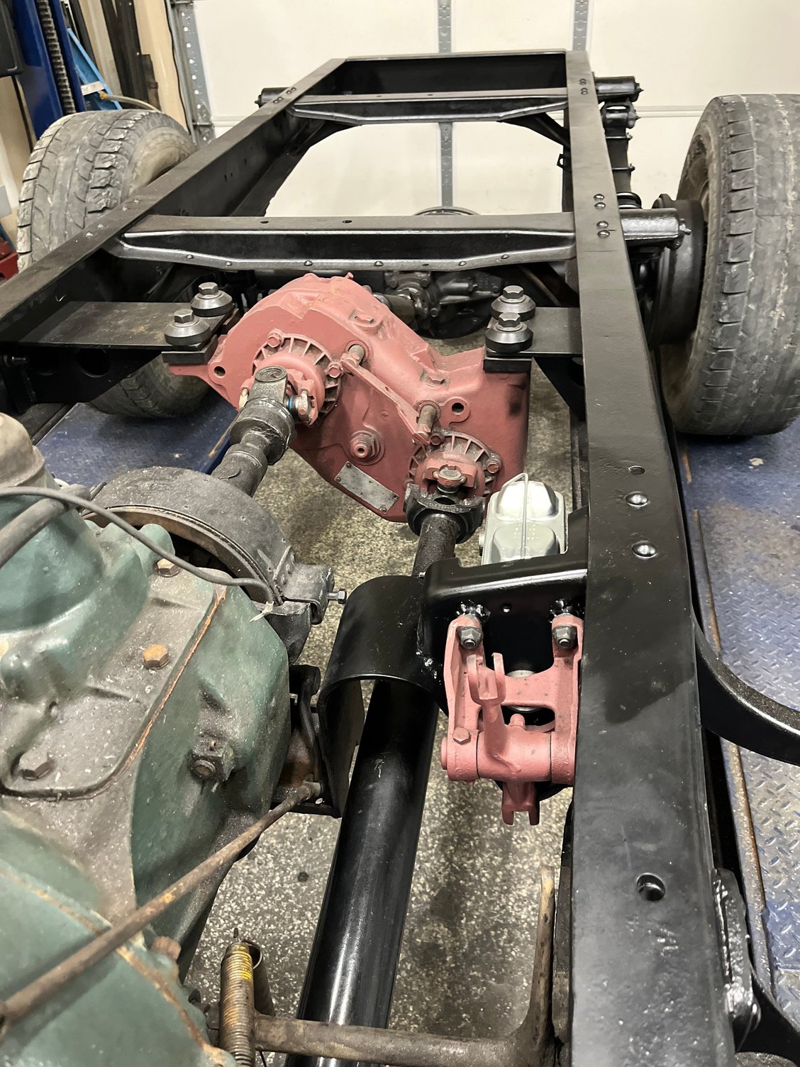

Really cool truck. When I built my 48 COE, I did the twin stick conversion and used 2 cables from a driveline shop, that are like a PTO cable, only better quality and smoother action. Can you hang a bracket down from the bed and attach a cable with a clevis pin to the bar between your shift rails. Mount the other end, anywhere you want with a tab and put some sort of **** on it. PTO cables or something similar are like 10' long. I don't have a picture of the mount, but I do of the other end. It's from during the build process.

Twin stick transfer case shifters, parking brake handle
