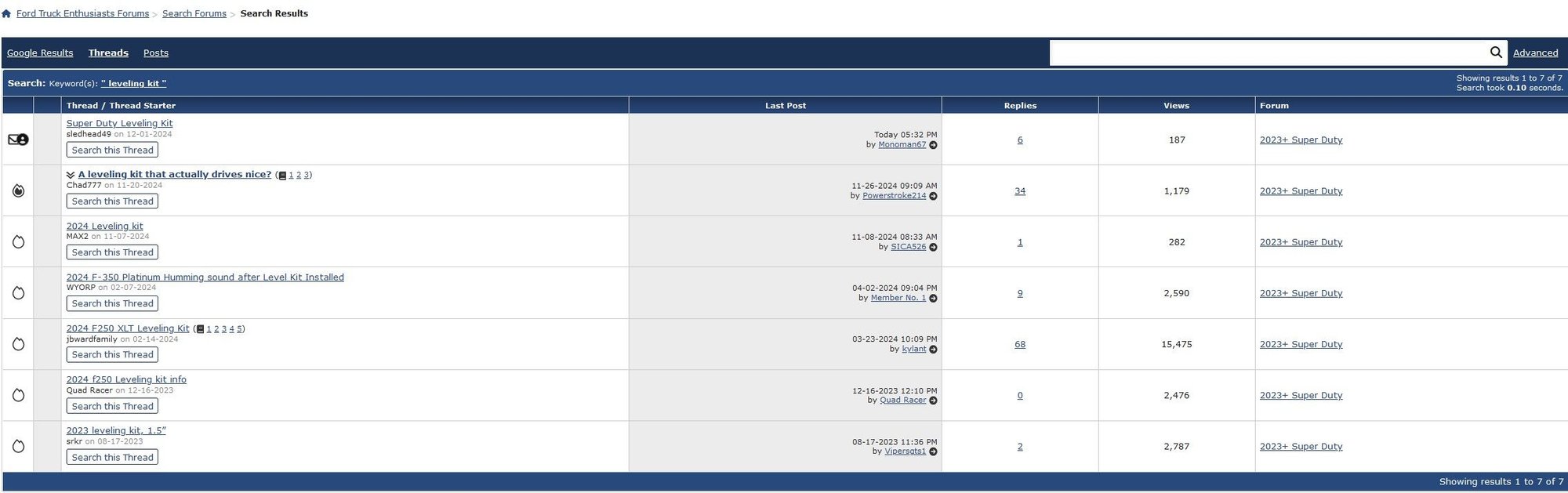

It must be a forum feature since the link returns zero results for me now too.

A search for "leveling kit" in the subject of threads for the 2023+ section returns some hits but I guess I can't share the search results.
