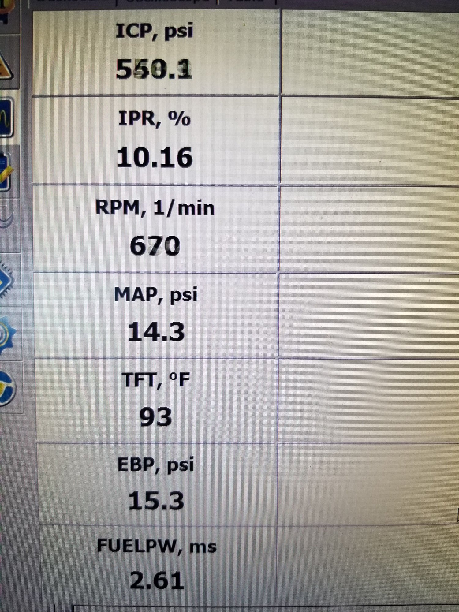

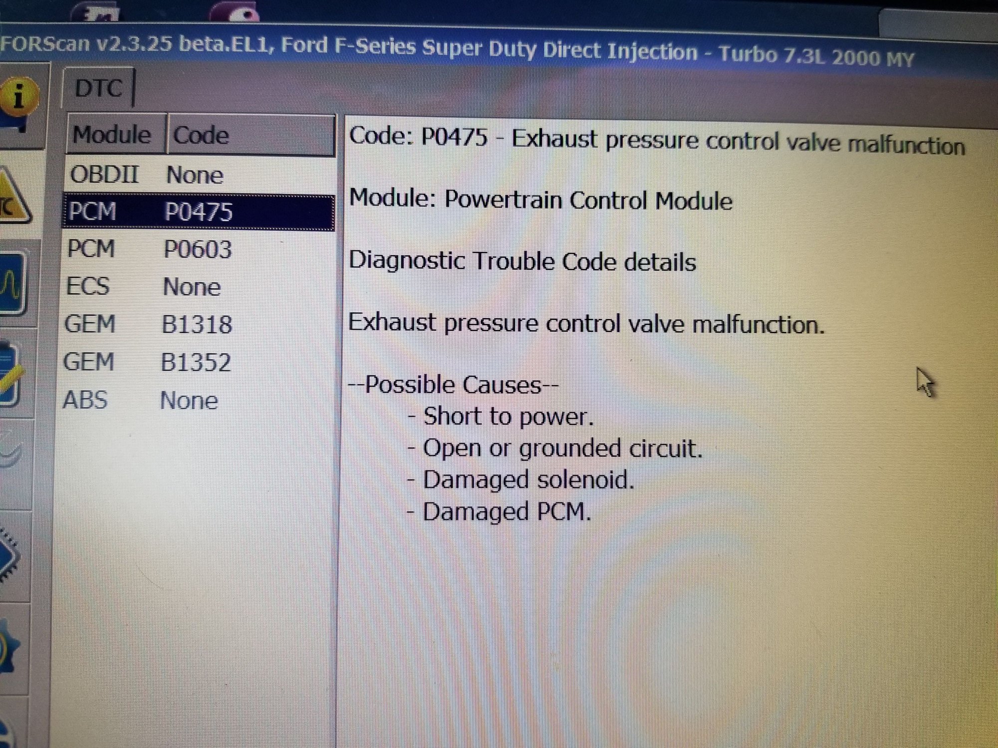

I put the truck back to stock and hooked up Forscan yesterday and nothing stood out. The day prior I disconnected the ICP after startup when the engine was cold and I get the bump in rpms like expected. I took it out and ran it through the gears and it comes back to a couple hundred rpm higher idle and the engine cackling not happy. I was unable to get some information running down the road given the battery on the laptop went caput. While I was loading the tune back in the truck I noticed the fuel pump making some racket...it's a Bosch pump, but been in there for years...so you may be on to something. I have a new in the box Bosch pump and a Diesel o-rings fuel bowl rebuild kit with fuel pressure adapters sitting here on my desk that I'll get into over the weekend...I've been putting it off thinking my problem was a boost leak. I just rebuilt the fuel bowl on the Excursion which also has the stand pipe gutted, so I'll plan on doing that too while in there...
...from EBP valve delete...
...taken when engine cold...
...taken when engine warmed up a bit...weird that the coolant temperature started at 32* (it's probably mid to high 80's) and took some time to get here though the truck was up to operating temperature...
