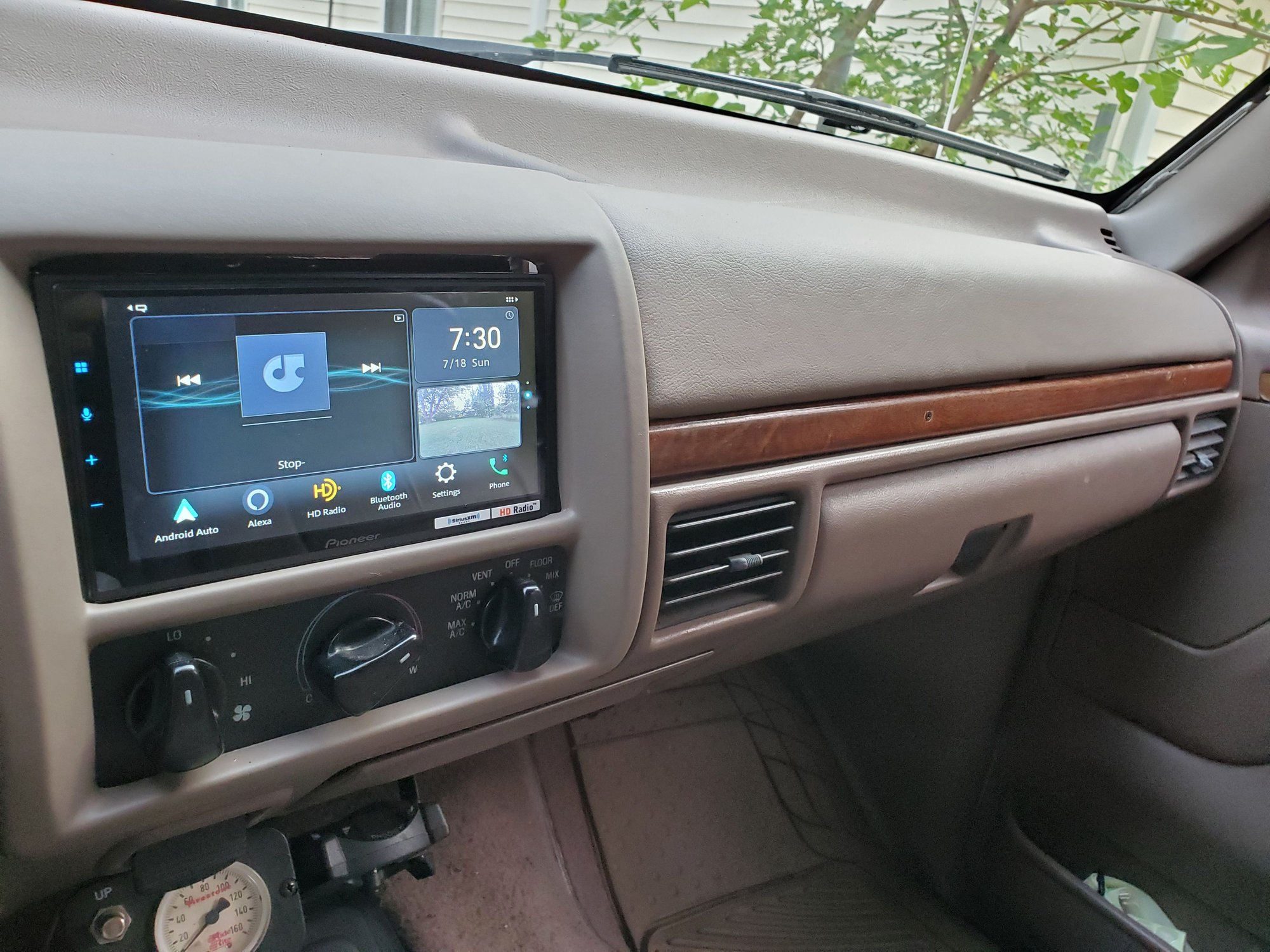

Does everything I need it to. Have it wired to show backup cam in corner nornally, which goes full screen when in reverse.
I had thought of using a floating monitor, but our dash bumps out to the left and i have a manual which made me afraid id punch the dash.
Now that i have a short shifter and s bend handle, I may consider a floating unit if this ever needs replaced.

Looks good, but that must have required mods to the dash?

Fell right in.
Just kidding. Yes it does require removing the brace and moving a few things.
I used an OBS Interiors kit.
https://www.obsinteriors.com/dash-kit-conversions
I've had this kit installed for about almost 4 years now. With no issues. I also ride on very stiff 10 lug wheels with tires meant for a dump truck, meaning my truck dies not ride like a Cadillac. So if my dash hasn't fallen out/broken on my jalopy, I'd imagine it'd be fine in anyone else's too.
