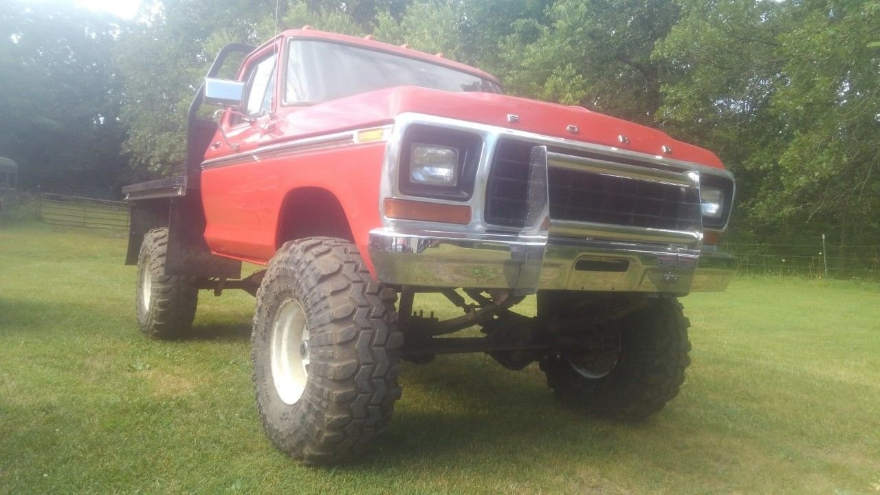

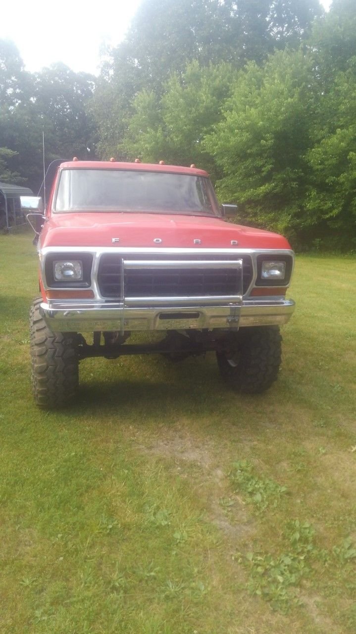

I am pretty sure a High Boy truck front bumper mounts with brackets.
I like a 78/79 slit bumper on a 79.
And now it has black spoke rims and 37's. I am not 100% on the wiping out the shell statement. I just remember on my 73 2wd I barely bumped an object and it folded the bumper tip right into my grill shell. I think the straighter face 78/79 might be a little bit more solid.

Yeah looks good with the right bumper.

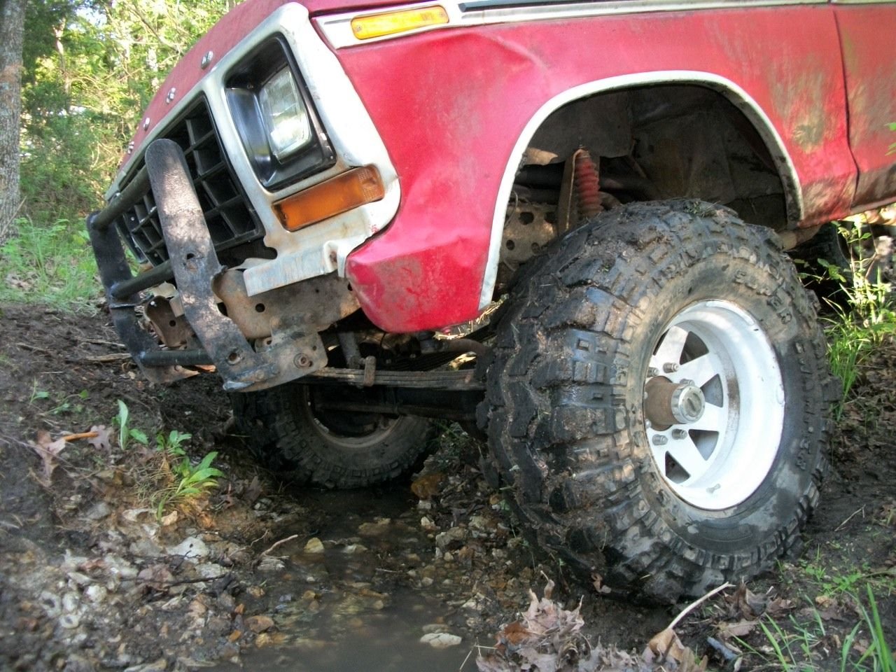

A serious pet peeve of mine is when you look down the top of your bumper and see a little horn sticking up because it love tapped something one day. Breaks up the eye too much for me.
I had that happen on my 73 Highboy the first time I let my little brother borrow it. I pulled it off and tried to straighten it but I was never able to shrink that steel back up and it drove me nuts lol. Do you guys think there is any way to reinforce the stock bumpers with maybe like a channeled gusset back tying into the frame?

How you avoid that.
