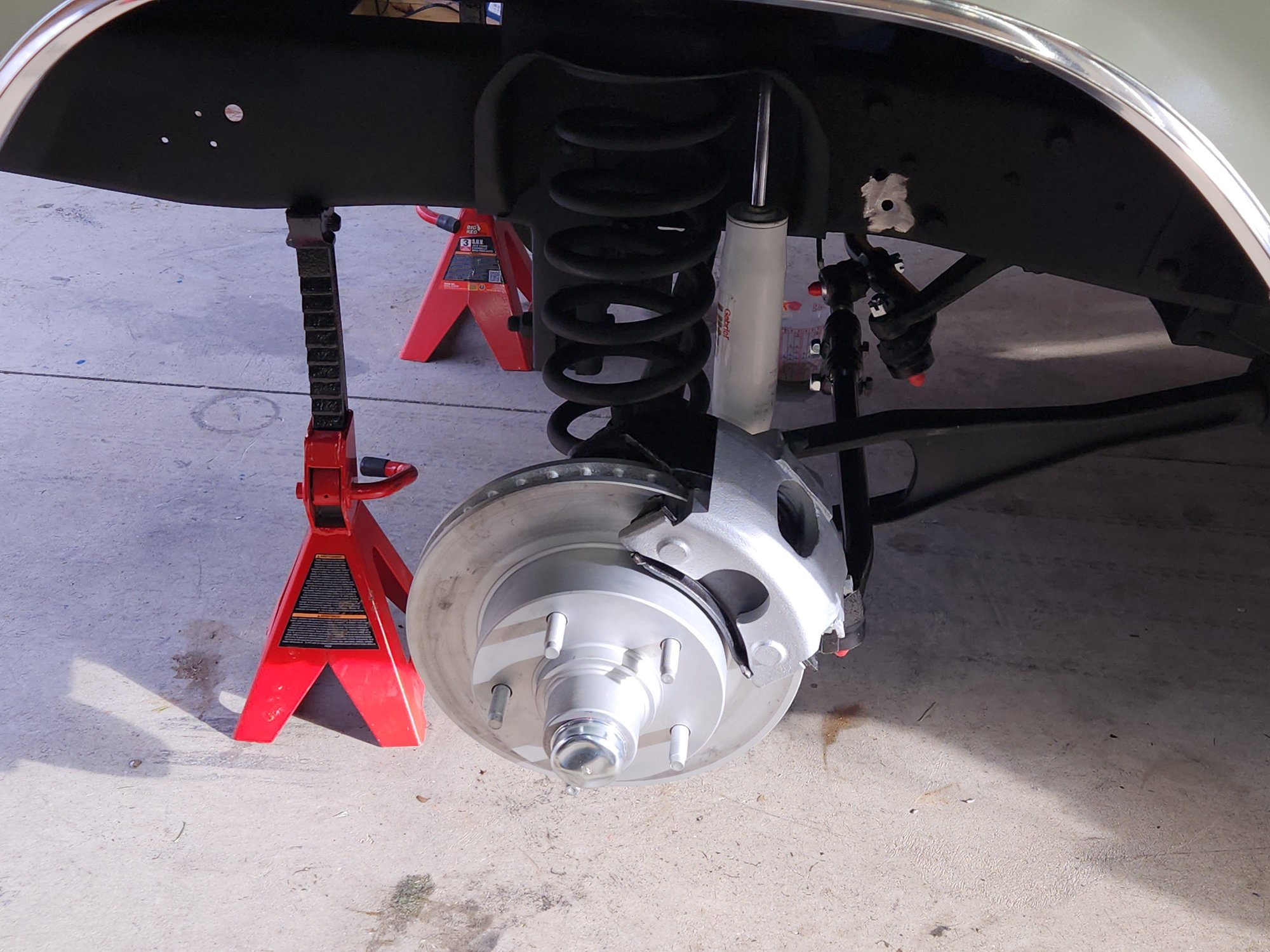

went 73 F100 swap with new spindles. working well sa far. still need to run new lines
