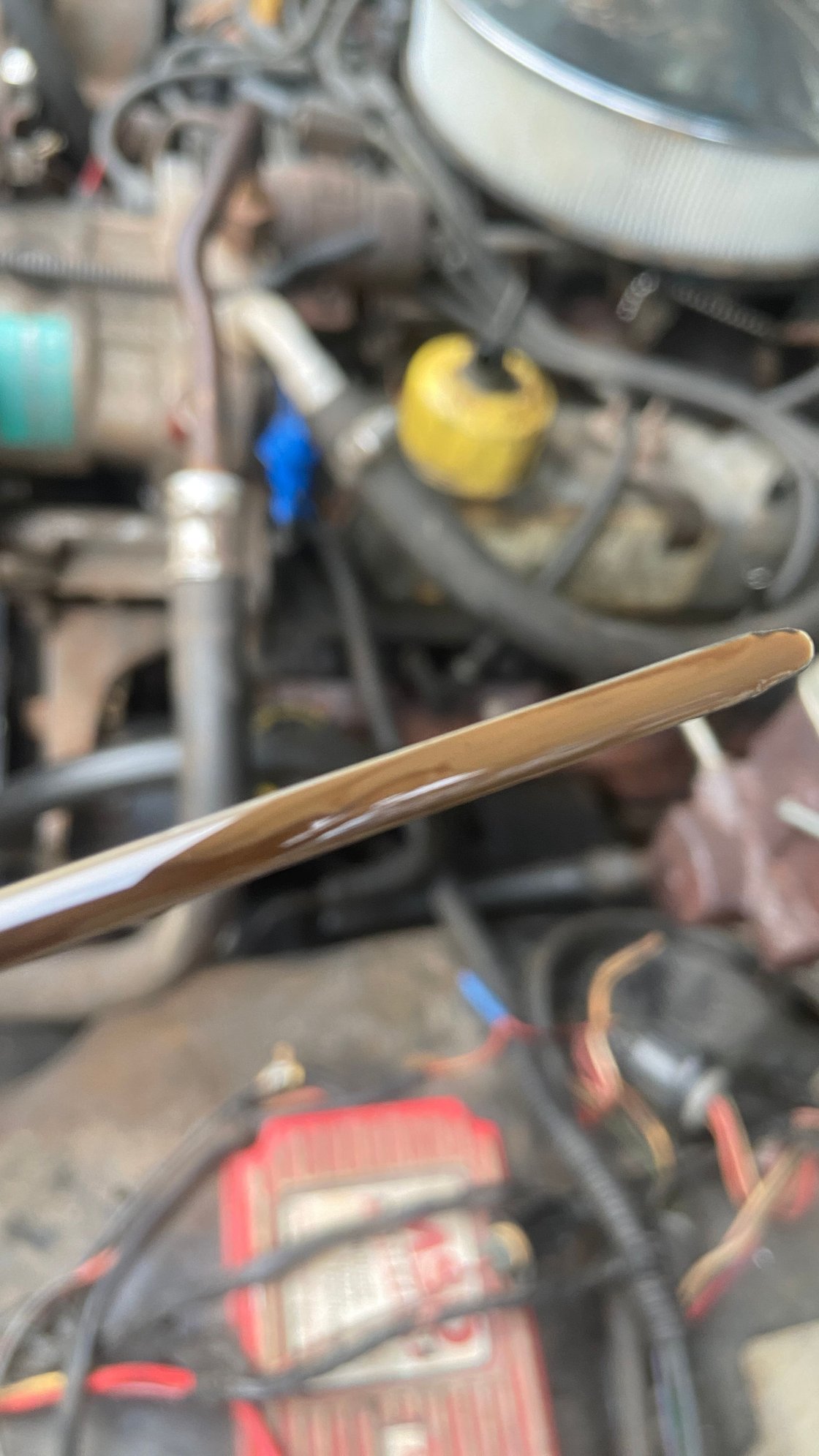

I thought the same thing regarding the oil cap. I've had that happen on plenty of other cars that I just drive short mileage on. Also, I was confused because I've never dealt with a bad head gasket where I didn't have either coolant leaking from the gasket and out of the engine, or a bubbling radiator. I also did the rubber glove test (all plugs removed, glove rubber banded to the radiator fill neck, look for air while also checking compression) and didn't see any air or gas coming out of the radiator. If anything it was sucking the glove into the radiator. Then the combustion gas test came back clean. The tester was barely pulling any gas into, just slight bubbles here and there. Didn't look like a fizzy soda or anything that I've on a bad one before.
However the dipstick sure is looking like a melted chocolate sundae that my daughter left out on the counter, minus the sprinkles.

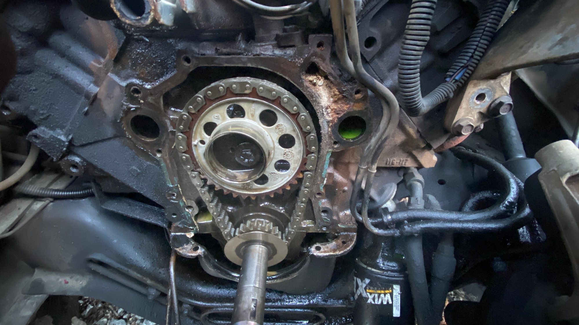

So, I'm pretty sure y'all are right and it's the timing cover that's leaking into the pan. Got the water pump off and there was a ton of crap built up between it and the plate, as well as on the timing cover. Under the timing cover there's also a ton of crap built up in all of the passages. Guessing it's that copper additive that the previous owner put in the radiator?
As for the timing cover itself; there are two bolts that hold the timing indicator (not sure if this is what it's called) over the harmonic balancer. On is 1/2" and the other is tiny, When I was removing the tiny one the head snapped right off. I imagine I can get the indicator back on there and to stay with the one complete bolt and what's leftover of the tiny one, but should I just replace the whole cover while I'm at it? They're not that expensive and I don't really want to get everything back together and then have to take it apart again.
Also, the timing chain has about 2" of play in it, so that's definitely gonna have to be replaced while the cover is off. Any recommendations on a specific chain?

On the timing cover do you see anywhere a crack or pin hole where coolant could of made it's way to the oil side?
I am also guessing that 1 small bolt that held the timing pointer is a threaded hole so a new cover and new bolt to fit should take care of that.
Look over all the timing cover bolts and if any show pitting / rust I would replace them with new.
So being not much money for a new cover and what you see I would replace it.
As for the timing chain I am seeing a plastic cam gear so it is either factory or someone replaced it with a factory type not the best way to go in my book.
Also am I seeing some missing teeth at the 2:30 - 3 o clock place? Either way with the play you say it has should be replaced being you are there.
You are looking for a full roller type chain. I also hear that the 80's chain gear set is re-tarted for smog so you may want to go with one from maybe the late 70's?
If I am off on any of this I am sure someone will say so.

Thanks for the info. No crack as far as I can see in the timing cover, but I went ahead and ordered a replacement when I was ordering everything else. With the amount of corrosion and buildup where there should not have been coolant, I think it's certain that water was making its way into the pan from behind the timing cover. I also ordered a set of stainless bolts for the water pump/timing cover. The black oxide ones that were in there had a ton of corrosion on them. Especially the two that go into the water jacket.
I don't think there are any missing teeth on the cam gear, maybe it just looks that way in the picture. I just went and checked and the gear has a Ford logo imprinted on it as well at 1984 casting marks, so I'm assuming it's original. I think the discoloration is from the chain riding on that part of the gear. I also ordered a replacement chain. As for swapping out the chain, as long as I line up the two dots on the gears at TDC, I should just be able to pull off the gears, swap the chain, and replace, correct?
