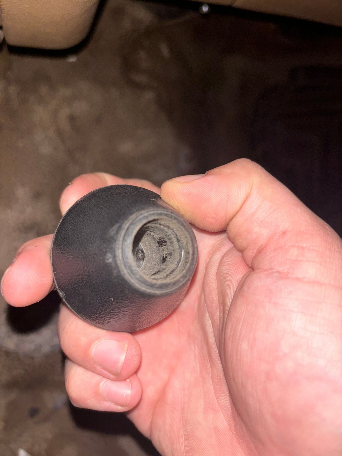

Hey y’all, I’m wanting to get a new custom shift **** for my 87 f150 4x4. The problem is I don’t know what type of adapter I need, I’m not even sure what to call this. The **** it came with doesn’t even fit on it, it just sits and spins. Can someone tell me what adapter I need? Pictures of the stick are attached.
The **** is press fit. Someone probably removed it and then it does not fit properly the next time without doing the suggestions in the previous posts.

on my 87 i got either a 1/2 or 3/4 (dont remember the size) all thread coupler and threaded the shift lever to match the thread. then put a pistol grip shifter out of one of my old big rigs on it.
did the same to the trans shifter and had a t handle on that one.

You can do as mentioned above, or you could replace the shifter lever with one that comes pre threaded.
https://www.dieselsanddirtbags.com/p...r-case-shifter
I don't have any first hand experience with the transfer case shifter. But I intend to get one eventually to match the transmission shifter i had him make. Billet short shifter with an s bend handle for the zf5
You can always heat sheink the shaft if you wanted a black look instead of billet alunimum.
So there’s no adapter for it? I’d prefer an adapter so I have more options for shift *****.
No adapter just a new ****
And the heat gun method is the only way to install a OE Ford ****
You can thread the shaft
A buddy gave me a 1995 F150 he had threaded the shift **** on
He had a black cue ball threaded on there (looked like an 8 ball with the 8's drilled out)
Heating a n new **** on there is the easiest
There are a few prototype adapters floating around. I haven't test fit the ones I have on hand yet. But they do exist.
You can craft an adapter or cut threads onto the existing splines if you don't want to replace the shaft.

Right, if you thread the shaft with a die, you can use an adapter and any threaded **** you want
I see Hurst T shift handles on the transfer case levers sometimes
My buddy said it was easy to tap his M5OD shift lever on the truck he gifted me

or you could just mix up some epoxy glue, put it in the **** hole, and stick it on the shifter
