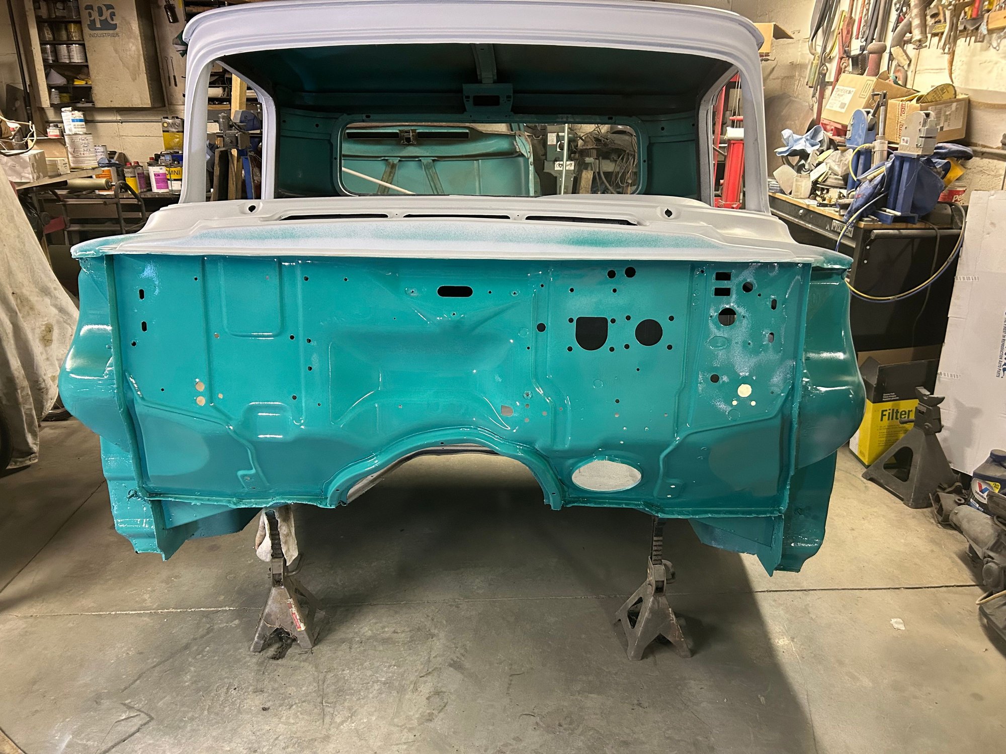

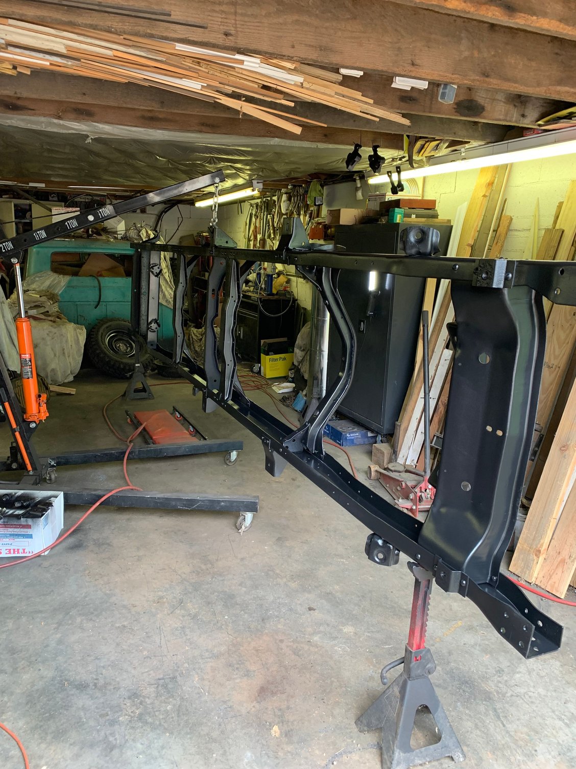

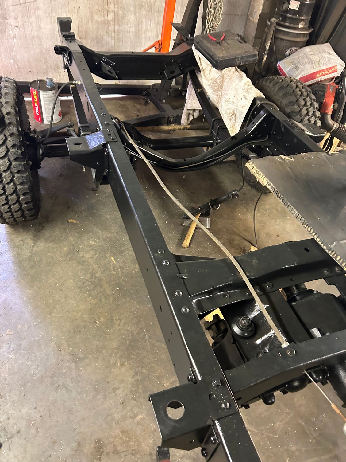

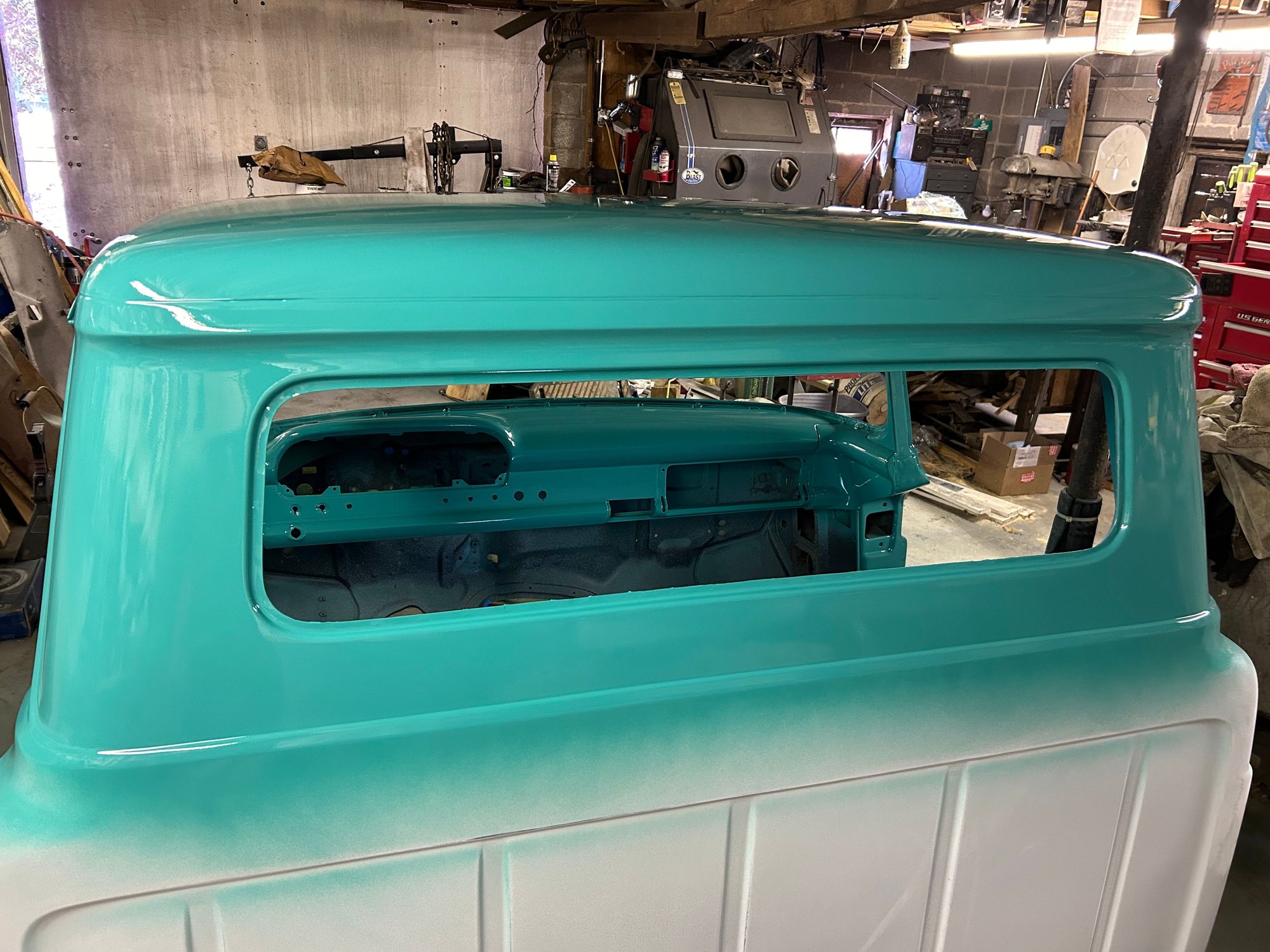

Ok back after a long delay. Was busy putting a basement under my house. However I tore apart my 60 F100 4x4 totally apart and now putting it back slowly. Frames been sand blasted and back together etc.

Well, welcome back. Looks like you are taking it pretty serious!

Yeah! Partly it’s was everywhere! I need it at least in one pile so if I need my shop I can use it. Trying to get the firewall and dash situated so I can slide the engine and tranny in it.

Glad to have you back, your truck and shop look great.

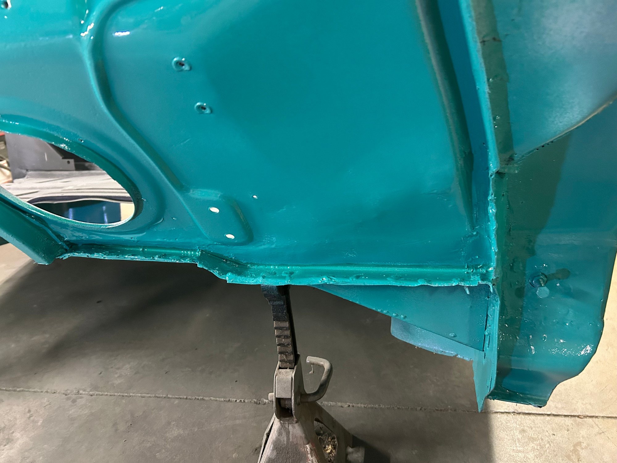

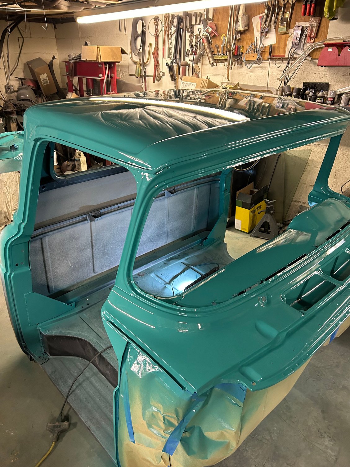

Looks great! Awesome work!

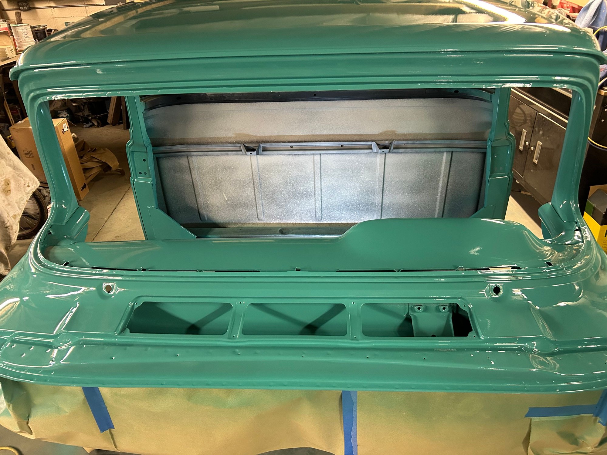

I know what colors those are and the paint codes, my question is:
What paint brand and product did you use?
Thanks,
Preston

Thanks! I use PPG single stage Omni. It’s PPG’s mid range product. The frame and such is ppg DP90lf epoxy primer that last coat or two I add some Omni single stage black to and gives it a tad of semigloss. Even though this is midrange it’s still spendy.

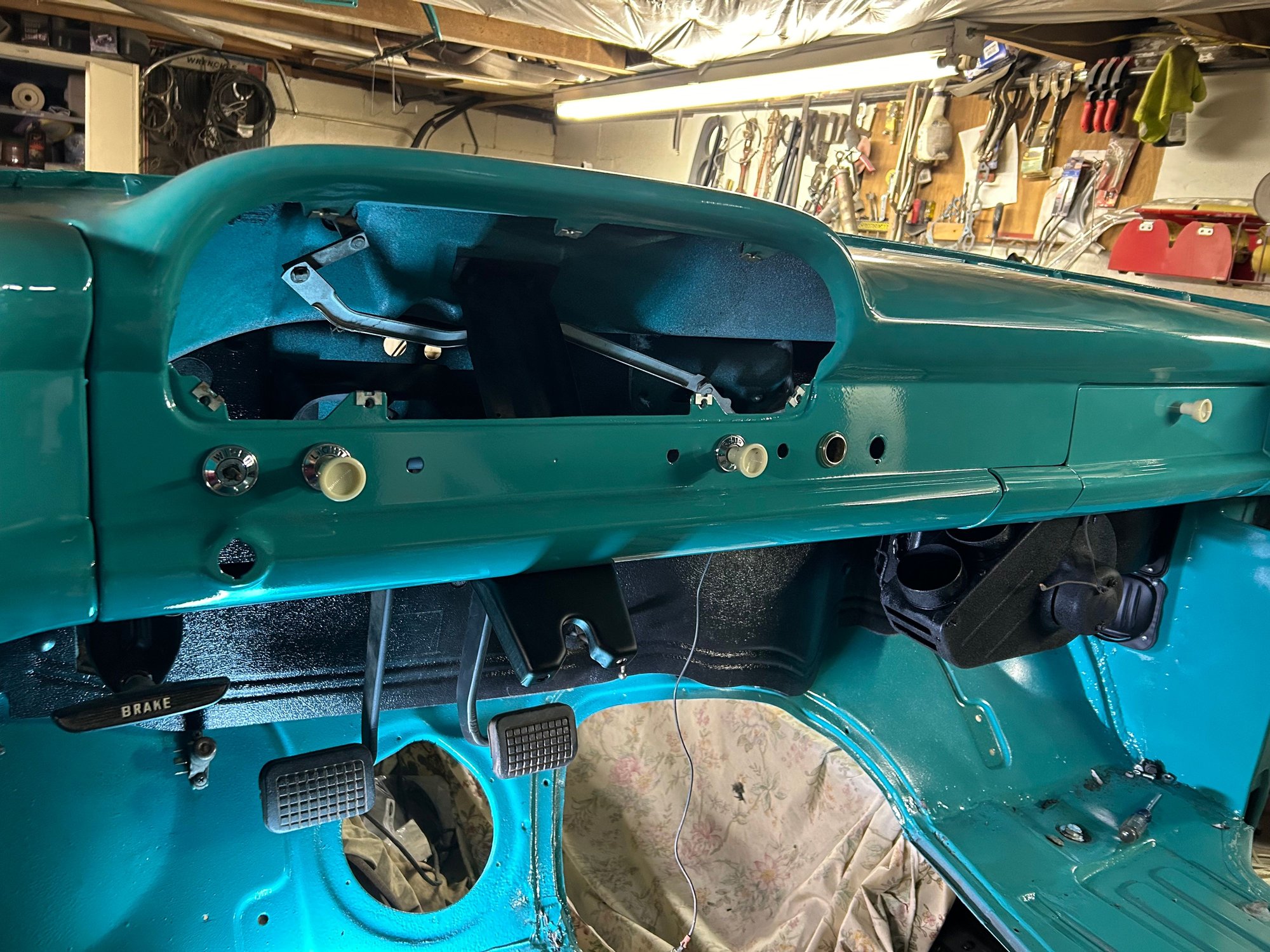

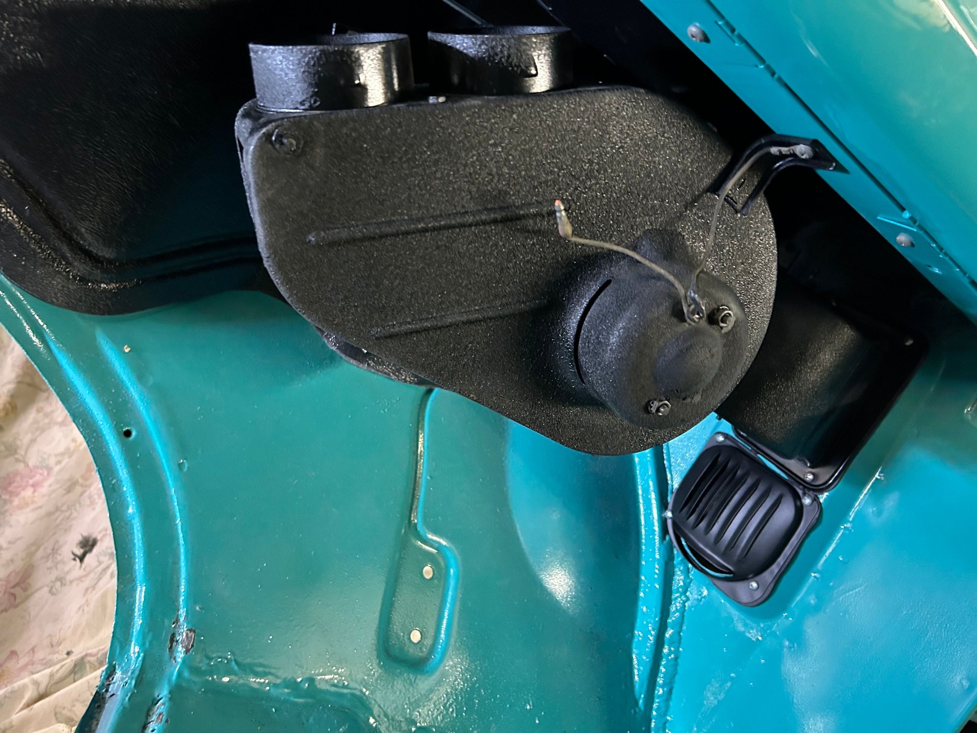

Got my heater core in, glove box door and box with new springs installed this afternoon.

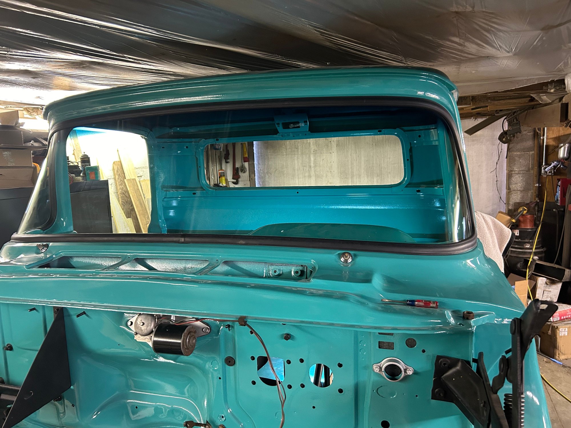

Windshield is in!
Ordered a new tinted windshield off eBay. Went in without a fight.
