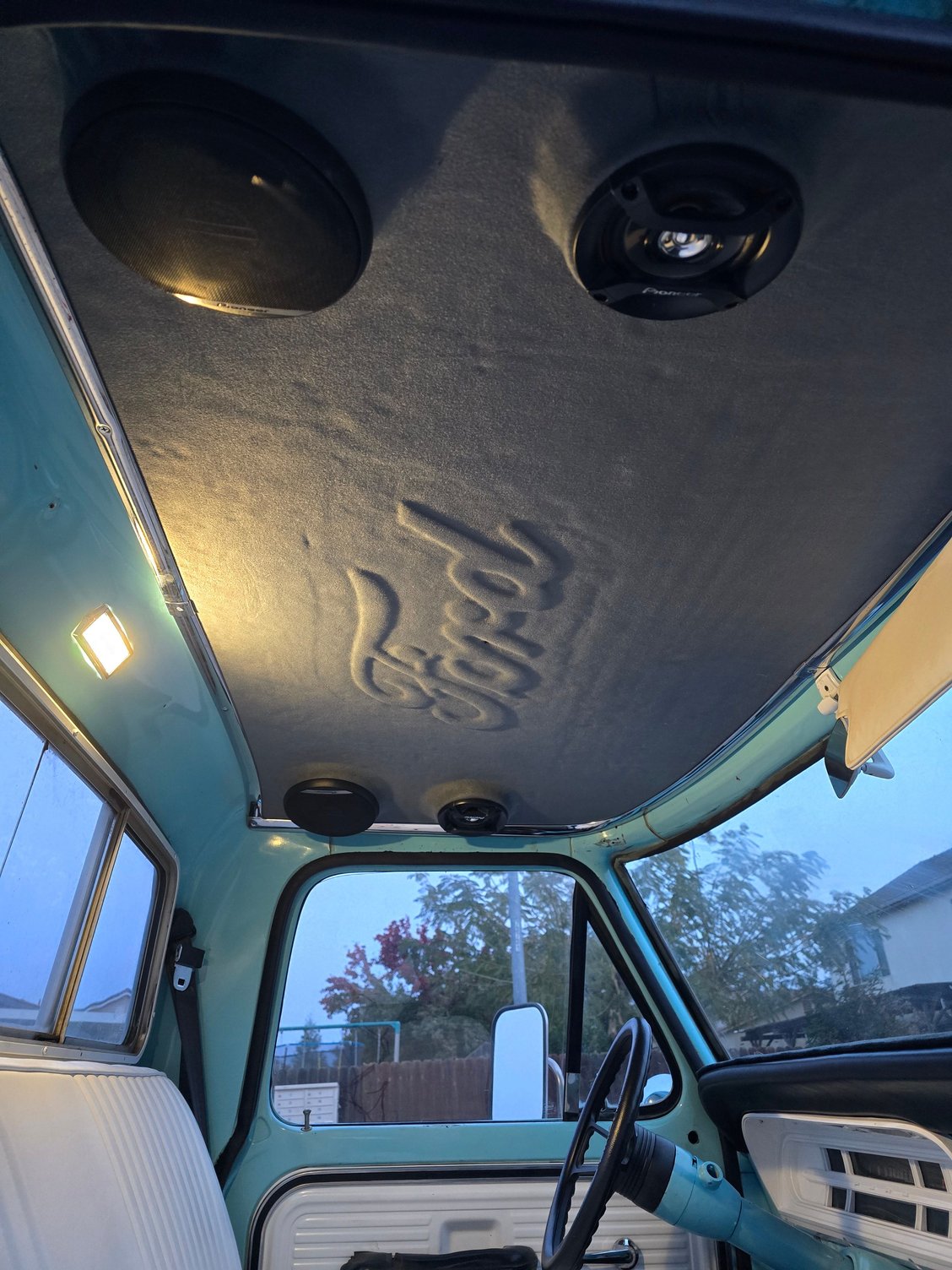

Weekend headliner
Just wanted to post my latest project. I didn't have a headliner before so I just found some measurements online and decided to make one with speaker pods in it. I just used a pressed board that is about 1/4 inch thick and added some 1/4 inch stock strips on back side to add rigidity. The embossing was just a wood cut out of the ford script.

Thank you. learned alot while doing it. I will redo eventually, I wasn't consistent with the pressure applied when rolling the fabric after it was glued and it left some waves in it. I thought it was just due to compressing the foam and it would bounce back but it didn't; i suppose the amount of glue I used could also cause this.

That's outstanding. Getting the shape of these headliners before bending them in is no small task. Well done!
