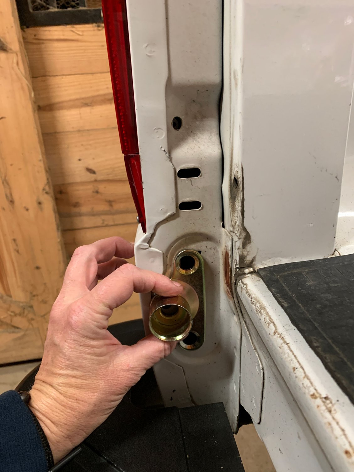

Tailgate hinge question

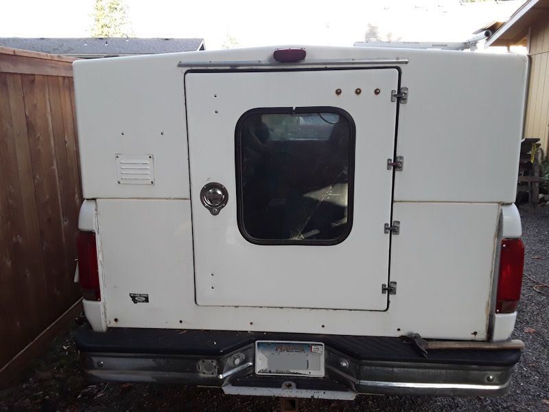

I have a 1997 F-250 Heavy Duty that I just got from my mom's boyfriend, who bought it in 1998. It came with this ugly utility cap that I have just sold with the intention of putting a tailgate on it. I'm thinking this truck may have originally come with that utility cap and never had a tailgate. I think this because I bought a tailgate for it, then bought all the hardware. As I was attempting to put the hinge on the truck, I noticed there is nothing to screw the bolts into. What is supposed to be behind there for me to screw the bolt into?

You're missing the mounting plate (my term) that goes in there. It mounts on the inside, and has two captive nuts for the hinge bolts.
I don't think what you're experiencing with that truck is all that rare, as just this past summer I sold a tailgate on CL to a local guy who had the same thing (utility box inside the bed), and he had to buy the mounting plates elsewhere. Not sure if he sourced them online or found them in a junkyard, but they were easy to find, relatively inexpensive, and simple to install.

I have a nearly identical truck that came with the same type canopy.
The caged nuts were sourced from a wrecking yard. They come out easy once the old screws are removed.
The old screws are easier to remove with a hand held old school impact driver that you strike with a hammer.
Remove the caged nuts from the body by bending the body sheet metal retainers accessed from the tail light opening.
Get the rubber bumpers and the side seal strips too. Side seal strips are held in with serrated push pins. Both of these rubber pieces are available new as well.
