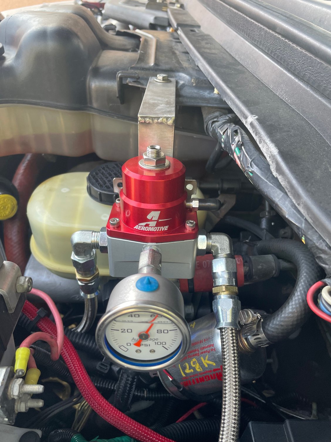

I finally dug them out of the attic and installed them. Luckily I bought them years ago prior to Commiefornia banning this set (why I have no idea). I had to add an original Aeromotive regulator because I was duped years ago with a CHYNA knockoff and could not rebuild it.

I wanted to redo my return lines and never like the zero access lines I made from the back of the heads. I bought a set from dfuser that bring everything up to the top and I used SS fittings for all line connections. I made new PTFE stainless lines incase I ever have leaks from the RR I have modified over the years I have full access and easy road repairs. Unfortunately I now have a premade -4 hose I didn't use but oh well. I thought about making them myself but decided against it. https://dfuser.com/products/dfuser-1...157bae72&_ss=r
