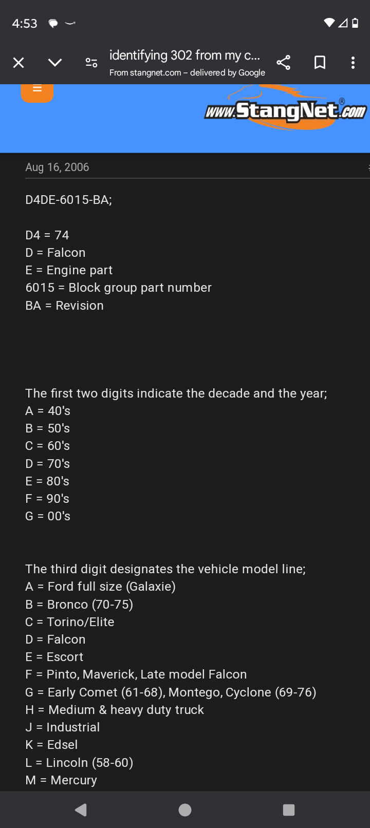

So I'm kinda stuck and need your help. I'm back to work on my project rig and I need to replace the intake and distributor or at least the vacuum advance body. It's broke and somebody siliconed it. What I really need is one of you experts in Ford's to tell me what to tell the auto parts stores when I go in for parts. Caring is 70's era and if I go off the posts from others with that decide list, it's a 74 falcon. But if I type that in, they all tell me it's not compatible. I'm getting frustrated. I know the 302 is just a 302 as some like to say, but I'd rather look like a fool with you guys than saying "I don't know" every time I'm asked at the parts store, "what are you working on?" I've included pictures of what it currently looks like. All I need is someone to say.... Tell them it's this car, and you'll be good.

They tell me the same thing you just did lol. In the last photo, the engine code is shown. Comes up as a 1974 falcon. I'm totally lost in getting a solid answer to what it's from. One guy told me it had a truck oil pan. 😩

Oh, that picture from stangnet, probably incorrect.
Here, this should correct you and them:
D4 - 1974
D - Maverick
E- engine group
6015 engine group base assembly
BA - revision or engineering version

Everything comes up perfect and parts now list on every site. Thank you again.
