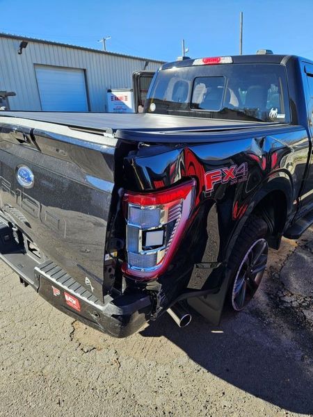

Hello,
I got into a pretty crazy one truck accident yesterday morning. Truck is destroyed.
2022 F150 Lariat

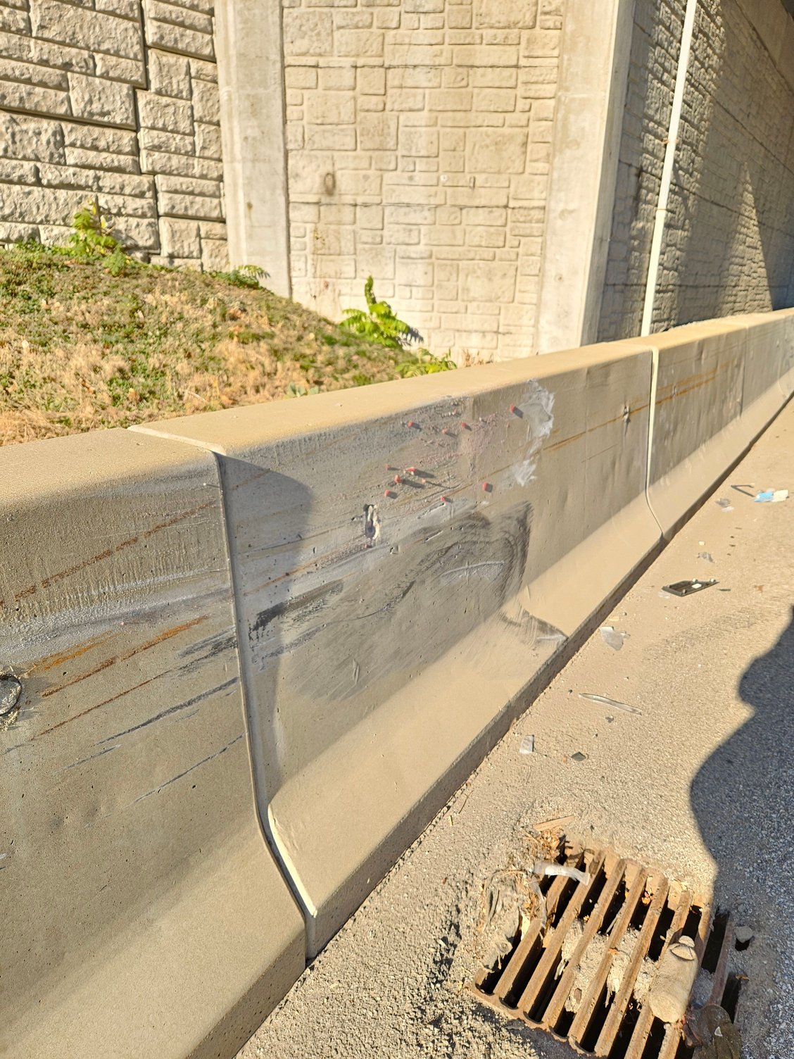

Driving on the highway in the left lane and out of no where the truck went hard left into the jersey barrier as if someone shoved me from the back right. I then shot a across 4 lanes doing a 360 into the opposite side jersey barriers. I hit there face first again but then it spun around one more time and smashed the rear driver side corner.
Not one person hit into me nor did i hit anyone else while this was going on. So lucky!!
I thought someone clipped my right rear corner while trying to pass me and it did like a police pit stop on me. But the two witnesses that pulled over only saw me coming across the highway and swerved to miss me. they never saw the first part where I hit the jersey barrier on the left side of the highway.
When I went to the tow yard to get my stuff from the truck. The tow truck driver said my control arm or arms looks like it snapped. And explained why my tires were in different directions and why I had no control whatso ever then this happend. Truck just had a crazy mind of it's own.
Sooooo anyone ever hear of a problem with these?
Insurance company is going to ask me a bunch of questions and need to offer them a couple ideas of why this isn't my fault.
Thank you!

I don't think I'll get hit with any property damage. Unless they say this cost money to fix that they definitely won't do. (there are 3 of these same marks on the barriers.)
And any debris, they just swept off the side of the road.

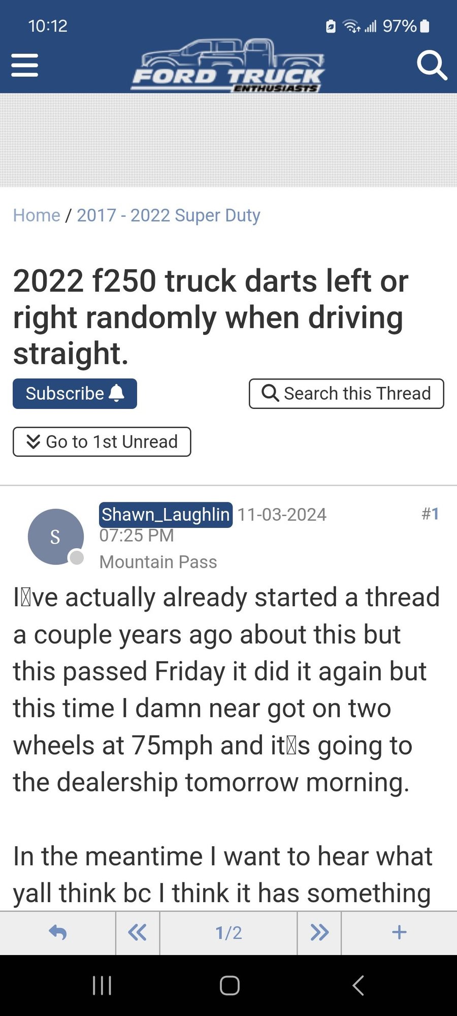

Another guess is the control arm broke from the first high speed cement barrier impact. There is a thread or two here in one of the sub forums of similar vehicle behavior that they were thinking might be psycho computer braking, like the stability control module freaked out.

This current thread may be similar. I can't seem to copy the link so posted a screenshot for you to find it.

Wow! That's wild! And so scary thinking how similar it was to me.

My truck will sometimes do this when adaptive cruise is enabled with lane centering. It’ll catch the shadow of a nearby overpass/on ramp or the center lane and I guess it thinks the road is turning due to the dark shadow and I’ll have to evasively correct it so I don’t hit someone or something ie: exactly like what you explained. At highway speeds a computer controlled lane change is abrupt. Ive experienced this enough at the same shadowed area on the highway at certain times of the day multiple times to avoid that lane on this few particular highways I frequent.
also: I’ve had 2 different 2021 f150’s and they both did this. Over 120k miles logged between the two trucks.

I didn't acknowledge a lift kit. Someone saw the picture and said it looked like it.
But that being said, I have no idea if it had one or if that effected the initial impact or not.
