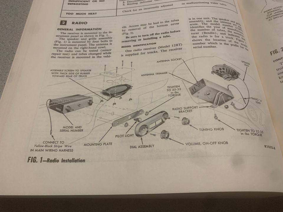

I ordered a retrosound 5x7 dual dash speaker for my '66. It's arriving shortly. I finally looked under the dash and all I see under the speaker area grill is bare metal. no mounts of any kind. I guess I just drill holes in the metal dash? not the end of the world as a previous owner installed a vinyl padded dash pad but curious how the factory did it. I read in another thread that they just used bolts and washers thriough the dash grill? is that accurate?

Countersunk machine thread screws go down through the grill and dash panel and wing nuts were used from the bottom to hold the speaker from below.

thank you. I can’t find any pics of how it should look

This is from the 1961 Shop Manual but I also have a few 1966 F250s with original speaker and radio installed from the factory that all use the same hardware. I'll try to remember to see if I can find the hardware easily from one I took apart and snap some pictures of it but this page from the manual shows it decent.

Thank you!!
