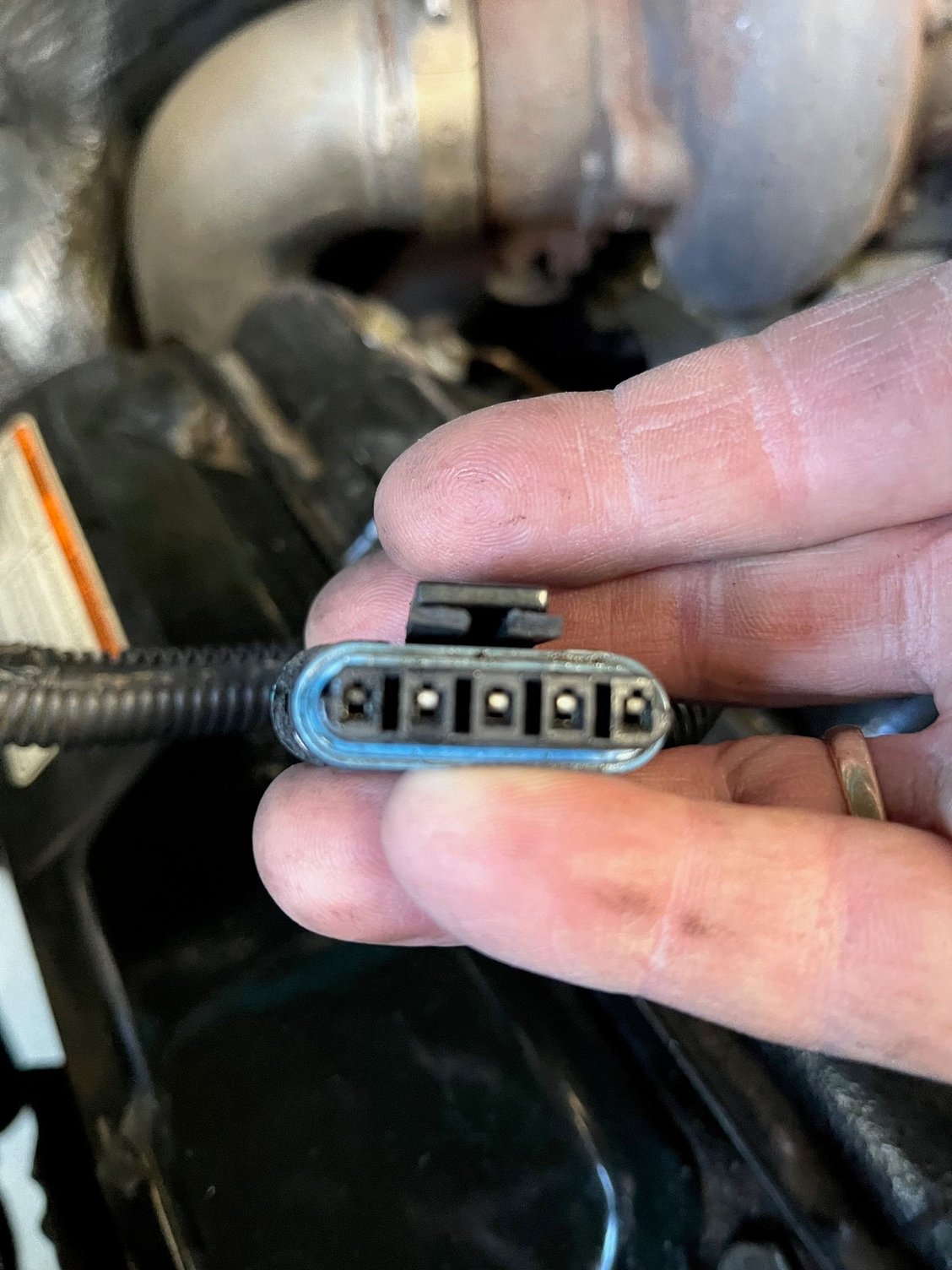

follow up
Check UVCH plug no pins appears to be burned. See photos.

It looks to me that you have 3 burned pins, left rear has 1 and both right plugs have 1. Granted they are the glow plug pins, but they will eventually melt into the injector pins. The ZD10 plugs will be fine to use, and it won't hurt the engine to drive it a 1/4 mile to the shop.
