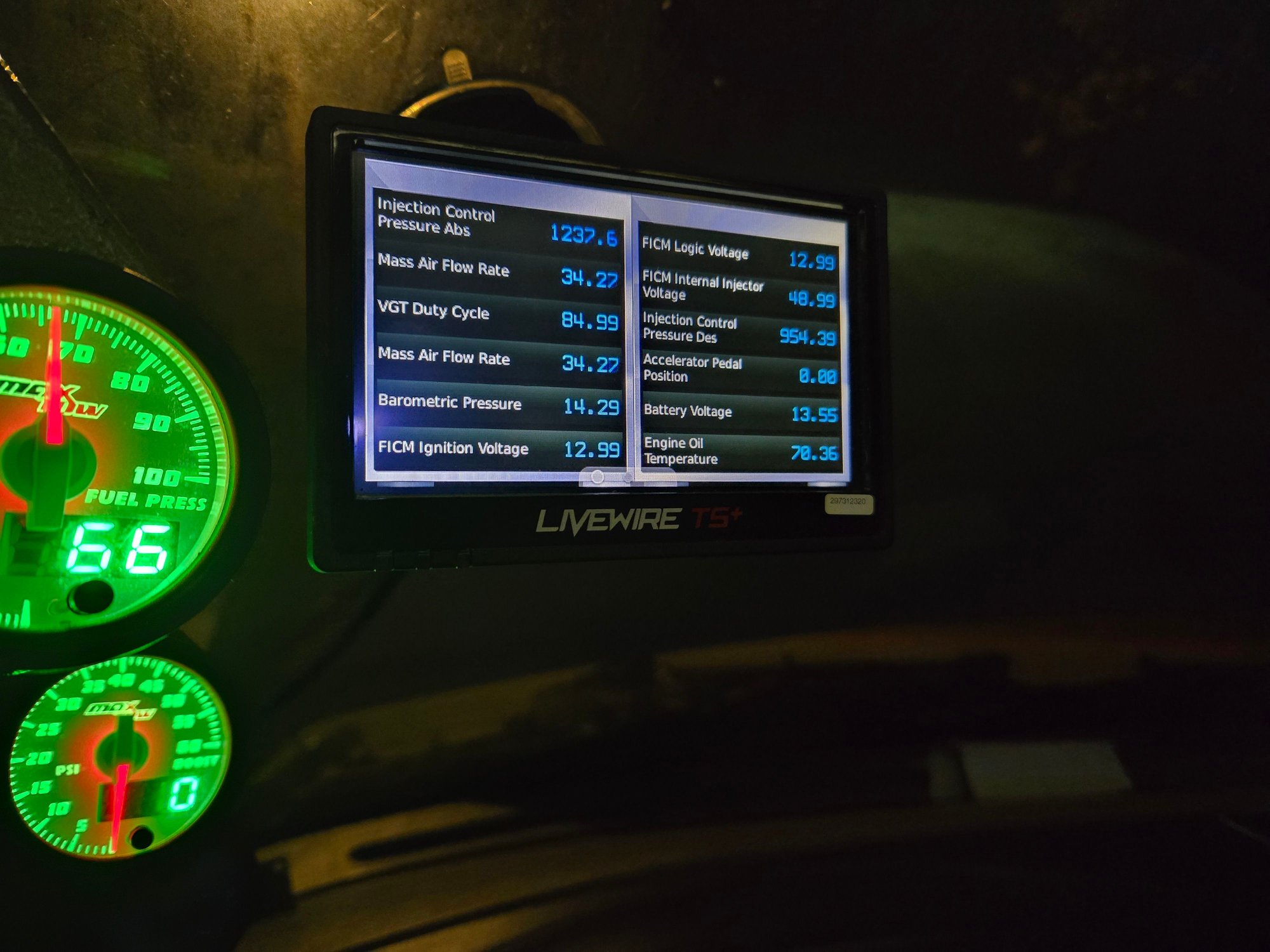

Struggling with icp
06 f350 cclb lariat upgrades sct livewire ts with several custom tunes full mrbp exhaust 4 inch downpipe, standpipes updated dummy plugs stc fitting, arp studs , blue spring kit , s and b intake , Rudy's uppipes, new oil cooler, egr deleted, been playing hello with this for months new ipr new icp these are my readings when first started after a few minutes It will go to default icp numbers and won't go back until I shut off and restart please help

What’s ICPV during the event
Your not up to temp
should have codes a CEL as well post these
