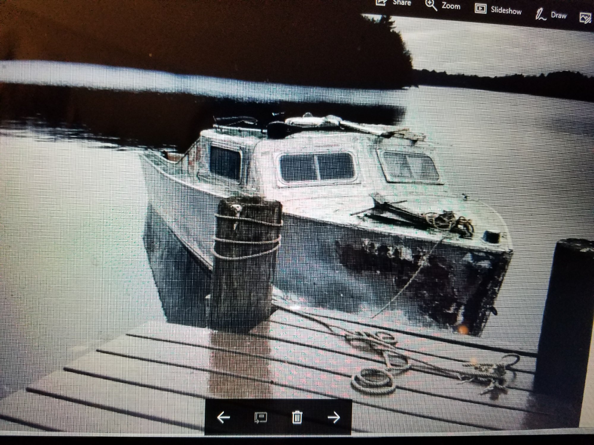

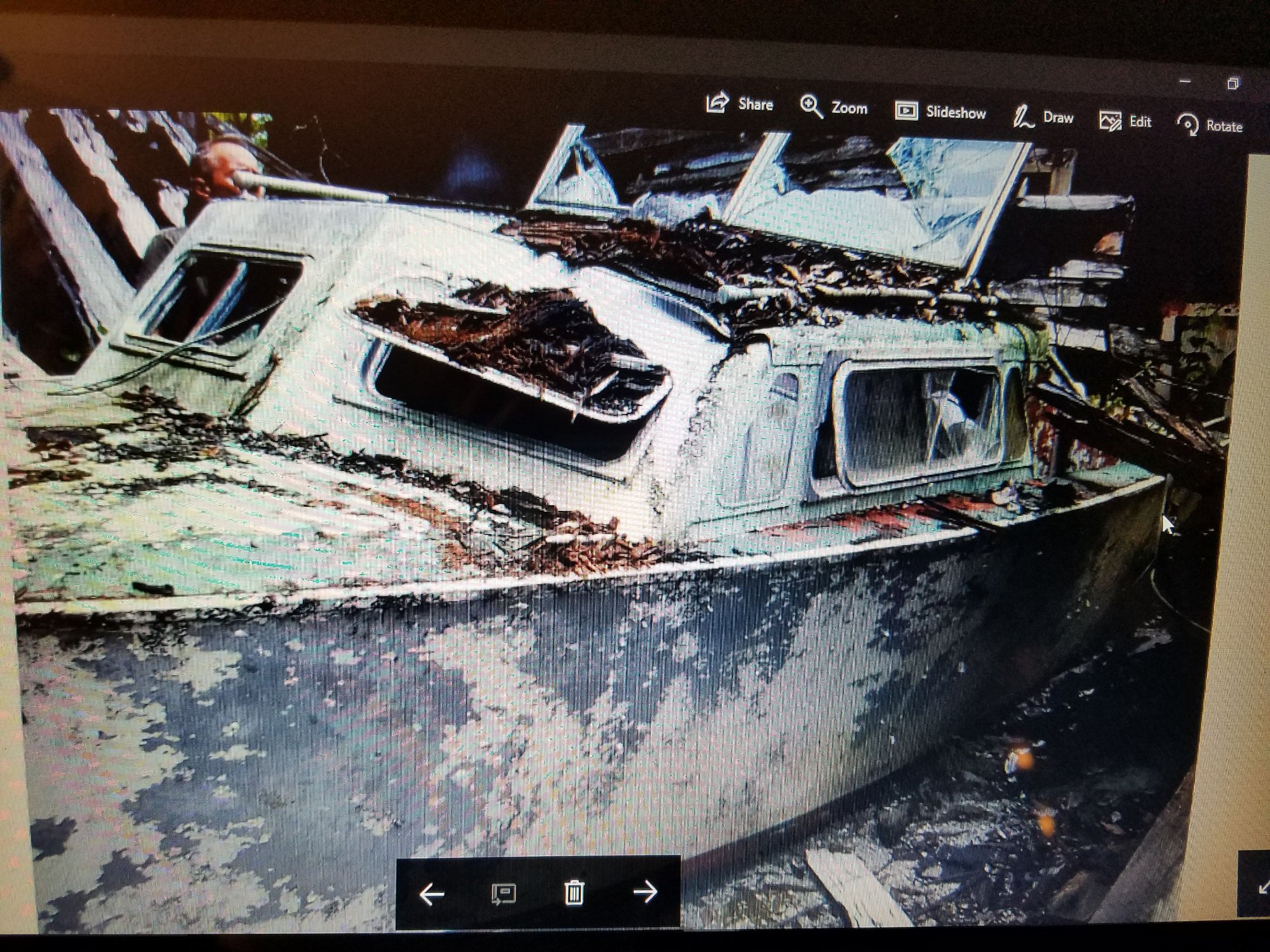

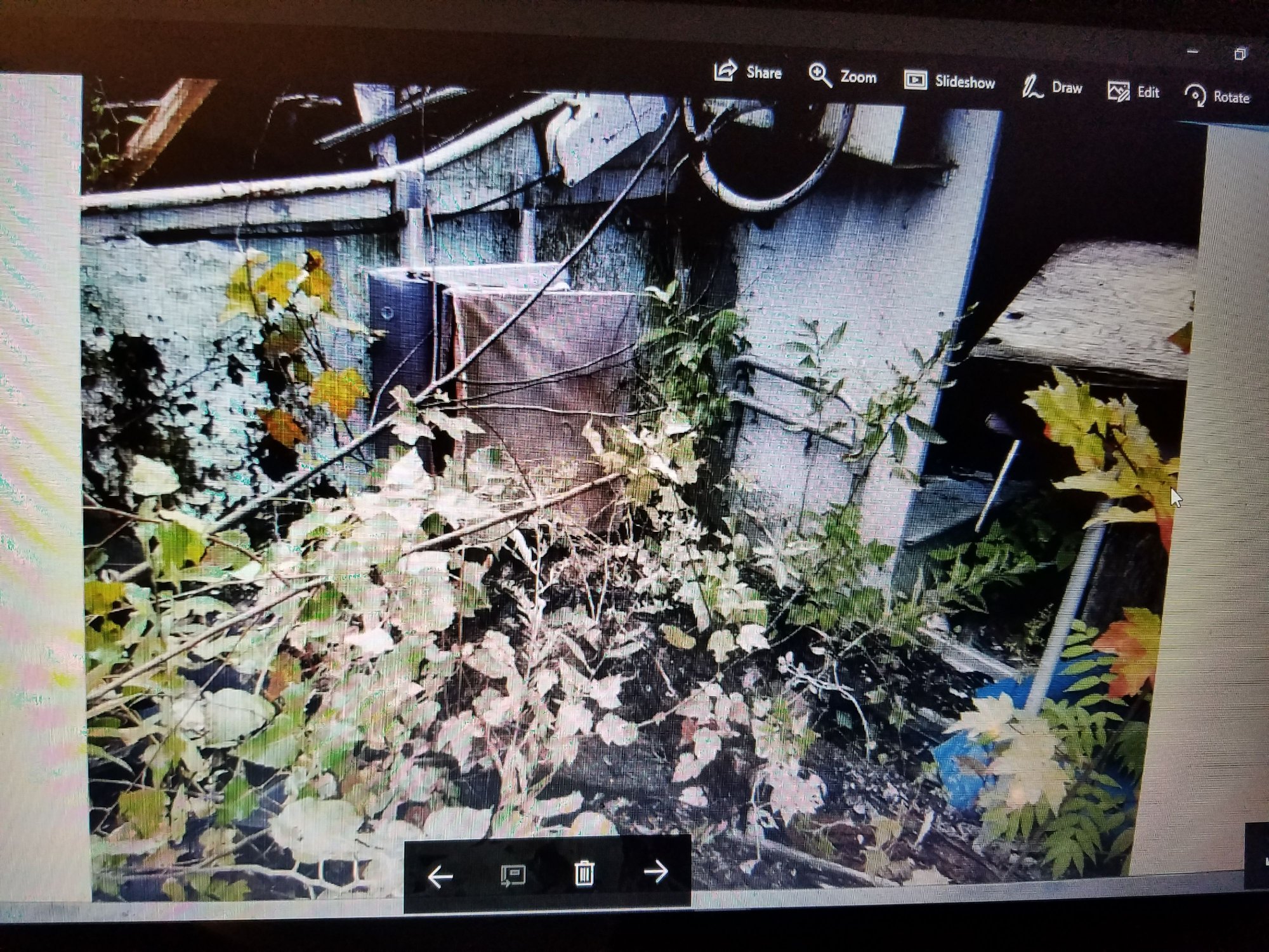

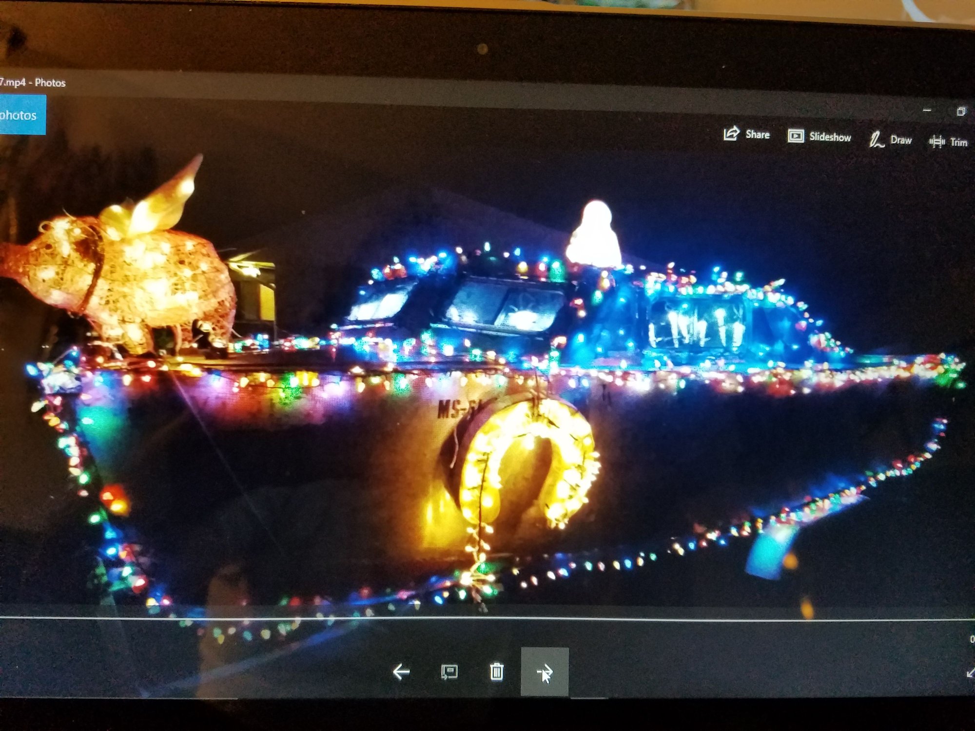

The Boat
Oh, sure
She is a 1955 Lonestar Starliner 21' aluminum cabin cruiser.
I found her at an abandoned boatyard, on the ground for 30 years, tracked down the owners, and made the deal.
This was a Lake Champlain boat so I want to name her Champ, (real original).
Weight 1000# bare, add for engine and gear. More than 2000 rivets, done with a man on each side.
Deep V front, goint to almost completely flat towards the back.
Here are some pics.
Thanks for asking.
Joe.
When first found with a building fallen on it.
