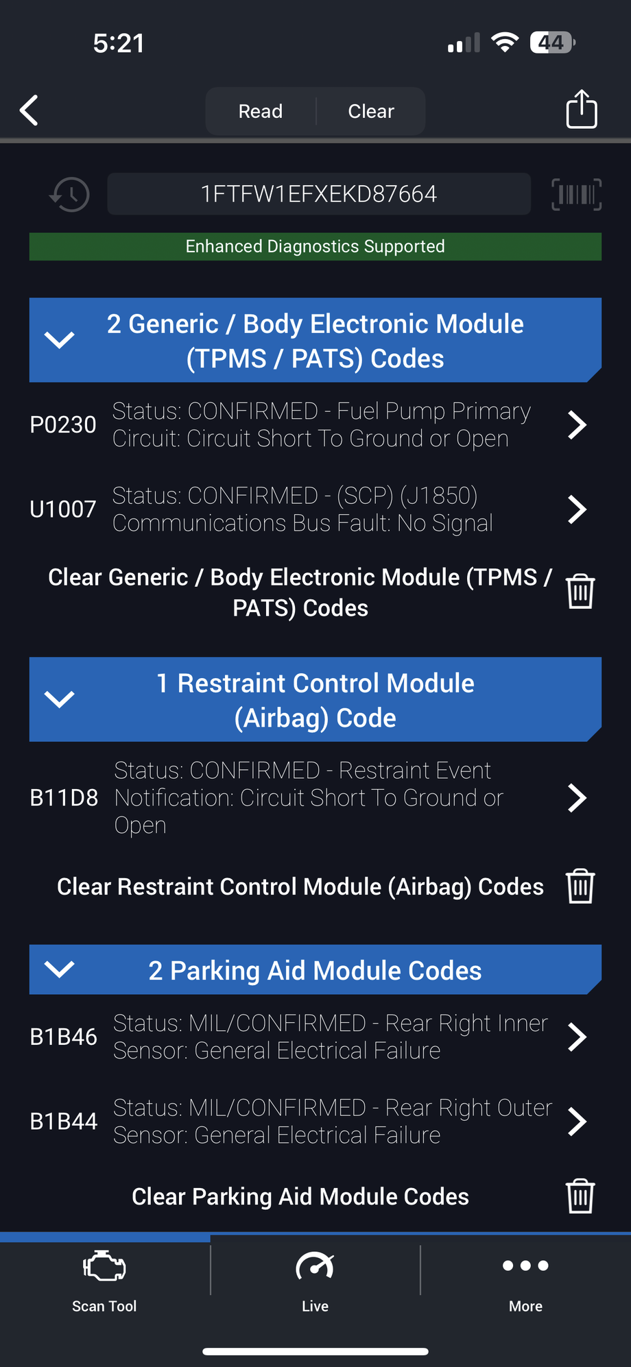

I just ran a code scan about ten minutes ago
This is the codes I just found ten minutes ago.
