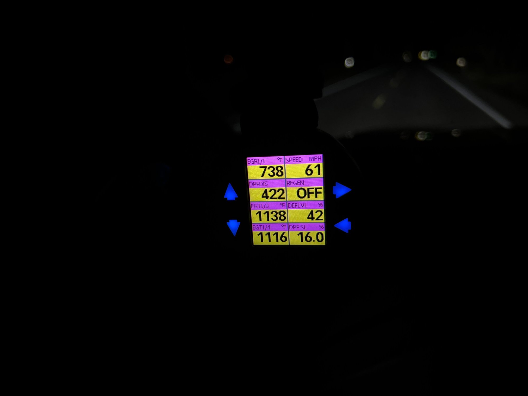

Here’s an odd one. Truck was in a regen yet wasn’t.
wonder how many of them before the smoking stops.
Interesting... I wonder where EGT2 temp was at...
Probably similar to Zoo dad's
https://www.ford-trucks.com/forums/1...l#post21389577
On this truck EGT2 is a tad lower than 1. That why I replaced it with the distance between regen. Only 3&4 get HOT when doing a regen
Yep... just figured that out when I read this... the 9th injector. Makes sense. Thanks.
Interesting... I wonder where EGT2 temp was at...7
EGT1 is pretty close to the exhaust port,
EGT2 is the CAT at the begining of the emission section of the tail pipe
EGT3 is the DPF
EGT4 is just after the SCR
So I always expect 3 &4 to get hotter during regen.
EGT1 heats up when engine is under turbo boost and working
EGT3 is the DPF
Thanks... the EGTs for mine will be different since fuel is injected on the exhaust stroke and not in the DPF itself like the 23s plus. I'd expect your EGT2 temp is lower than mine during the short regens the new trucks have.
During my recent regen, EGT2, which is usually always the hottest, was 1200 deg. EGT 4 was at 1100s.
