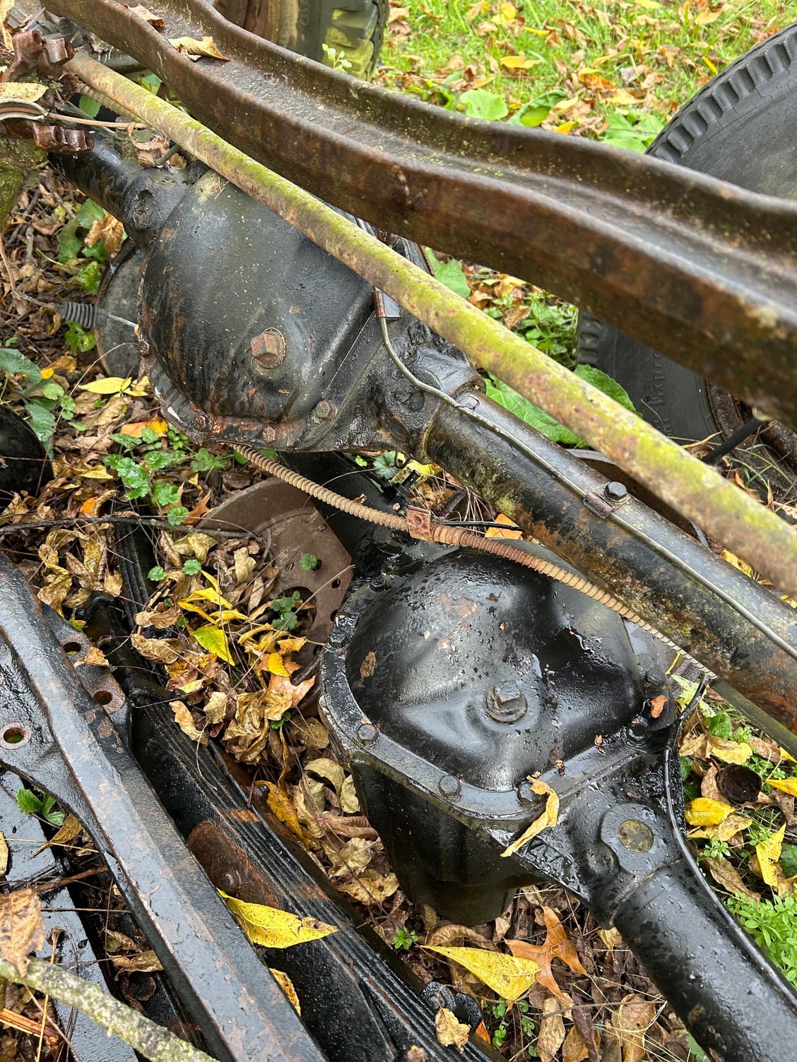

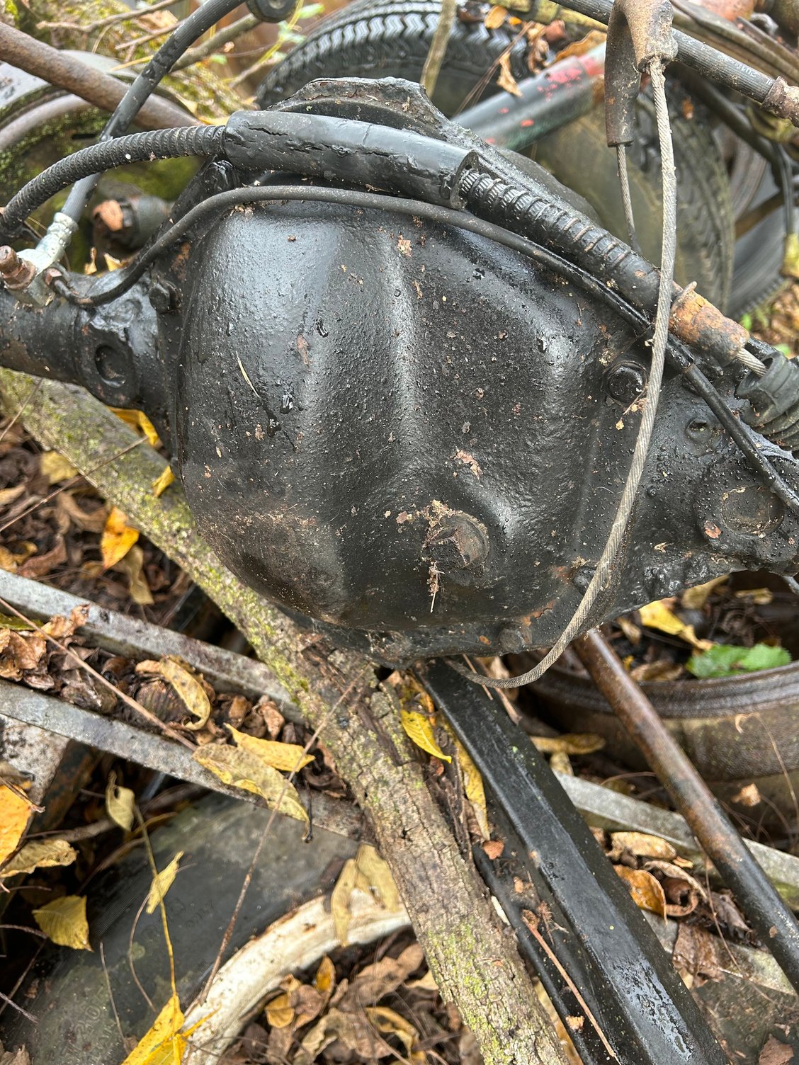

I am changing the oil in my 1954 F100 Dana 44. The fill plug is square and has been in a long time. I soaked it in pb tonight and will go at it again tomorrow. Does anyone know what size square wrench would fit it without rounding it off? Every socket I put on it was loose and I don’t want to chew it up to get it off.
My plan it to tap on it with a hammer, heat, and more pb. But any other advice is appreciated.

It is 3/4" and you should use an appropriate 4 or 8 point socket. A 6 point socket won't do, and while a 12 point socket may fit, it is more prone to round the edges.

Do you have any 3/4" drive socket wrench extensions? You could use one "backwards" to give you a square point out away from the diff case to put an open end wrench or a big crescent wrench on. Harbor Freight has pretty cheap ones if you don't have any.

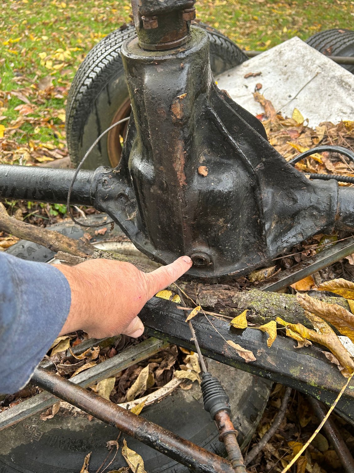

He's trying to get the fill plug out. The drain plug is in the cover.

the fill plug is in the cover and it is a male plug
the DRAIN plug is in the case/housing and is a inverted pipe plug
I wouldn't even bother with the drain plug, I'd pull the cover, clean, inspect, and replace cover gasket
but the OP did say fill plug
