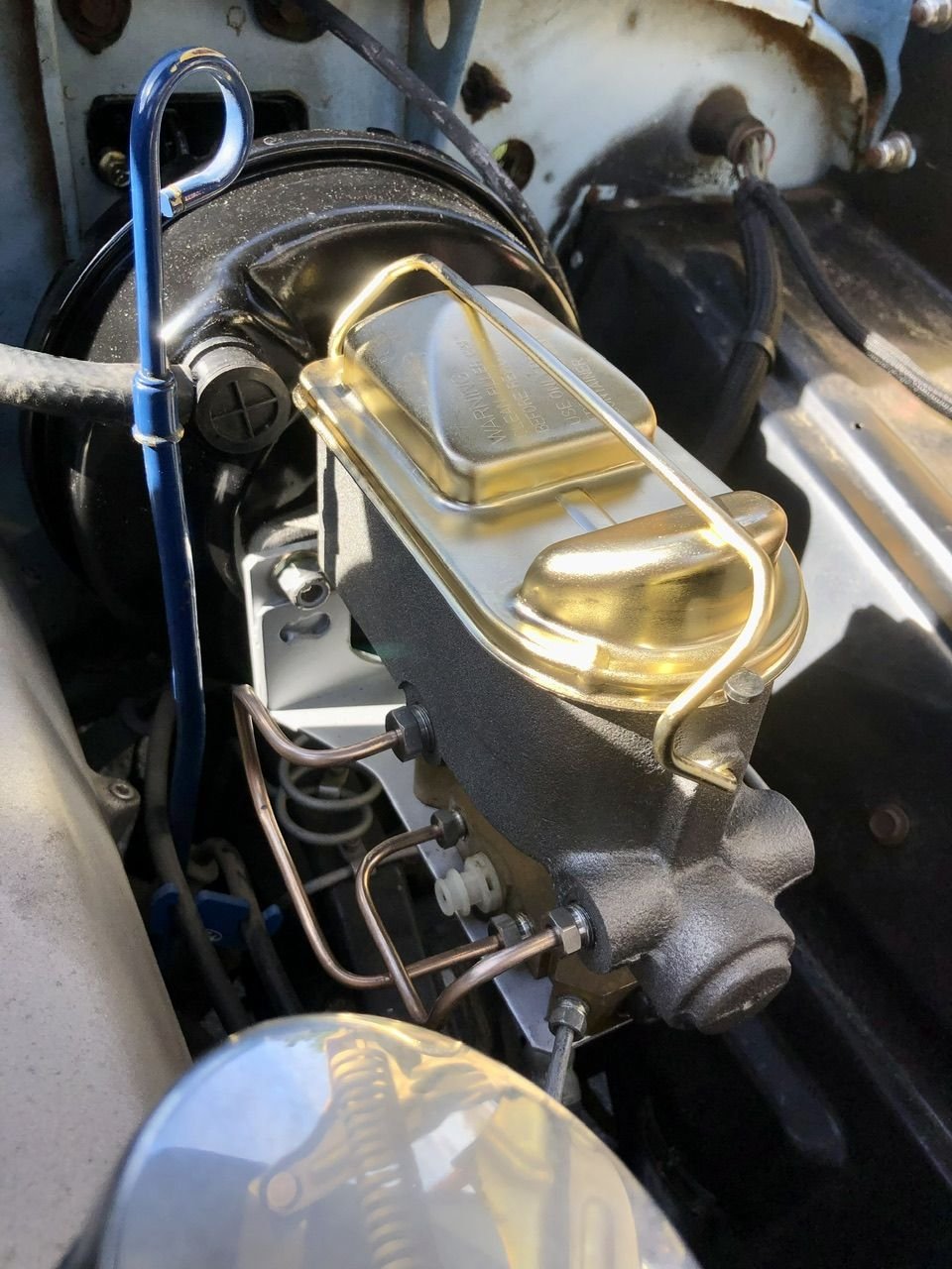

OEM 1975 F100 disc/drum master cylinder and booster on my ‘72, with a PV2 combo valve under the master…

Master cyl came from Napa, booster and PV2 valve came from Summit Racing.
I had a kit from Pirate Jack on it before with the generic dual diaphragm booster and Corvette style master cyl, same PV2 valve. I never liked the way the pedal felt. The master and booster went into my recycling bin and I bought the OEM stuff. The brakes are great now.

2168 master from Napa $71.99
54-73515 booster from Summit $104.99
PV2 from Summit $78.99
I have these same exact parts on my 63 F100 disc/drum truck.

You can use your stock booster if the stud spacing for the master is the same. I tossed mine, thinking I needed a dual diaphragm because of largish cam. I never got the chance to mount the 75 master to the 72 booster because I tossed it. Prolly should've kept it.
The bracket for the combo valve was a generic bracket that can be bought from Summit. I remember that I had to modify the bracket because there wasn't enough room under the master for the valve. Most people mount the valve down on the frame like the later trucks. There are also brackets that locate the valve off to the side of the master.
https://www.summitracing.com/parts/leb-9005
https://www.summitracing.com/parts/leb-9006l
