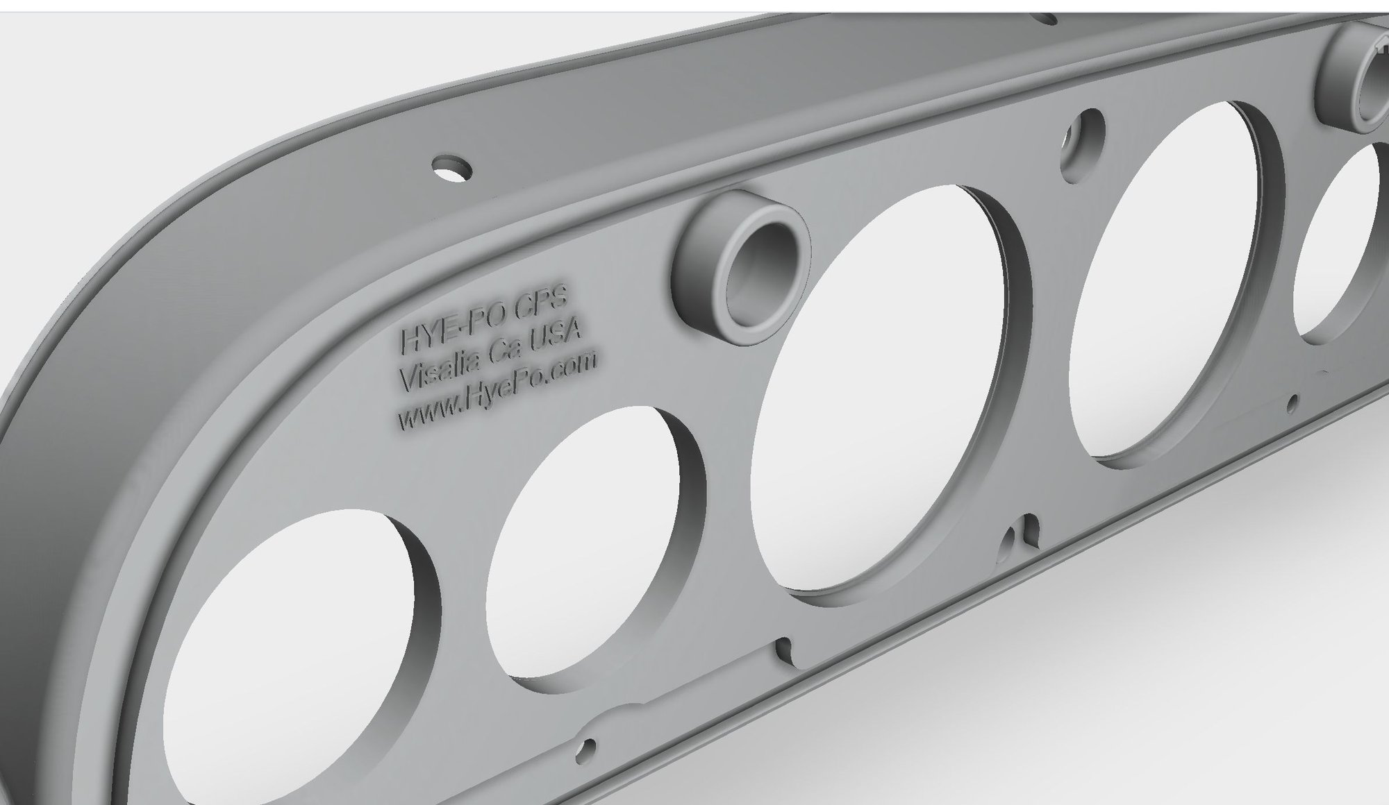

I was probably just fine with the current vacuum-formed ABS panel, with mounting backing and aluminum insert I created a couple of years ago, but with just enough time on my hands and a new found new hobby called Fusion 360, I thought it would be nice to have a single piece gauge panel that was more consistent than heated plastic and required NO trimming before being prepped for finish.
Well, here is what I came up with.
The outer rim should be able to take that horrible rubber grommet or something similar like I used on the formed ABS, the mounting deck for modern 3-3/8” and 1-1/16” is 1/4” thick so nice and sturdy and of course, the aluminum insert I used for the formed ABS bezel will work here so those unique Ford arrow turn signal indicator lamps will still be present.
I had a prototype made and tested fitment was 100%. I did need to fix a few items on the back side but that was for structure and not appearances.

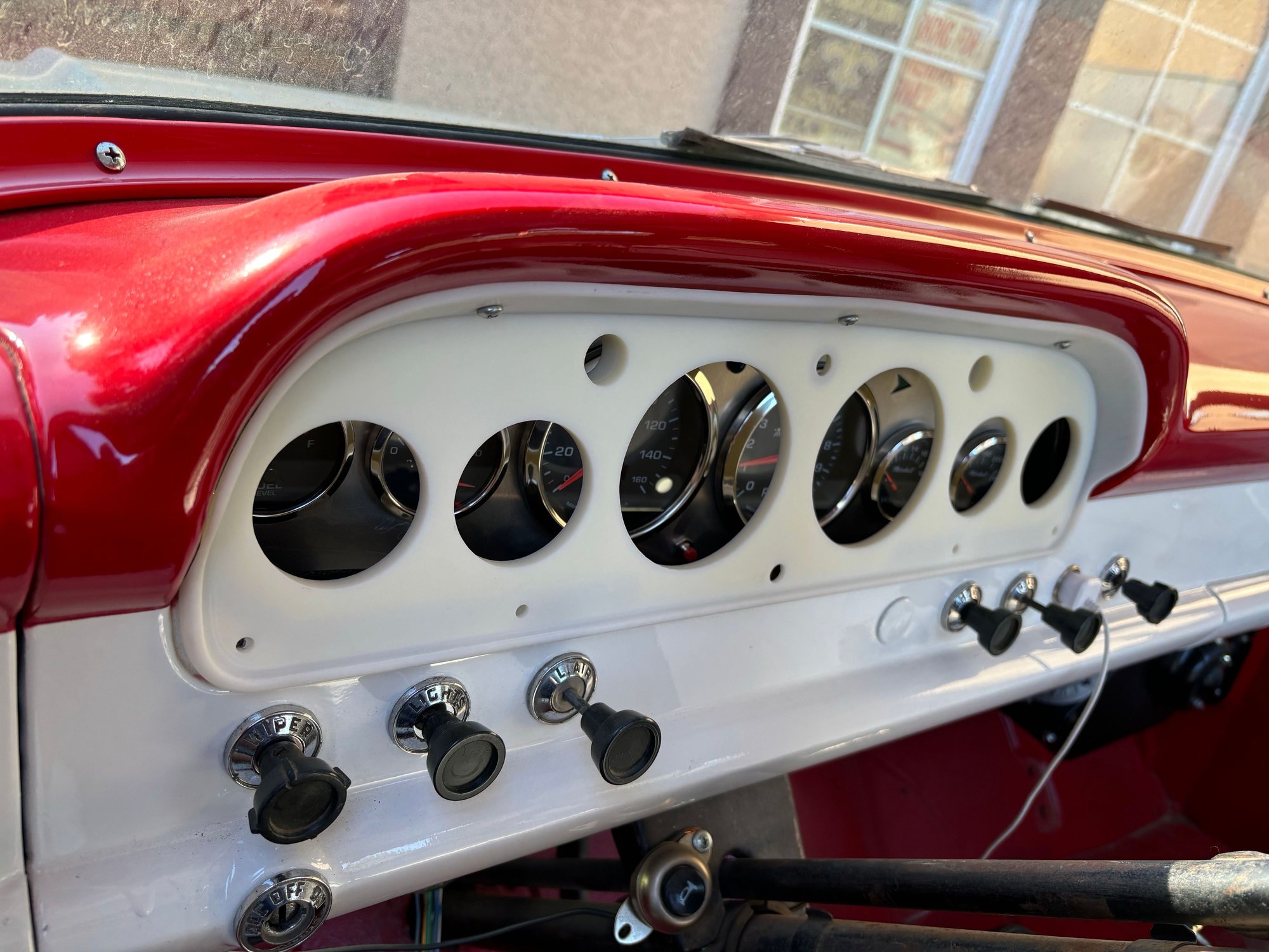

Here is the image of the prototype in my ‘57. Look closely you can see the formed ABS panel and gauges tucked in behind during the test fit.
