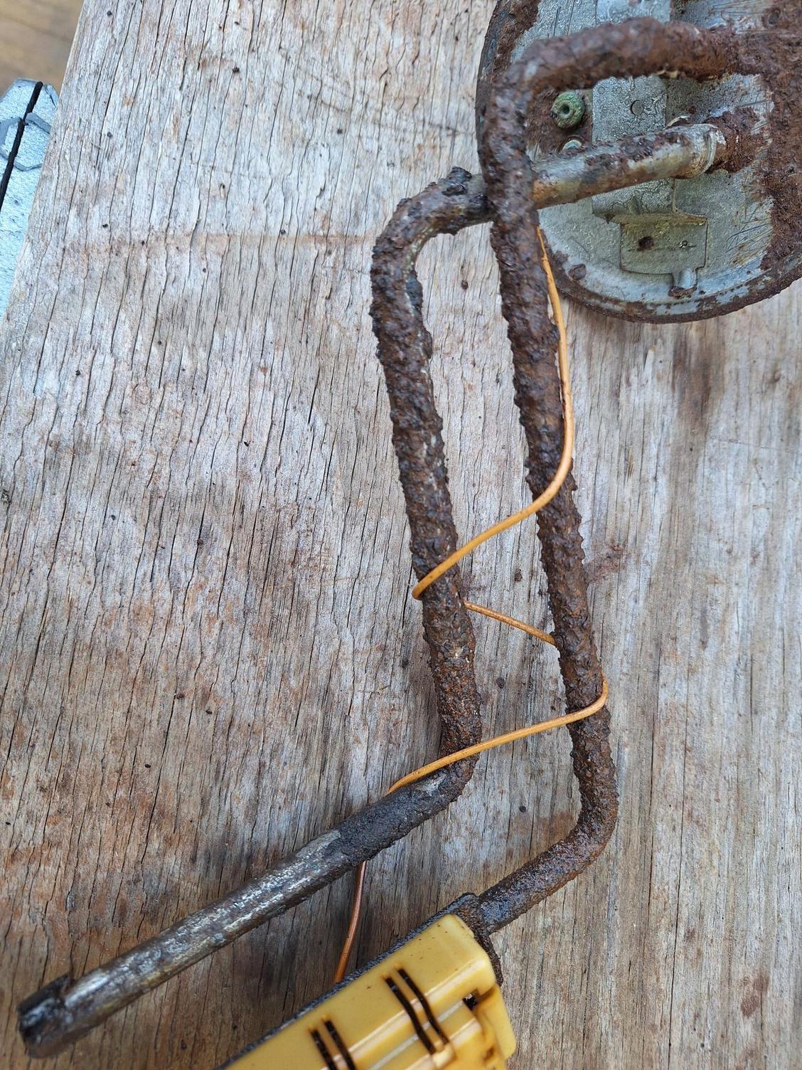

After cleaning the tank, fixing the sending unit and installing new strainer on my other truck 4 years ago I was curious to see how it looks now. So far so good.
