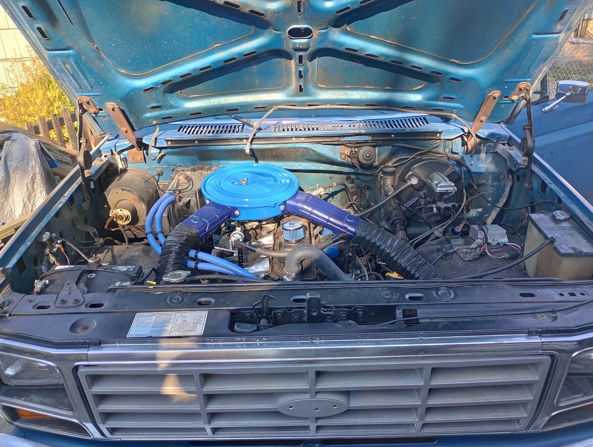

Wish my truck looked half the nice. I just measured the length of brake line I needed and bought a 48" piece for a few bucks from the container of Ni-Copp pre-flared with nuts from the bin on the floor at NAPA. That stuff is easy to bend by hand.
Oh, have you thought about flushing the old brake fluid out of the system ?
You might want to save that air cleaner set up with the inlet hoses. Someone was looking for those a couple of days ago.
I’m fairly certain that will happen when he changes all the lines and hoses.

As for that air filter that is pretty cool
I would keep it as it looks factory stock and I like things that look factory that are not.

I've always like the twin snout air cleaner look and have built them for about every car or truck I've done over the years. I torn on leaving this 300 and just swapping a 5 speed in and putting a intake and some split manifolds and send it. I've got a Clifford valve cover and a powered by Ford one also that I'm going to put on it just figure which one. I've got to clean up the wiring a bit still from the kid I bought it from had really screwed it up and I've got a under hood trouble light to install also. It's a clean little truck. Gotta make mind up to either just make this a good clean runner and find another to build into a street strip truck or build this into one. I'd like to see how far off the frame from a Fairmont wagon from 80s would be for putting truck onto. Can't be too far off. Find a V8 wagon
