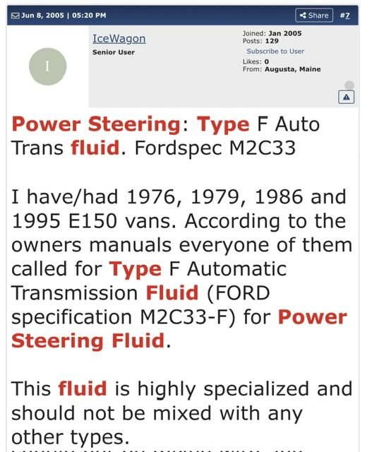

What power steering fluid should be used when the Saginaw swap is completed? Thank you for your consideration.

I searched for “E-150 power steering fluid” in the forum search and found…

I have two different vehicles that I have converted from C2 to Saginaw pumps and I just use Valvoline "universal" Power Steering Fluid. It's worked fine in both for years now.
I'm not saying it's optimal, but it's worked fine for me and I wouldn't hesitate to use it again.

Few quarts should be fine. Depends if you have an inline filter (recommend one from Magnefine) and the larger return cooler assembly. This all adds capacity.
I too have been using 'universal' PS fluid for years in one, other has Type F. I would guess the ATF has more detergents than the PS. Hell, you could probably use Dex3/Mercon too...it is a hydraulic fluid after all.

Two quarts should be enough to flush the system and top it off.
Aurora would know but I’m pretty certain that GM used plain old P/S fluid for years in those pumps. I’m not sure why Ford puts Type F ATF in them. Probably because that is what the CII pumps use so that is what I have in my Saginaw pumps.
I do know
Ford used Type F for seal compatability purposes, its either in the service data or a late 90s TSB discussing that Mercon would be used in all models except These trucks because they made these while starting the new body style and super duties etc.
GM stopped using Dex 3 in power steering because its actually not goood for that purpose, no modern conventional or synthetic ATF is. IT has to do with a few things, mostly the seal compatabilities, heat, and air properties. In GM vehicles, they designed the power steering to not be compatabile with dexron in the mid 90s and onward, so using it obviously was not wise. ATF also was designed to foam and trap air int it. This makes bleeding it much more difficult and the properties of ATF(and additives) make it so turbulent return to the reservoir can make more air trap or just heat up
c2 pumps notoriously have air problems compared to saginaw, despite being similar designs. ford recommends a more robust air bleed than gm does now. I would be willing to try other fluids only if i was confident it wont make it leak, swell up, or similar. Because I live in cold place, and people use gm saginaws on their f150 all the time with type F without issue (that i can tell) i kinda want to just use GMs cold climate fluid in both my trucks. Its expensive, so leaks gonna have to be fixed first LOL
