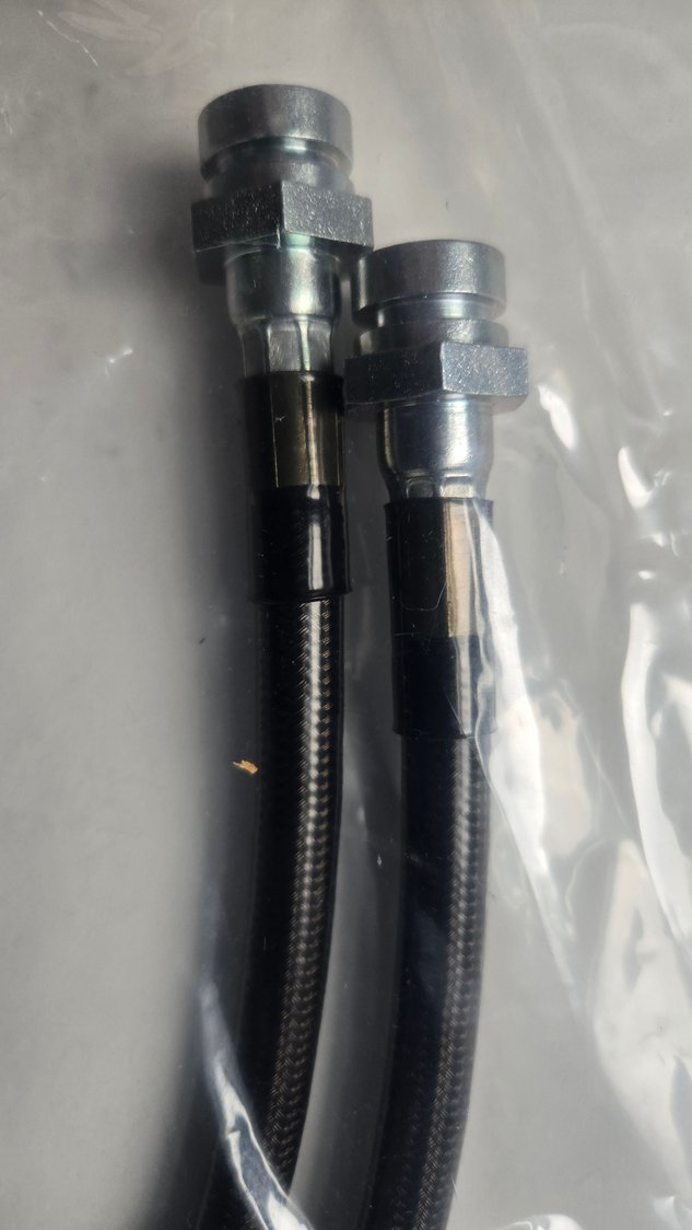

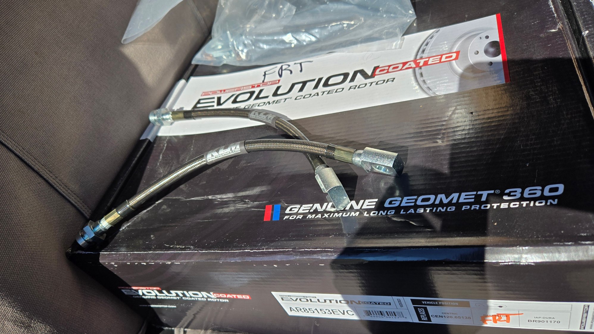

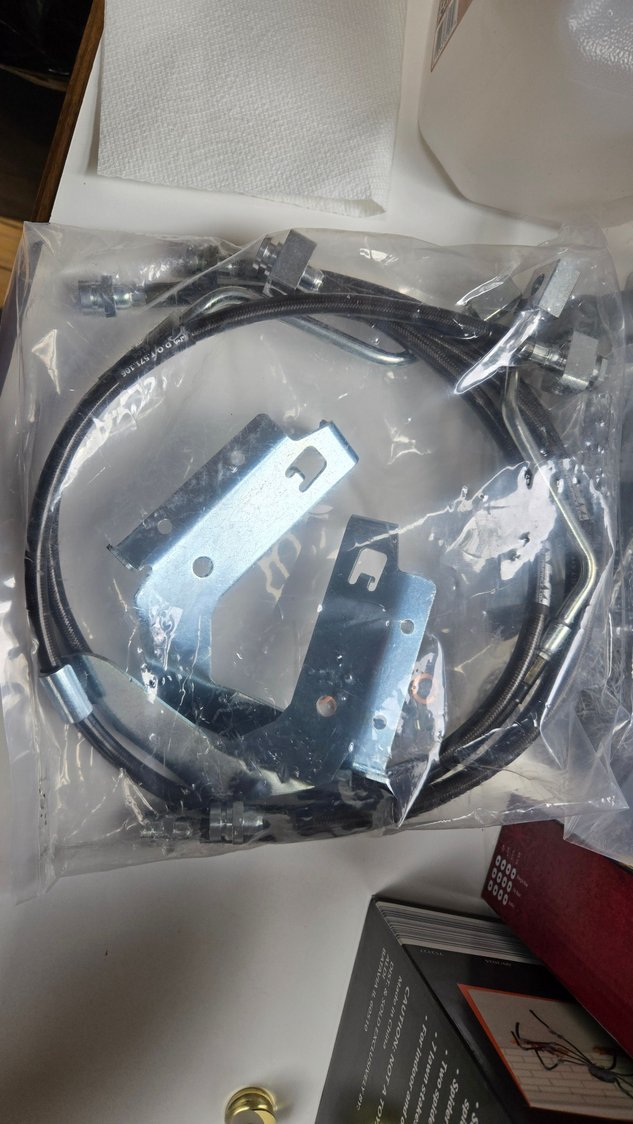

My truck's going in this week for a complete brake job.
I ordered these through KLM's Performance's website... they custom make them for every application.
Borrowed a brake line clamp from the mechanic who does my brakes at my buddy's shop to put on the passenger front so those piston seals don't leak when I take it there... the stock rubber line looks bad so I'm glad I went with those aftermarket lines.
https://klmperformance.com/search?q=brake+lines&_pos=1&_psq=Brake&_ss=e&_v=1. 0

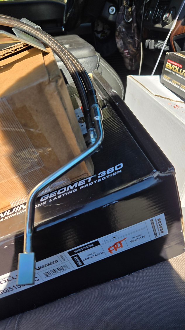

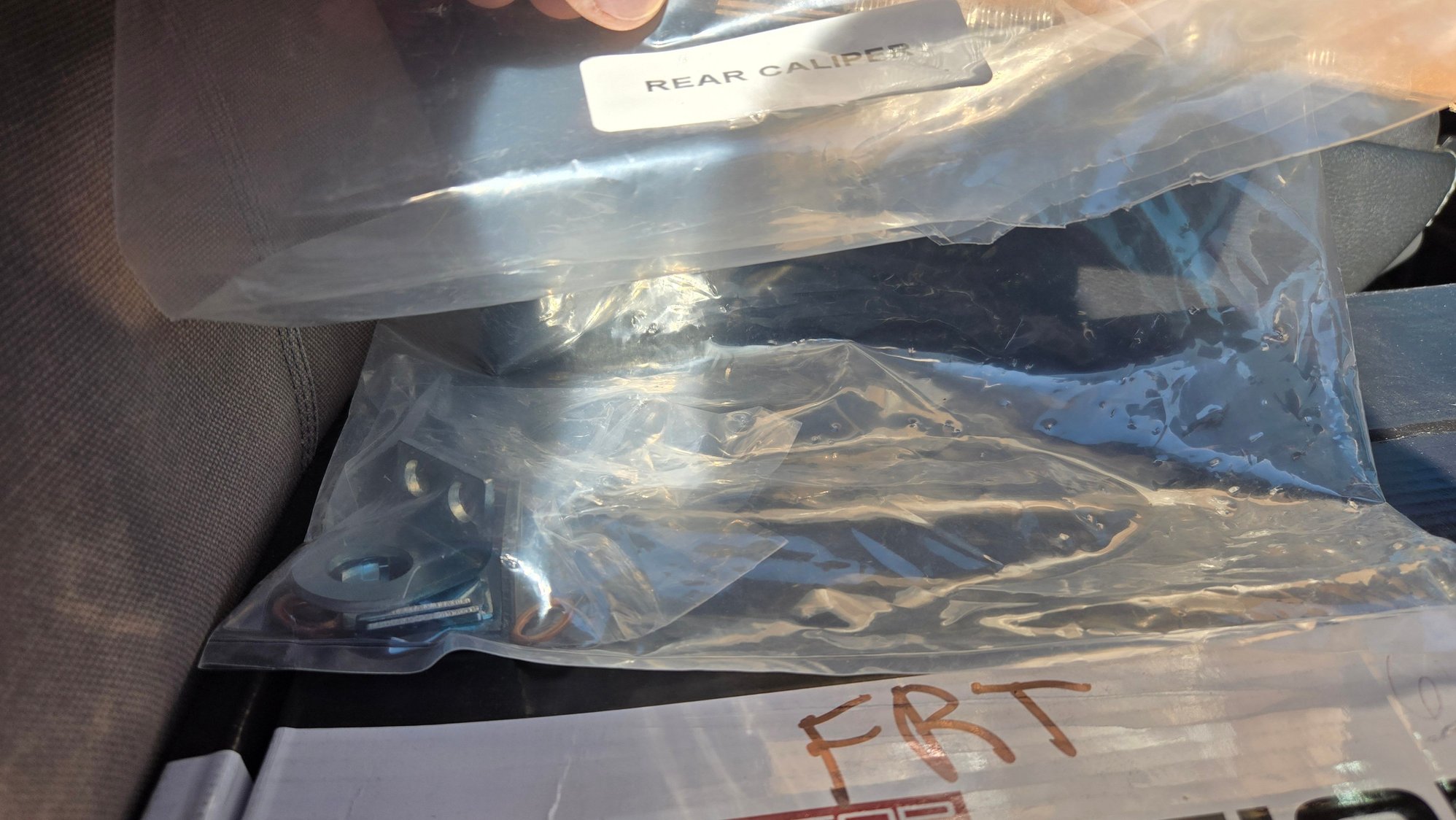

The rear caliper lines...
The front lines.
Took better pics today...

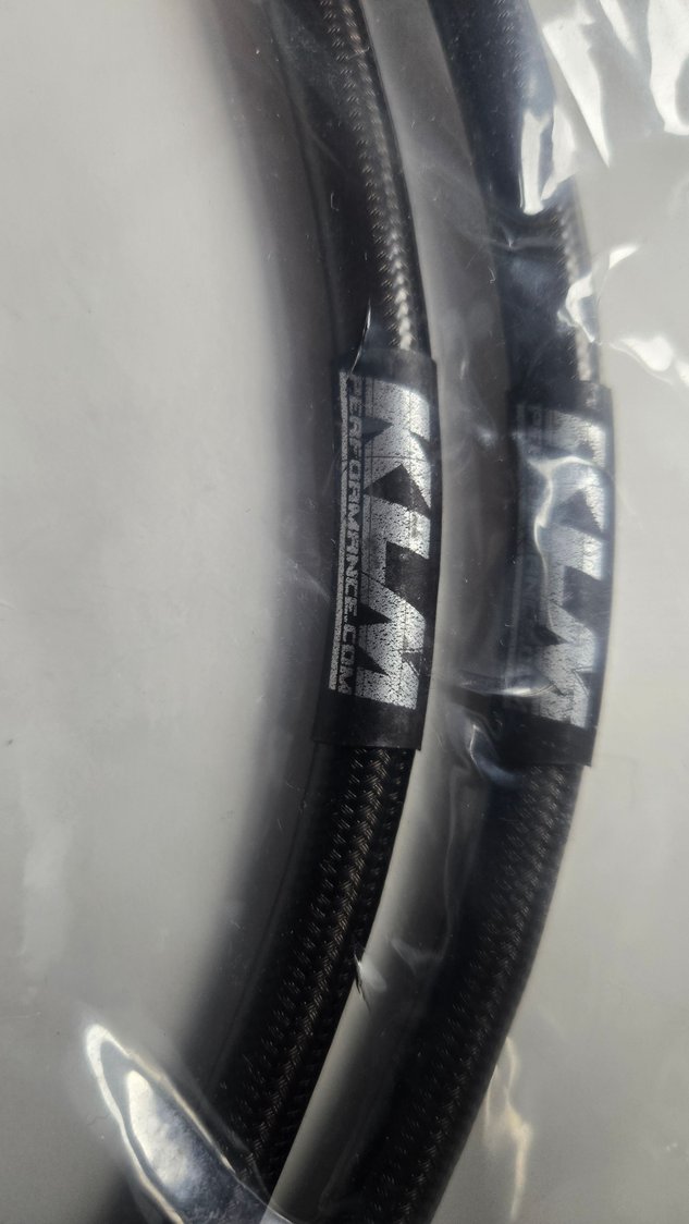

Powerstops! If going to do it, do it right! Curious how that outer cover holds up over time.
Yep and the Powerstop Z17 ceramic brake pads as well... have had good luck with them. Which outer cover?
The covering over the braid on your lines.
Ahhh... ok. Gotcha... Made here in the USA so hopefully good to go for at least as long as the rubber OEM brake lines lasted...
Why, what are you thinking?
Cant put my finger on it, but I recall something similar that had a clear covering that came apart over time. I honestly cannot remember what it was or what it was for but it looked like that hose. I think it had something to do with oil or grease that hardened the casing and caused it to become brittle, but thats about all I remember of it. It was long ago and probably not even related.
Okay... fingers crossed... but hopefully they are good to go...
My braided lines for FS2500 are not covered and started rusting soon after the kit was mounted but maybe they are for protection of the oil rated rubber lines for the kit...

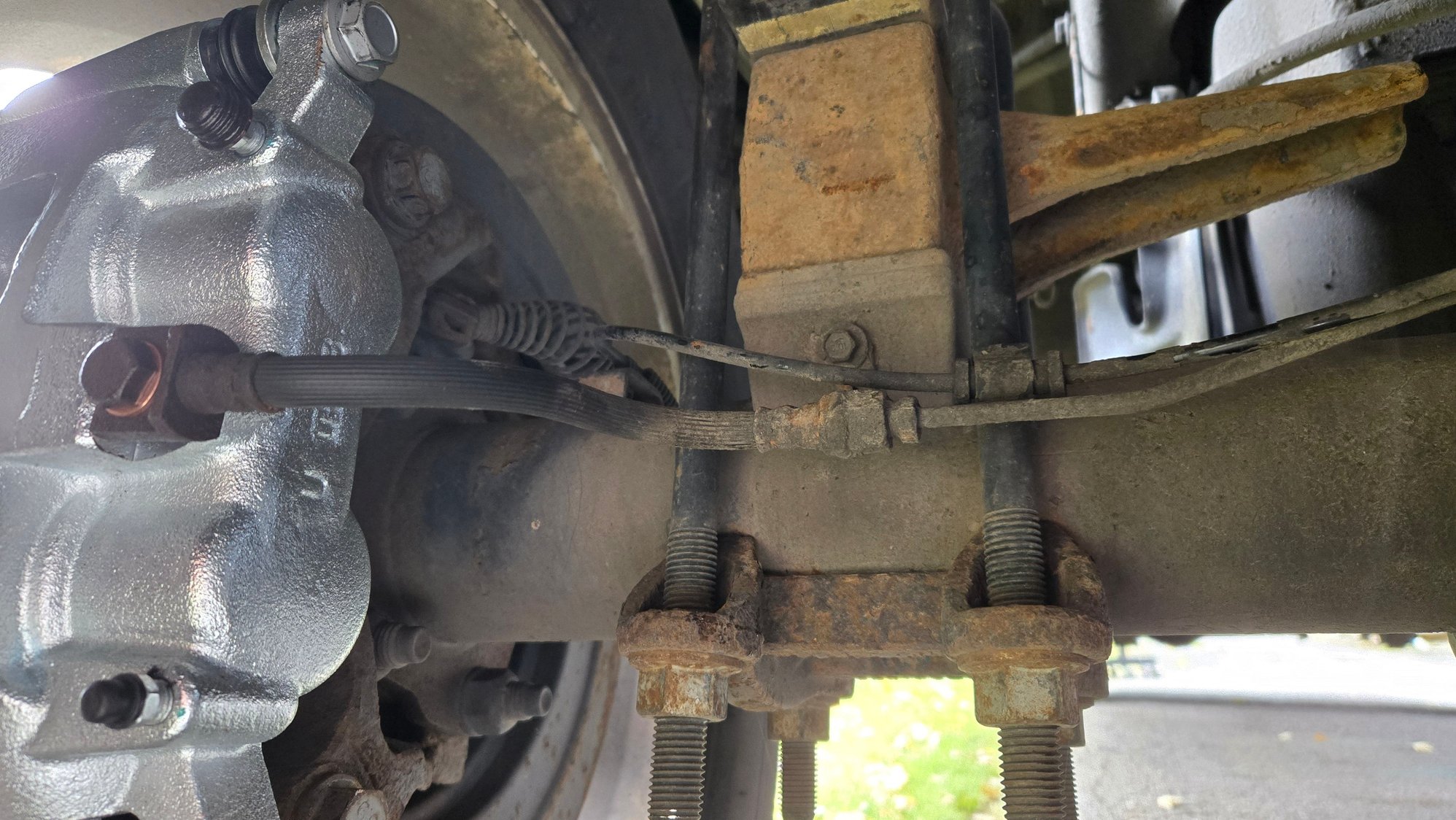

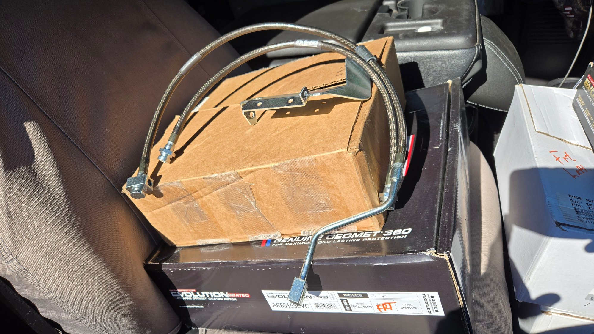

Got the truck back yesterday and they didn't install the rears. The second set of shorter lines included with the front lines are for the rear. I guess the rear has two sets of soft lines. It'll have to be when I retire and have the truck as my hobby to install them... on set of the rear lines have to cut and flared, I'm guessing for the set in the center, not the caliper feed lines. My buddy has a Ford tech working part time for him who said not to install and yada yada yada... but I'll do it.
I'll take a pic of the front lines when I install the 18 inch steelies with winter tires coming up.
Old Oct 27, 2024 | 05:33 PM
Overkill2's Avatar
Overkill2
Joined: Mar 2017
Posts: 31,969
Likes: 9,197
From: Western NY

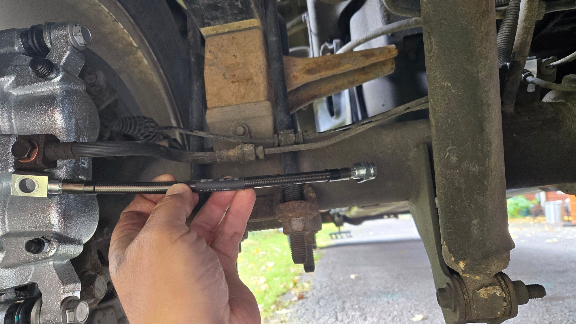

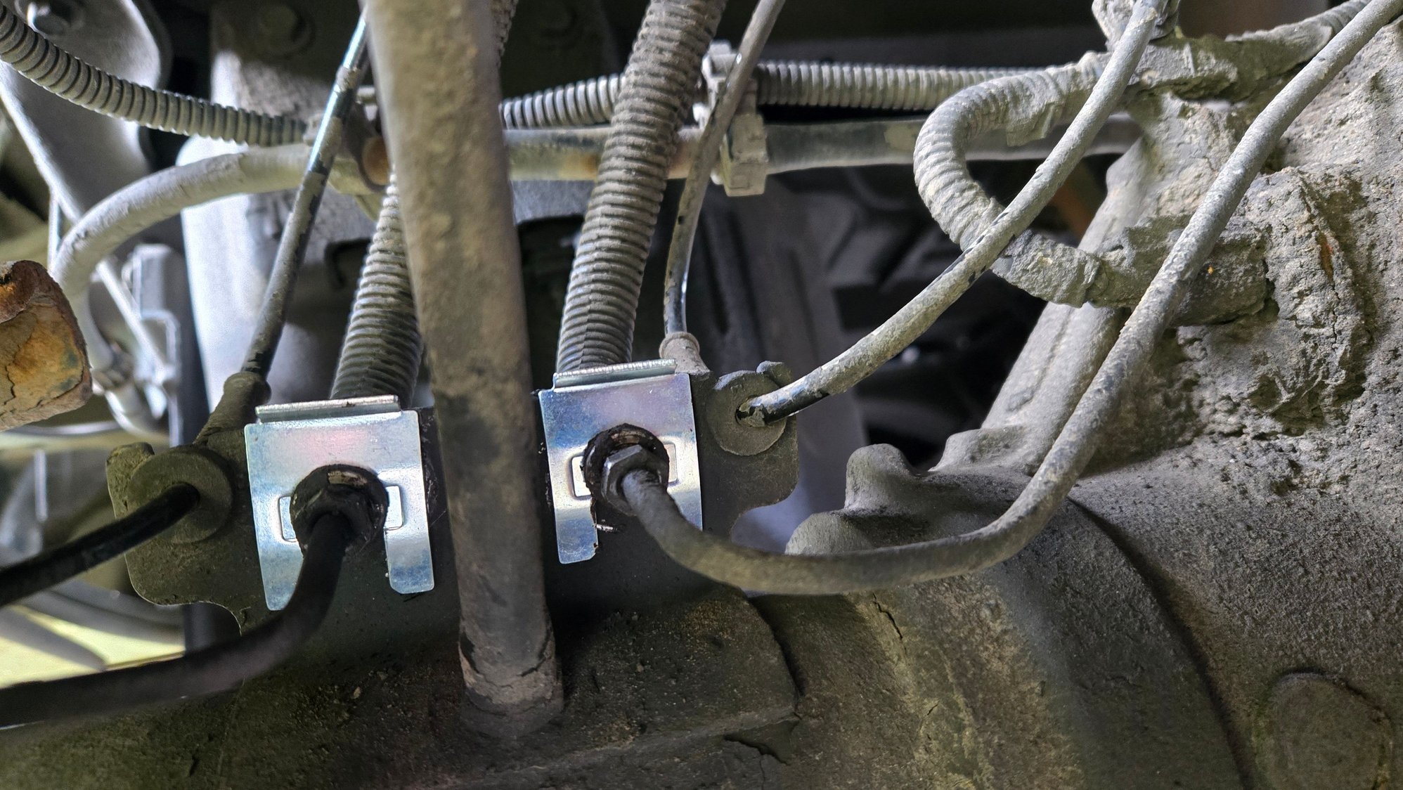

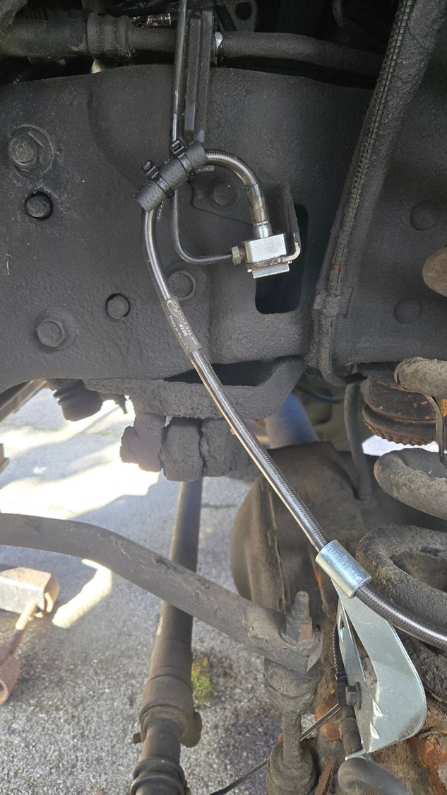

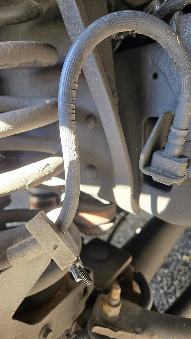

Did some spot rust proofing today, so crawled under the rear of the truck to take some pics of the brake lines.
Here's the caliper line, that's obviously longer and why they state you have to cut and re-flare the line to fit the longer the KLM line.
The factory caliper lines have the mount welded to the metal fitting of the line, so Dan the Ford tech, said not to use it because the mount has to be removed... then they said the upper lines were too short but it doesn't appear to be. I'll have to tape up the ends to protect the threads and keep dirt out of the lines but they look to be the same length as the OEMs.
The ends of the two upper lines.
The upper line fittings... looks like a joy to do with the fuel tank right there...
So apparently I will have to show the mechanics how a shade tree mechanic does it...
Plus I'll buy the hard lines in case i need them if the lines are too corroded...

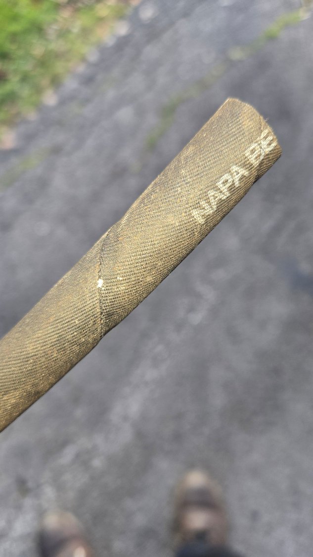

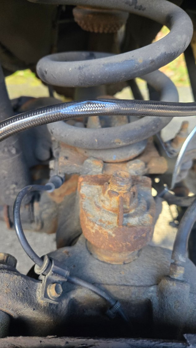

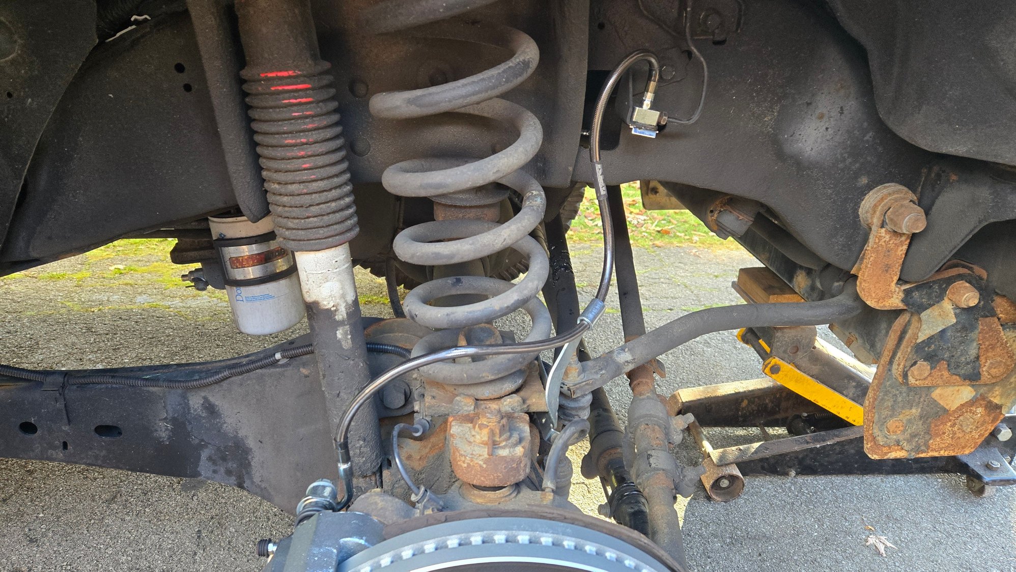

So I pulled my 20s with the Michelin Defender LTX M&Ss, which are shot, but I will drive with them again in spring before I get new meats, and installed my 18 inch factory steels with snows.
Here's a pic of the front KLM line.
I put that piece of old hose on there to protect the line as it was rubbing the factory bracket there.
But I found a surprise waiting for me when i went to the passenger side.
Closer up...
It must have been rubbing when i turned the wheel I believe...
Hit it with Carwell oil first...
Then gobbed it with Woolwax HV... thick grease like stuff... made some adjustments to the line bracket and used two cable ties to pull in the line towards the engine some by going off the bottom of the coil spring mount. Pics tomorrow...

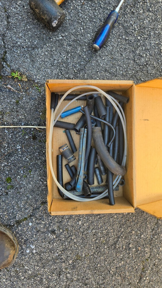

Sourced this left over piece of hose from this box used for just such a function...
In a Summit Racing cardboard box that I once received goodies in for my 96 at my old house...
The piece of hose in place, held together by cable ties and to keep the Woolwax HV inside there to keep rust at bay.
Also hit the top brake line connection and line bracket with Woolwax black spray... forgot to take pics but will tomorrow as i have to change my girl's oil...
See you then...

FWIW, I had an in-depth discussion with a brake line engineer at Gates Rubber, arranged through a friend that worked there. He said that stainless steel braiding had no effect on braking (which - for context - was the origination of that discussion) but could help some if there was abrasion (like you're seeing). But that's a LOT of abrasion and it should have been secured better by the installer or the vendor should have provided better strain relief.
Was the aftermarket line on the front longer than the OEM line?
Old Nov 7, 2024 | 01:22 PM
Overkill2's Avatar
Overkill2
Joined: Mar 2017
Posts: 31,969
Likes: 9,197
From: Western NY
Yeah my buddy's shop did the install and hasn't given me a price yet, always discounts his rates for me, but I bent the bracket in to bring line in towards the engine. Now that I am paranoid after it happened, I put cable ties around the line and pulled it in some more... the other side was good to go.
Now that I think about it, i ordered it one inch longer, just in case it happened to be just short... when you order them, they make them to your order, color and length... so I don't think the extra inch had anything to do with it.
Once I retire and have more time, I am going to install the rear lines myself and will let you know about pedal feel....
