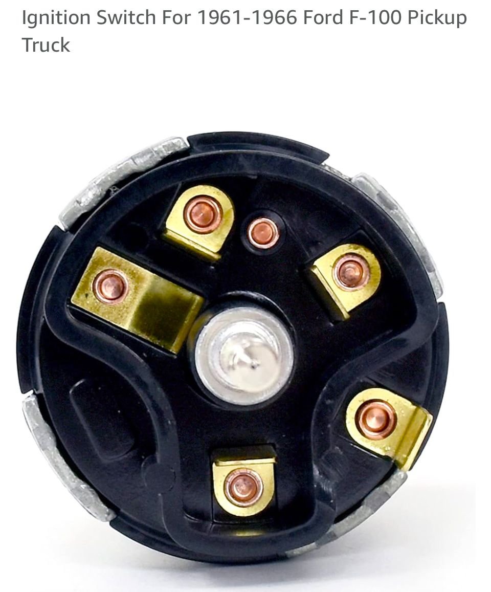

Ok so finally had some time to work on the truck. I found that both battery terminals were badly corroded and the cable going from the solenoid to a starter and the grounding strap. I replaced all of those. I replaced the ignition switch but the switch the parts store gave me had an extra terminal blade outside of the black plastic backing where the main wires plug in. The plug in the wiring harness fit fine and at this point I just wanted to see if it would work so I didn’t return it yet.

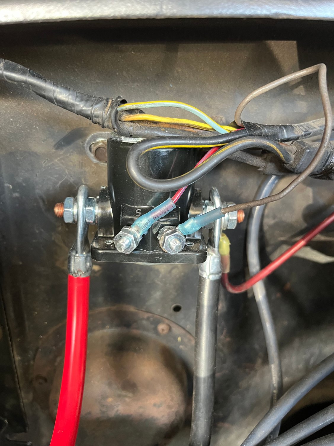

Picture for reference. Large black cable on the right is going to my starter.

What is the small red wire for that's connected on the starter cable post on the solenoid? I'm guessing that shouldn't be there. How does power get from the battery to the fuse block? I don't see anything on the battery side of the solenoid to feed anything.

If memory serves, that red wire that you have connected to the bolt on the solenoid should be on the battery side (red wire) instead of the black wire to the starter.

From what I’ve read and videos, I watched I believe the red wire is what goes to the ignition switch that provides power to the solenoid? Are you guys saying that I should swap the red and brown wires around?

No. not at this time at least. One of "those" wires is for the start position on your key switch and the other "should" be for providing a full 12V to the coil while cranking the engine over to make it start easier.
The red wire on the right with the yellow insulation "should" be on the left with the heavy red wire from the battery positive. If it is on the side that goes to the starter as in your picture, you'll get no power to the key switch.

The red/blue stripe and the brown wires are on correctly but as pointed out by others the red wire on the starter side of the relay shouldn't be there. If a 1964 is the same colors as a 65 then there should be a heavy black/yellow stripe wire connected to the Bat side of the start relay. Take a picture form at a little longer distance so we can see the cowl and all the wires.

@Crop Duster is correct that it should not be a red wire. But...maybe the correct one could have been replaced which is what I was thinking.
Before doing the wire side to side swap/ Trace the wire and tell/show us it where it goes.

I am in agreement with others that the red wire on the starter side of the solenoid needs to be moved to the battery side of the solenoid, assuming that is the wire feeding power to the fuse panel.
The blue arrow and the wire that connects to that goes back to
The blue arrow and the wire that connects to that goes back to "start" terminal on the starter switch and is only energized when you turn the key to start the engine. That actuates the high amp pass through on the solenoid to feed the starter for cranking
The red arrow pointing to the brown wire should send a full 12v to the positive side of the coil during cranking when key is is start position. It bypasses the resistor wire (ballast resistor) that feeds the coil reduced voltage when the key is in run position.
The green arrow should be the 12v feed to the fuse panel, from factory this would have been a fusable link for circuit protection and very well could have been replaced in the past and why the colors no longer match factory schematics.
