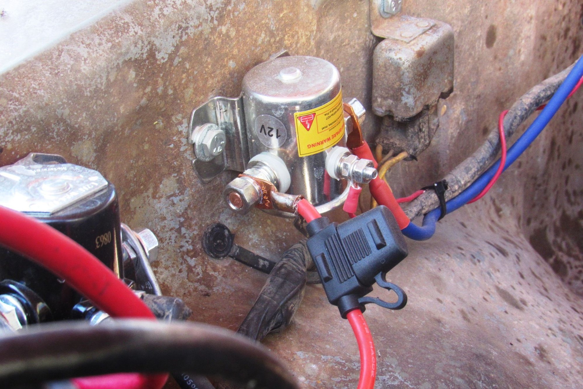

On my '72 I was going to install a CRS that was key on switched but then decided to just connect the 2 batteries together.
This if for battery power to my travel trailer on my 1976.

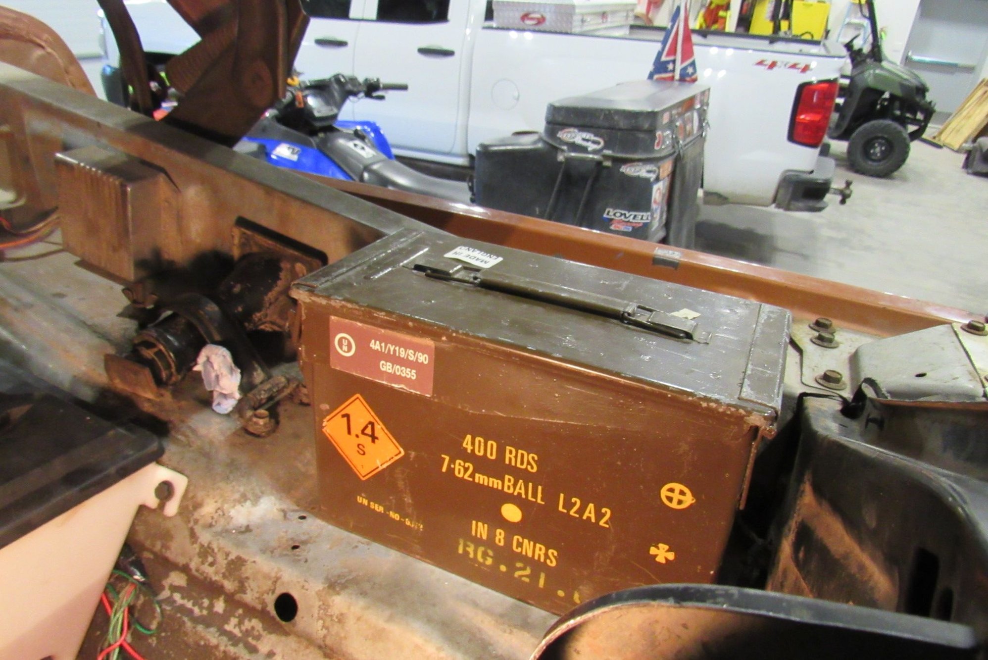

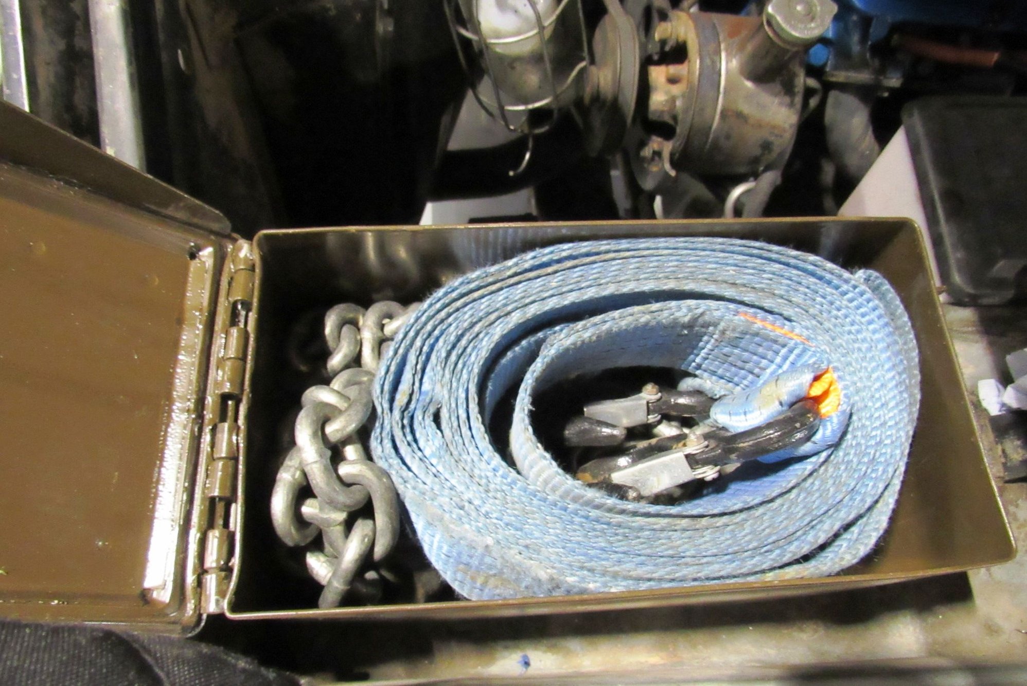

The original plan for my '76 was to add a second battery but when I couldn't find the right battery tray for the drivers side I opted to add an ammo can to carry a tow chain and a recovery strap.
